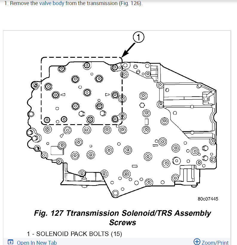

Is it possible to get diagrams to replace shift solenoid e?
Jun 1, 2024 at 4:41 AM
  • 55,402 POSTS

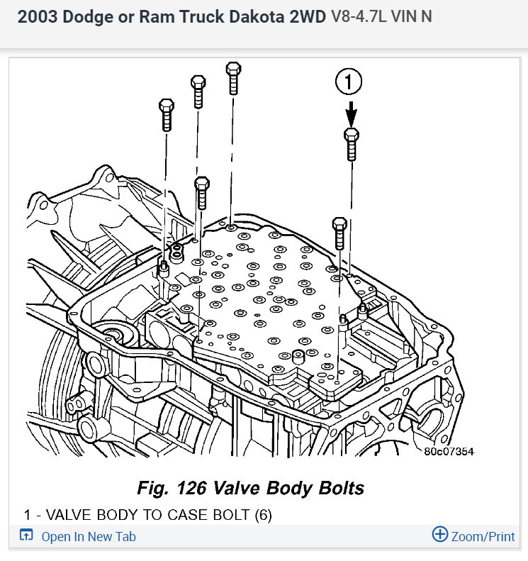

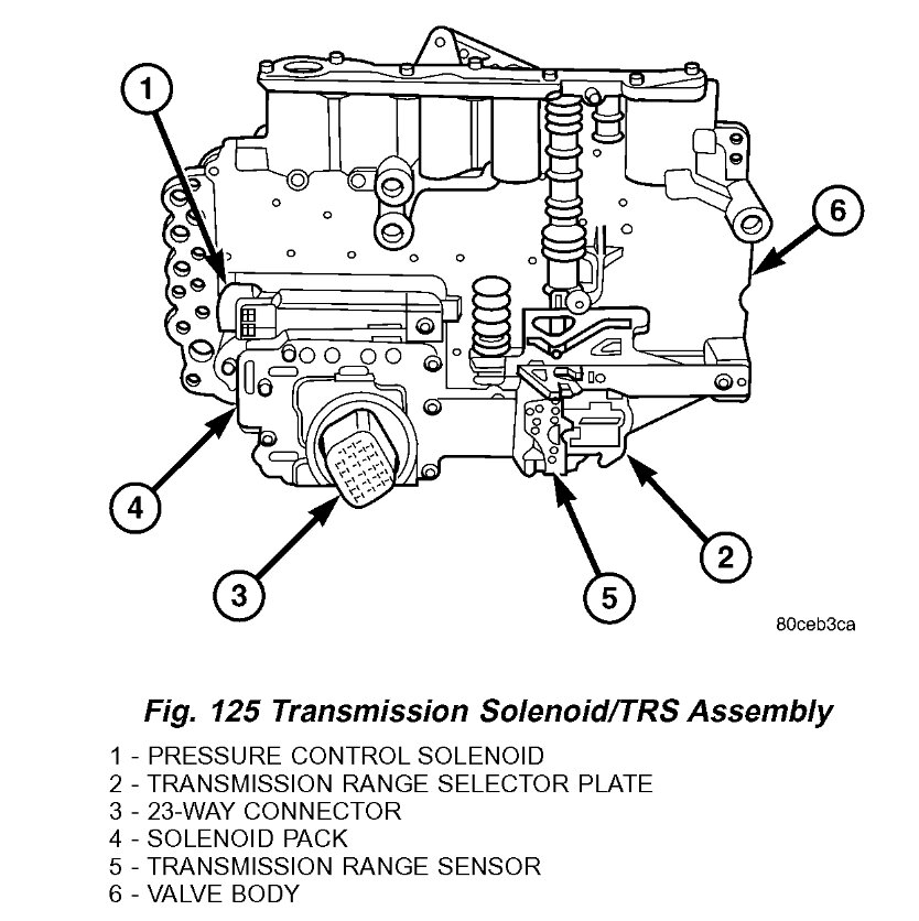

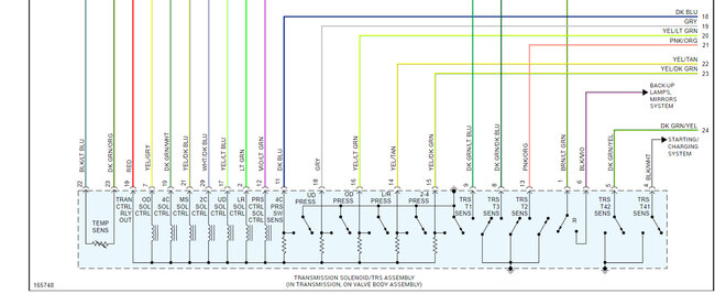

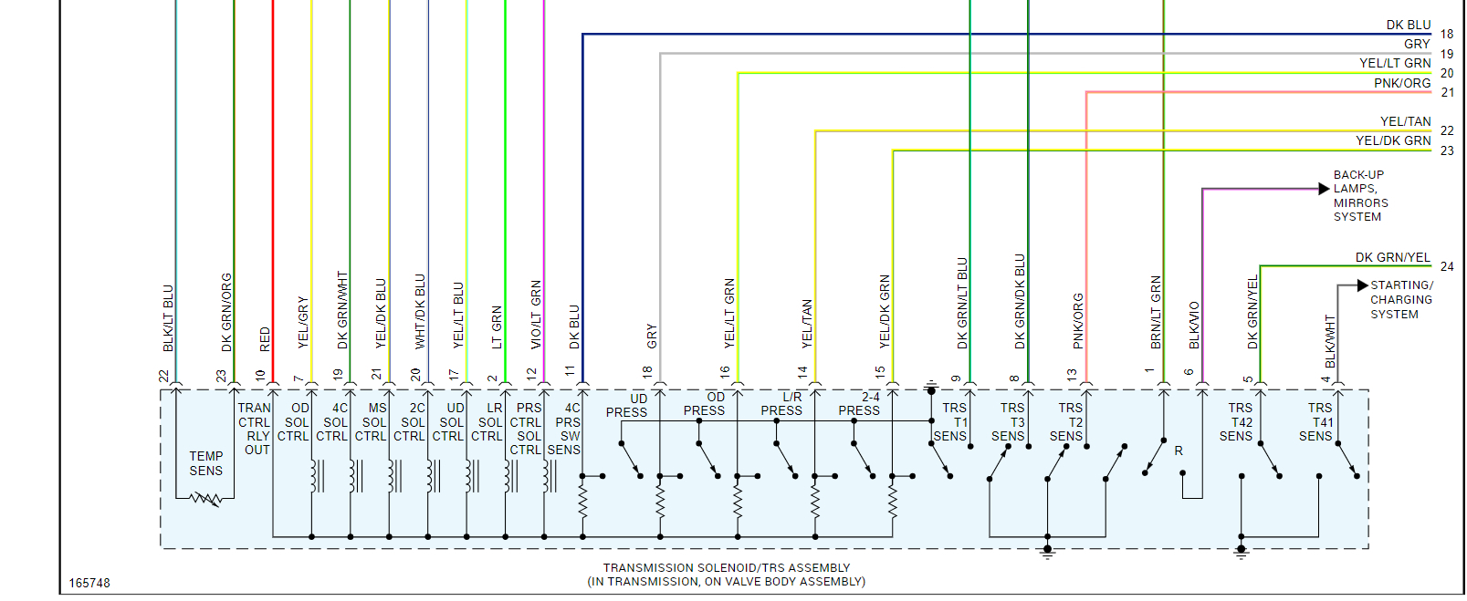

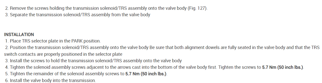

The P0770 code indicates a problem with the shift solenoid E in the transmission of your 2003 Dodge Dakota. Though they do not say which one is solenoid "E" in the shop we replaced the transmission solenoid assembly which included all of them. Here are the wiring diagrams so you can see what I am talking about and how to change the transmission solenoid assembly to fix the problem. Check out the images (below). Let us know how it goes.
