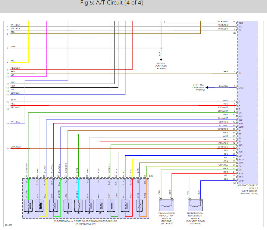

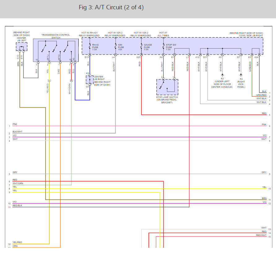

Hi. my car does not shift beyond gear three. I got a P0761 error code shifting solenoid c or stuck off, upon scanning it, with about 150 miles on it. I have replaced the transmission fluid and gear filter, also tested the solenoid and I got the 'click' sound to verify its in good order. It is still is not shifting past third gear. I need urgent help. Please reply.
Thanks
Nov 26, 2016 at 9:09 AM
  • 55,743 POSTS

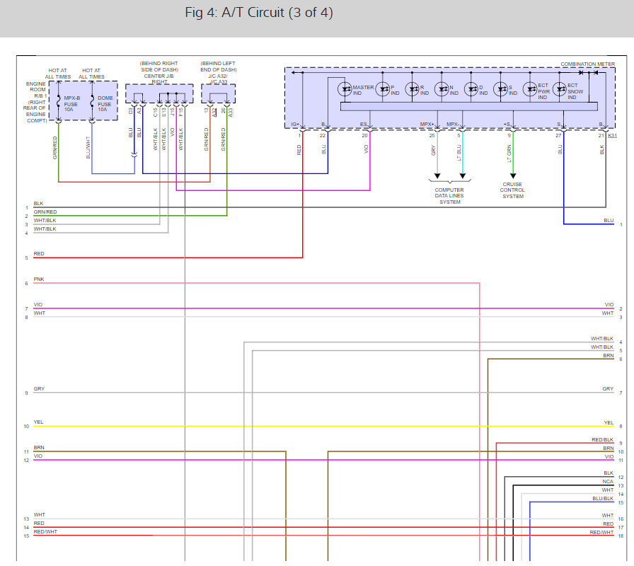

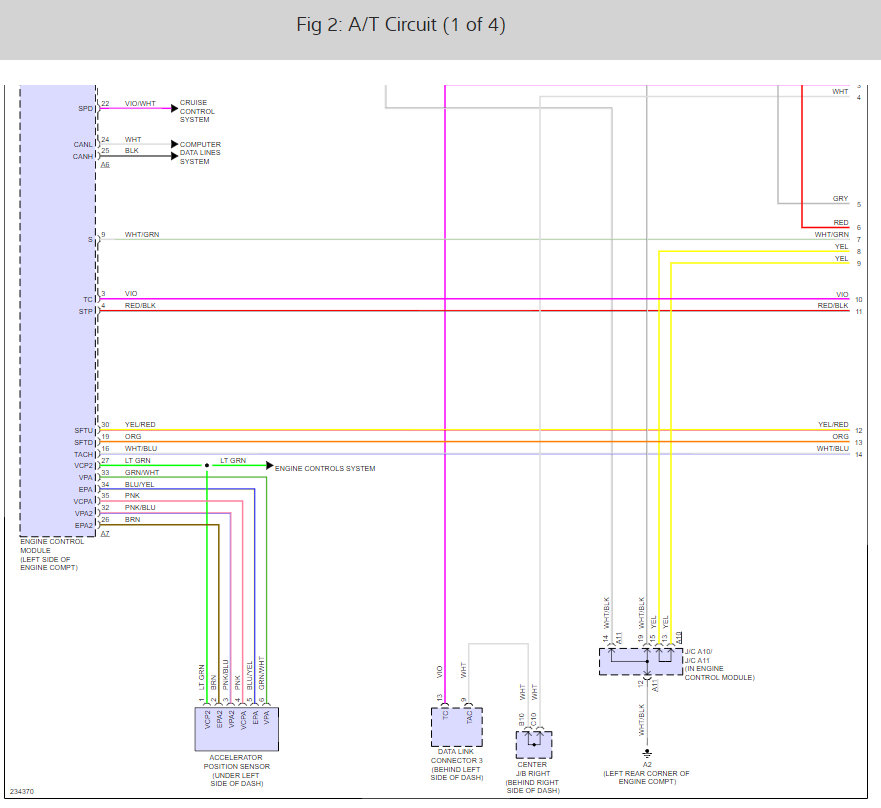

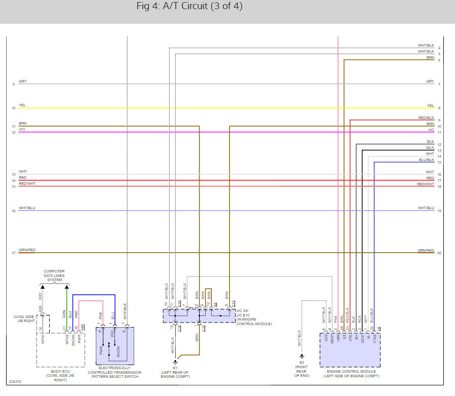

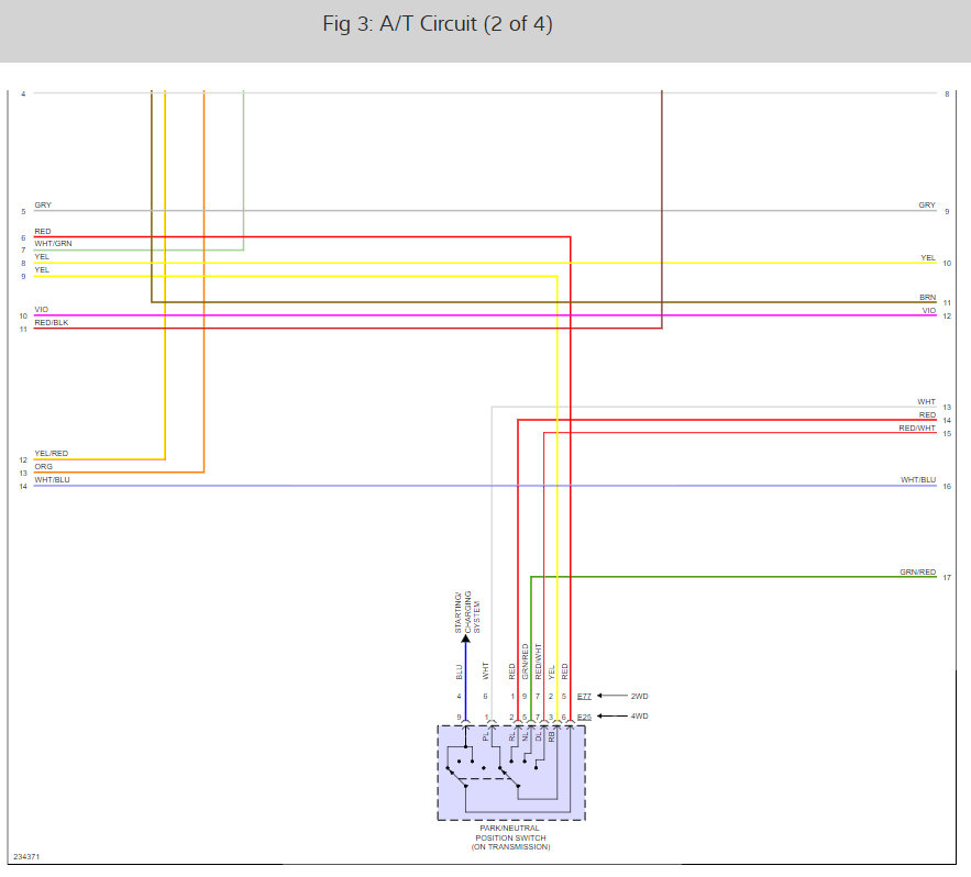

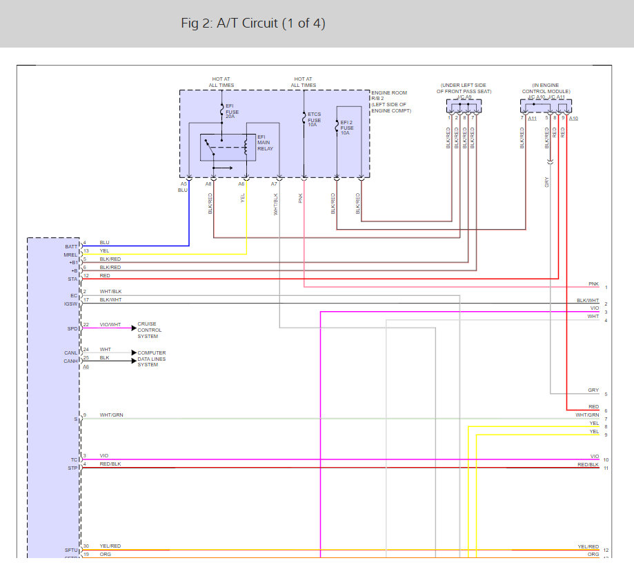

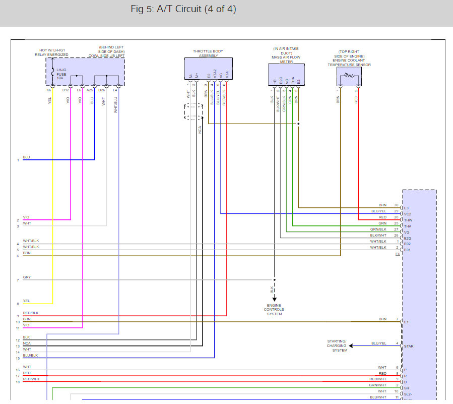

This sounds like an internal transmission problem or you have a bad connection at the transmission harness. Here is a guide to help you see what you are in for when checking the wiring.
Please run this test and get back to us.
Nov 27, 2016 at 4:40 AM
TOYINFOLARIN1
  • 5 POSTS
I found the problem it was a broken wiring outside the harness at the main connector its like it got damaged from something off of the road. All fixed now
