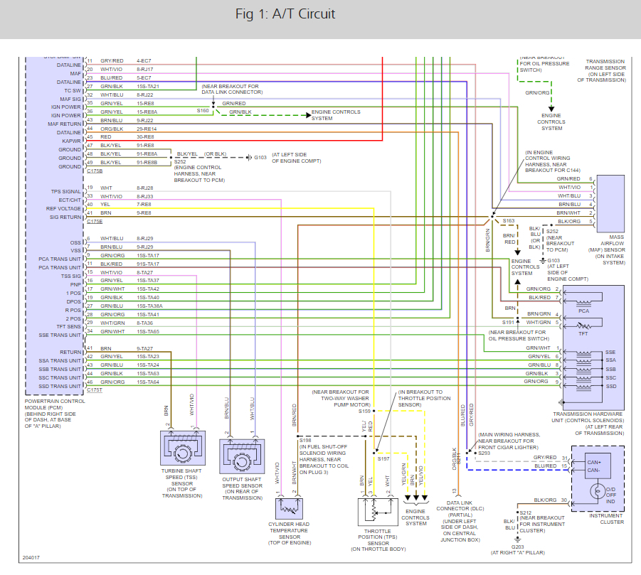

Code P0751 shifts hard and transmission gets hot
39,000 MILES • 2.0L • 4 CYL • 2WD • AUTOMATIC
LILHALLS6
I replaced solenoid A and B with no luck. The fluid is full and I checked the grounds. Any ideas what this could be?
Jun 14, 2018 at 4:38 AM
  • 55,845 POSTS
We need to check the wiring connection for the solenoid to the PCM. Here is a guide and the wiring diagrams so you can run some tests. Also, check the power and grounds.
Check out the diagrams (below). Please run this test and get back to us.
