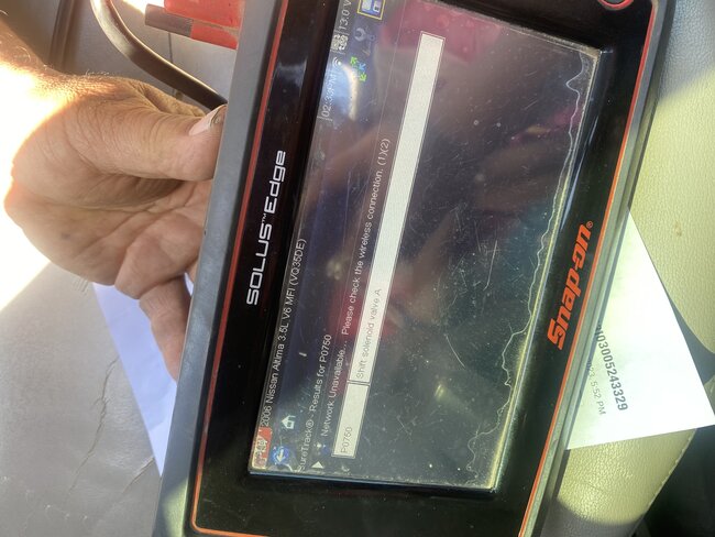

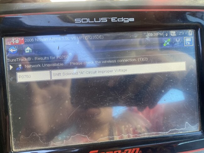

SOPHIAJ26
  • 7 POSTS
Also, here is what the scanner says, would the valve body still need to be replaced? Or just a solenoid?
Apr 25, 2023 at 3:04 AM
  • 55,837 POSTS
For a new valve body, it is:
Valve Body 317058Y001 $1277.70
But you can get a rebuilt unit for less by searching google or eBay.
Valve Body 2.4 hours @ the shop rate.
Apr 26, 2023 at 2:22 AM
