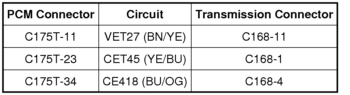

getting code p0748 and p0960. Car jerks when putting gear in D and gears stick sometimes. any help will be appreciated.
Dec 14, 2020 at 9:37 AM
  • 110,194 POSTS

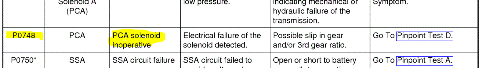

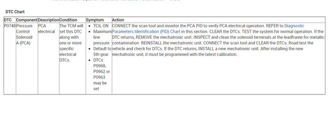

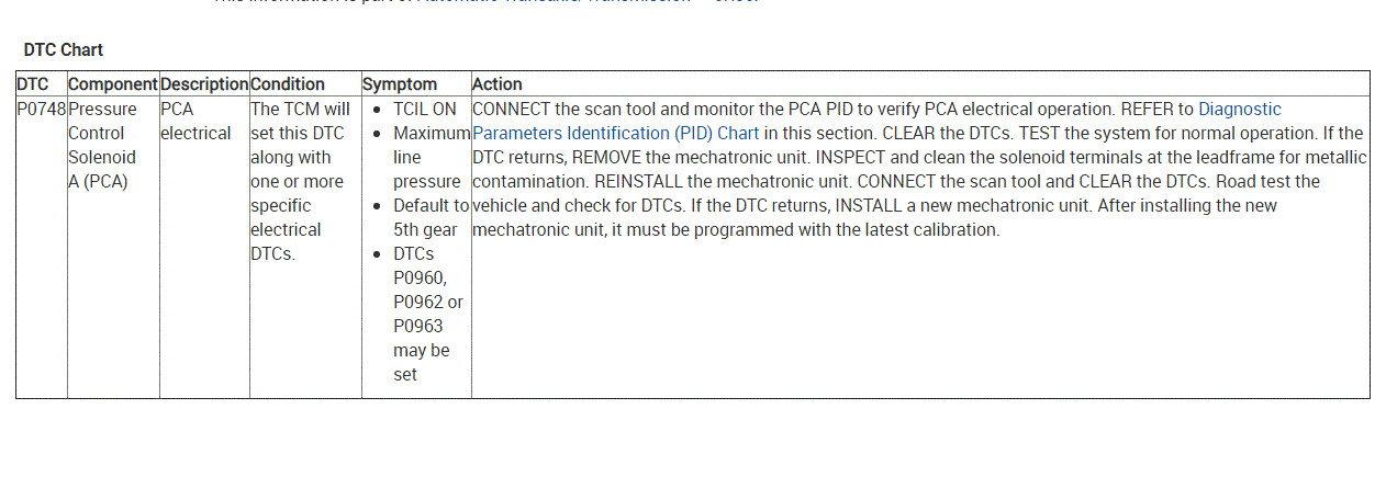

The code, 748, deals with transmission line pressure being too high. If you look at pic 1, it explains the code. Now, the 960 is likely the result of the 748. What needs to be done is the mechatronic in the transmission needs to be checked.

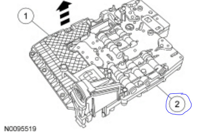

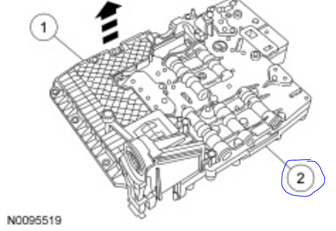

If you noticed the directions for diagnosing are in pic 1. If you find the mechatronic assembly does need to be replaced, it is located inside the transmission. See pic 2. I circled number 2 in the pic. That is the part I'm referring to.
Let me know if that is what you find.

The vehicle listed above has a 5r55s transmission. i think there is no mechatronic assembly in this one.

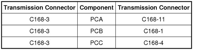

This must be an early model. That transmission isn't listed under 2010. I went back a year and found it. If you look at pic 1, it shows where the issue is coming from. It is related to an inoperative solenoid.
Here are the diagnostics. The attached pics correlate with the directions.

D3 CHECK FOR BATTERY VOLTAGE
- Ignition OFF.
- Disconnect: Transmission Vehicle Harness C168.
- Visually inspect the transmission harness C168 is fully seated, terminals are fully engaged in the connector and are in good condition before proceeding.
- Ignition ON.

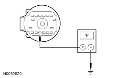

- Measure the voltage between C168-3, circuit CBB38 (GY/BU), harness side and ground.
pic 2
- Is the voltage greater than 10 volts?
GO to D4.
REPAIR circuit CBB38 (GY/BU). CLEAR the DTCs. TEST the system for normal operation.

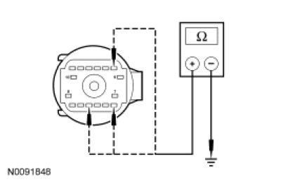

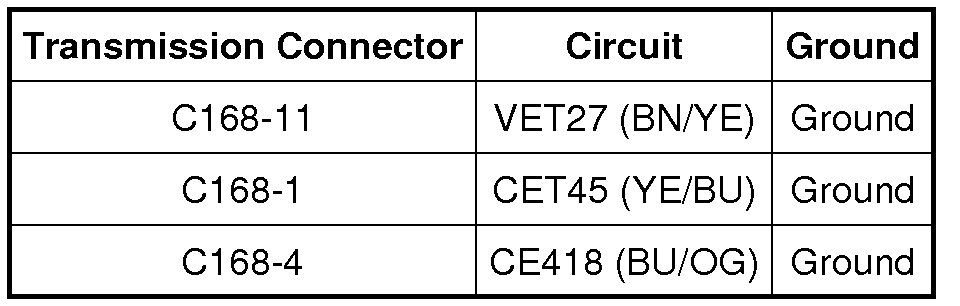

D4 CHECK CONTROL CIRCUITS FOR AN OPEN
- Ignition OFF.
- Disconnect: PCM C175T.

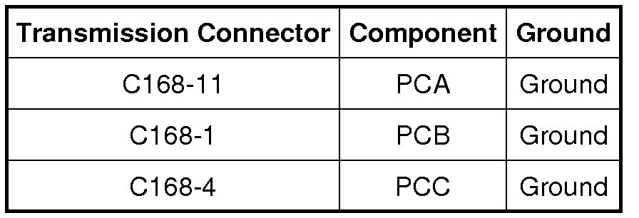

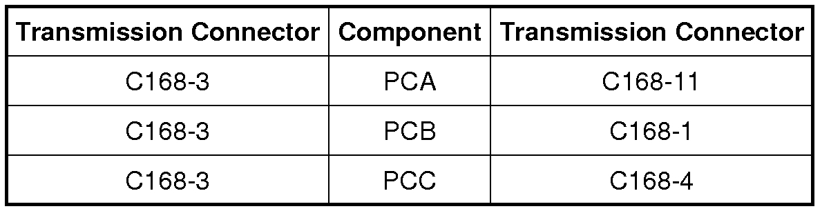

- Measure the resistance between PCM C175T and transmission vehicle harness C168, harness side using the following chart.
pic 3
pic 4
- Is resistance less than 5 ohms?
GO to D5.
CHECK the transmission vehicle harness circuit which has high resistance for an open. CLEAR the DTCs. TEST the system for normal operation.

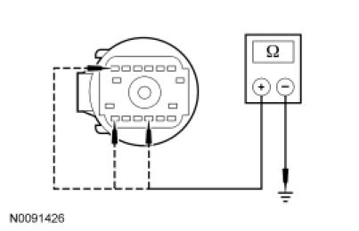

D5 CHECK CONTROL CIRCUITS FOR A SHORT TO GROUND

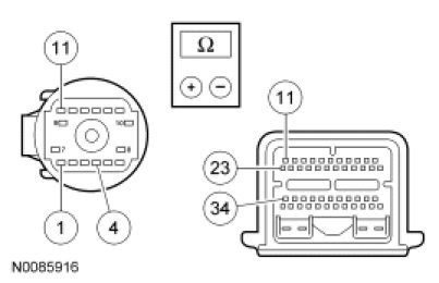

- Measure the resistance between the transmission vehicle harness C168 and ground using the following chart.
pic 5
pic 6
- Is the resistance greater than 10,000 ohms?
GO to D6.
REPAIR the vehicle transmission harness circuit shorted to ground. CLEAR the DTCs. TEST the system for normal operation.
