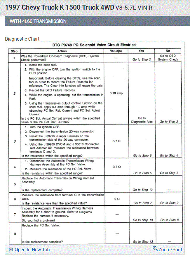

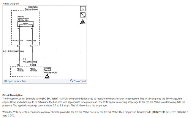

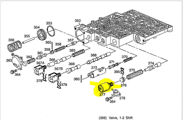

The code is related to the pressure control solenoid. This is what maintains the fluid pressure in the transmission. If the transmission was used, the solenoid may be bad. Did you have the transmission pan removed? The PCS is located on the valve body. If you look at pic 1 below, I highlighted it.
Are you experiencing a hard or soft shift?

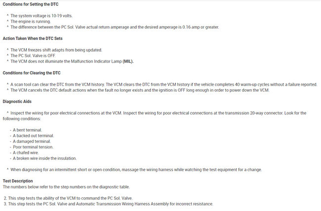

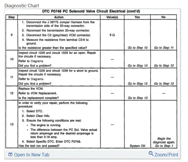

The remaining attachments are the diagnostics related to this code. Take a look through them and let me know if you are comfortable performing them.
See pics below
