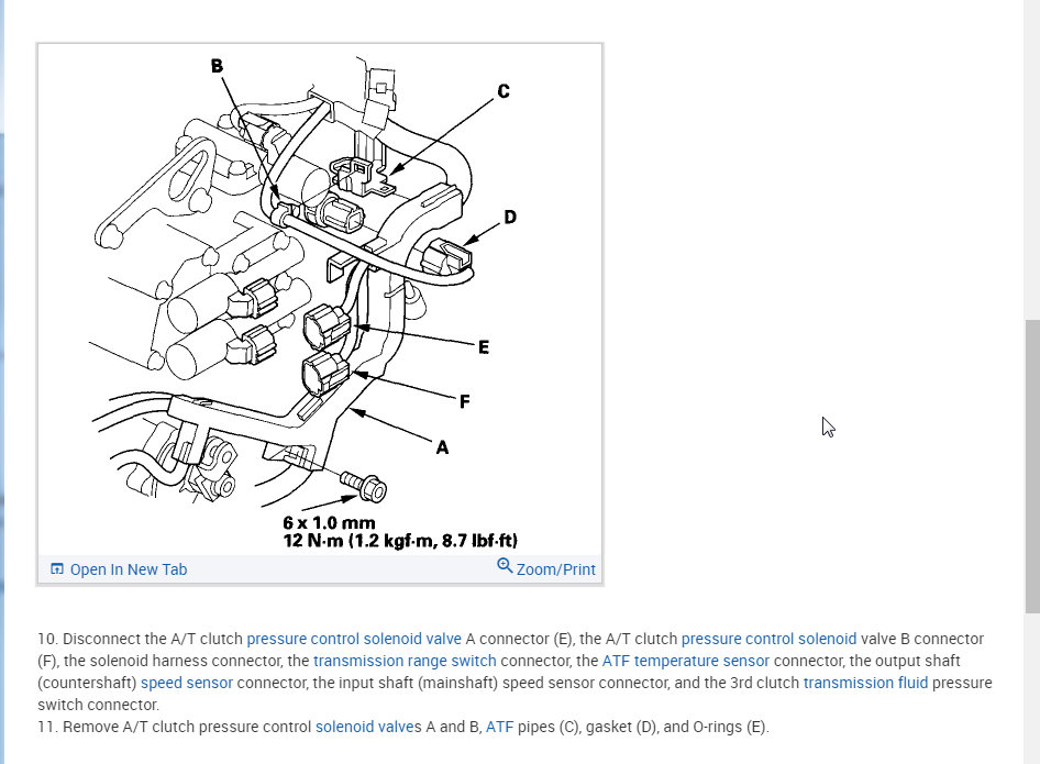

Changed mounts on it went for a test drive felt a jerk. after it changed above 3,000 rpm the it locked into safe mode, never did that before, which one of these on the transmission is it?
Aug 19, 2020 at 5:13 AM

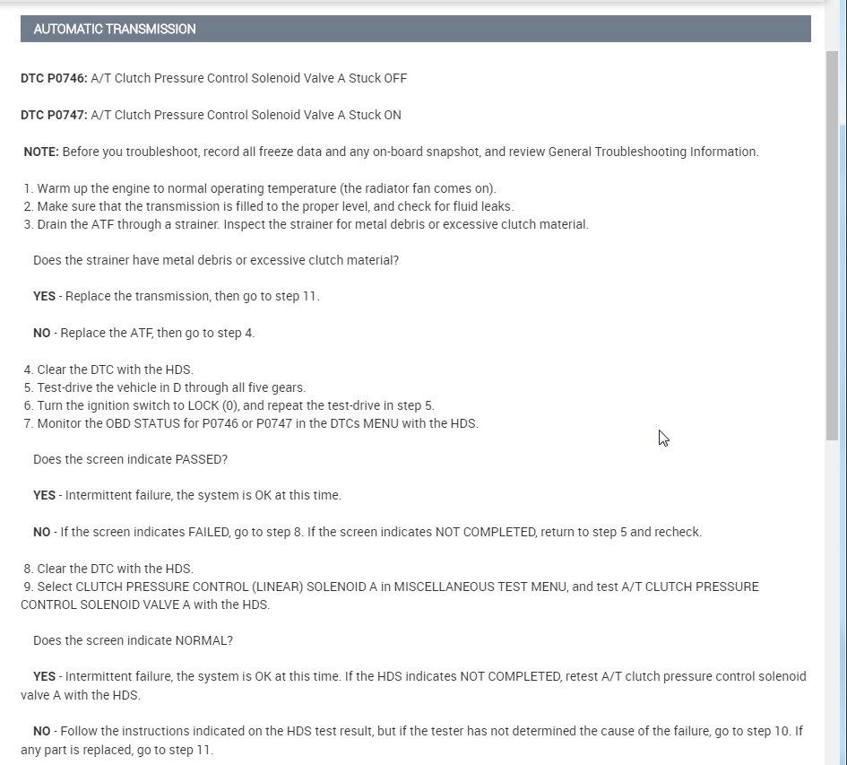

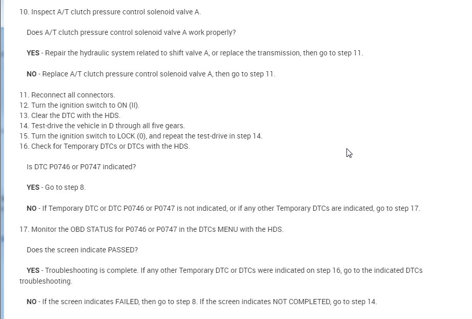

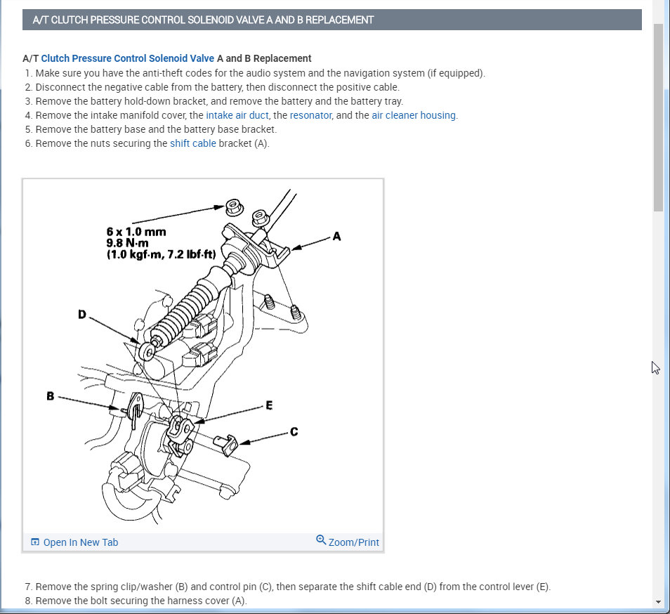

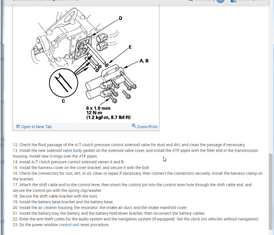

This code is for the clutch pressure control solenoid A. I attached the testing for this one.
Let's run through the testing but I also attached the replacement for it if that proves out to be the issue.
Let us know what you find. Thanks
Aug 19, 2020 at 5:36 AM
NASER NASER
  • 836 POSTS
Turned out the solenoid on top was bent as well as the connector. so i installed another one from an MDX and all good thanks! I guess stress from jacking up motor and transmission while replacing mounts may have pulled harness.
