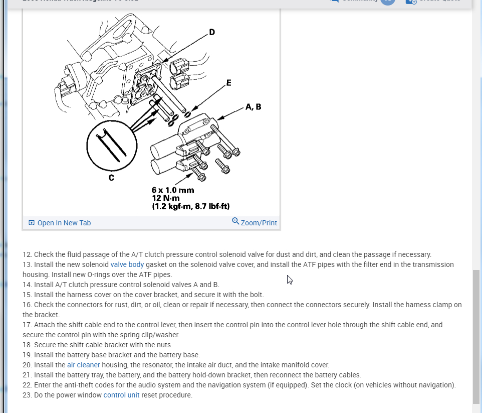

Changed mounts on it went for a test drive felt a jerk. after it changed above 3,000 rpm the it locked into safe mode, never did that before, which one of these on the transmission is it?
Aug 19, 2020 at 12:13 PM

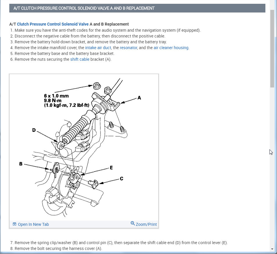

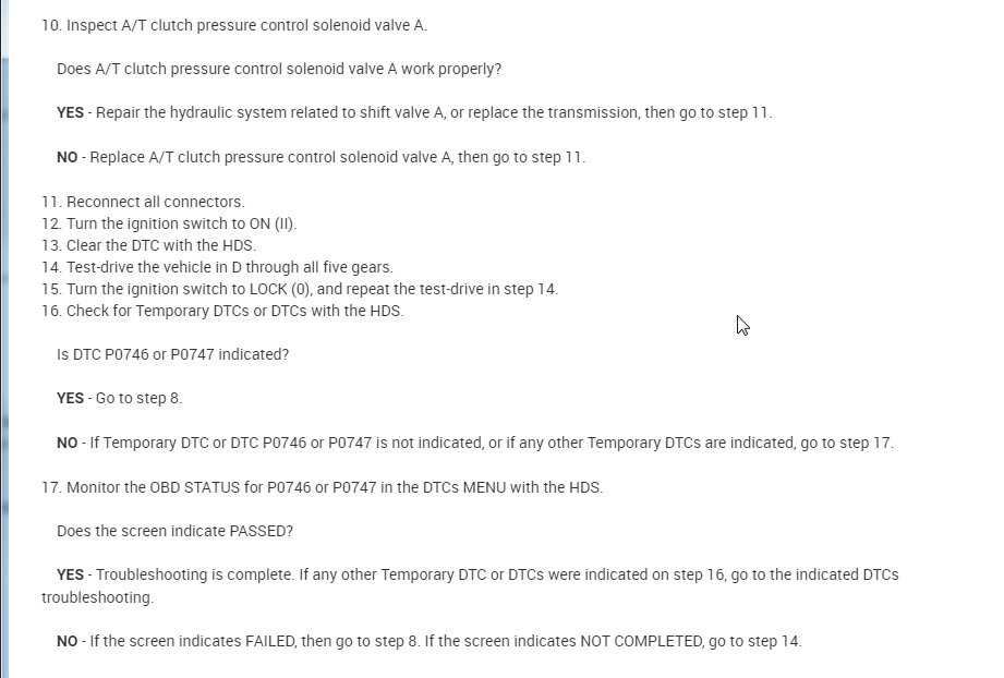

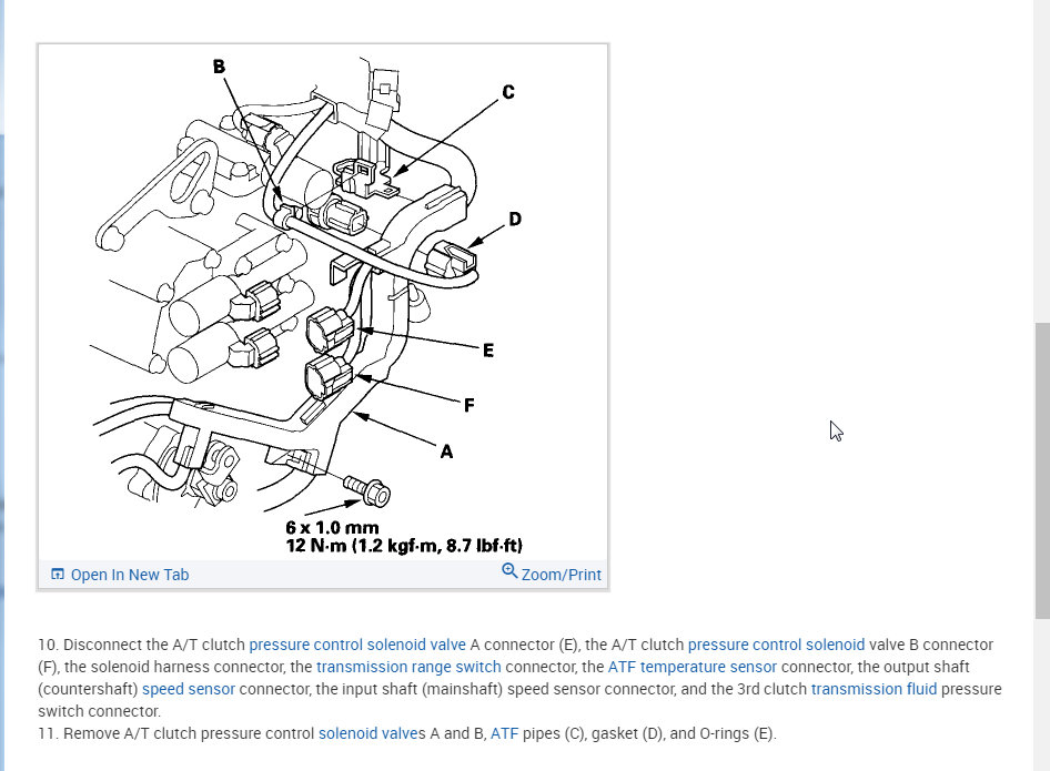

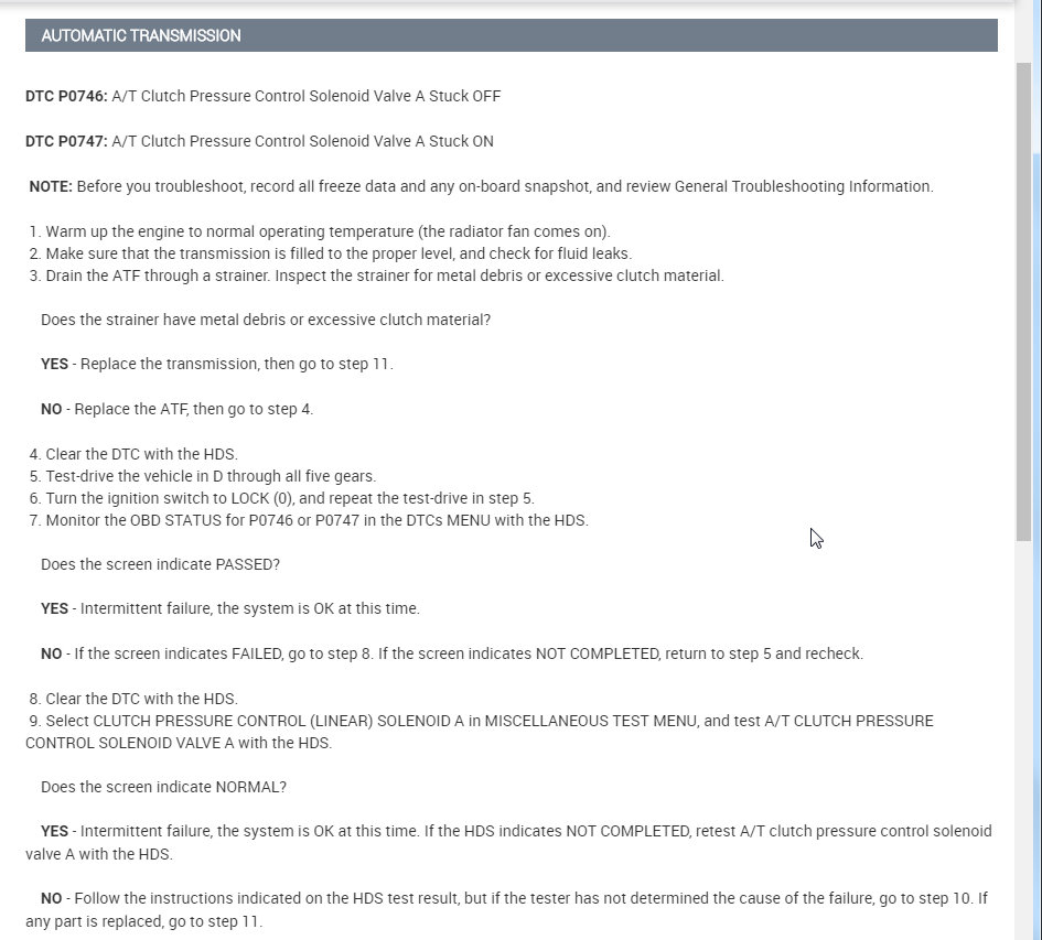

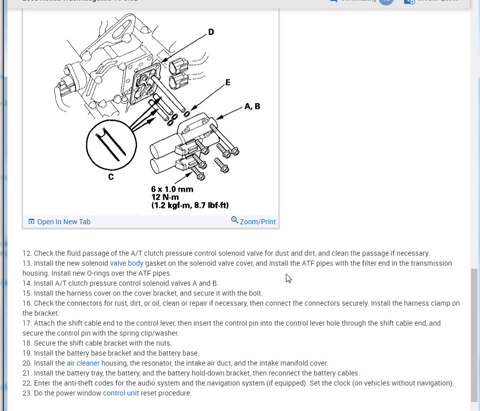

This code is for the clutch pressure control solenoid A. I attached the testing for this one.
Let's run through the testing but I also attached the replacement for it if that proves out to be the issue.
Let us know what you find. Thanks
Aug 19, 2020 at 12:36 PM
NASER NASER
  • 836 POSTS
Turned out the solenoid on top was bent as well as the connector. so i installed another one from an MDX and all good thanks! I guess stress from jacking up motor and transmission while replacing mounts may have pulled harness.
Aug 19, 2020 at 1:41 PM
I was thinking it could have been related but had not done mounts on this vehicle so I wasn't sure and didn't want to point you in the wrong direction.
Glad you found it. Talk to you next time. Thanks
