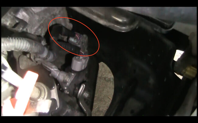

I hope all is well with you and your family. So I have a 2004 Matrix XR which I purchase about 2 years ago. The mileage then was around 125,000 miles. The previous owner kept the engine bay very dirty so I pressure washed the entire engine thoroughly. I started the matrix and drove it around for five minutes or under a mile and did not notice any check engine lights. The next day I drove to work which is 80 miles one way and as I pulled in to the driveway @ work the check engine light came on. I connected the car to a code scanner and it revealed "P0741 Torque converter clutch solenoid circuit performance or stuck off". I did some research and a few people said to replace the transmission oil ... so I did so three times and that did not fix the issue. I then went back and did more research and came across this video where a owner of a 07 Corolla had a similar situation. I will past the url to his YouTube video in which hd gives a decent idea on he resolved his p0741 error. Seeing as how both situations are similar I would like to try his remedy but am unable to separate the transmission wire under the battery and I would like your guidance on how to separate the connections. The author of the video was unable to separate the wires and he had to use a longer method to clean the wires. If you could please take a look at the video where he identifies the wire / connector or take a look at the attached picture. Please let me know if there is a fee for your service?

Hello Tony, I hope all is well with you and yours as well. Those electrical connectors have a safety that needs to be depressed before the connector and be removed for inspection. You probably have moisture inside the connector which will cause the code. If not I would replace the TCC solenoid. It should be the solenoid with the brown/white-blue wire. Clear the codes once completed. Please let me know what happens.

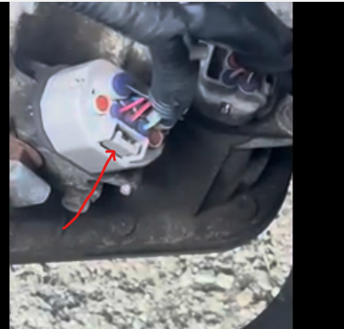

I appreciate your quick response. Thank you. By any chance is they're a diagram showing where the safety clip is located? I tried to unplug but had no luck.

It is on the outside of the clip, Can you get a closer image of the connector and I can walk you through it.

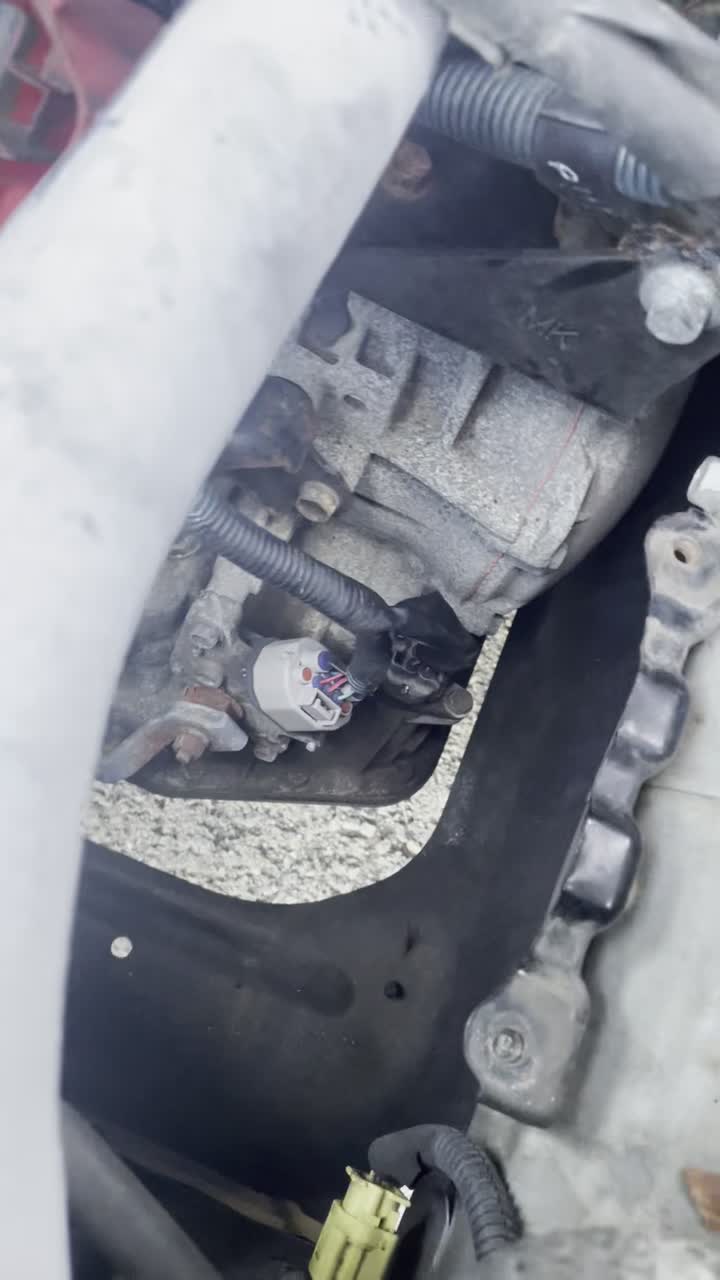

TONY RAHAT
  • 6 POSTS
Good evening,
Please pardon the late reply. Was out of town for a few days. I took a video of the connector as best as I could. It's the connector that I placed my hand on for most of the video. I admit I've never seen a connector like that. I am very appreciative of your help. Sorry I could not get a better zoom in video of the connector.

No worries, Thanks for the video, so the tab must be pushed inward to remove. You might want to press down while releasing the tab and then pull upward. Check out the images (below). Please let me know what happens.

Success! I was able to disconnect both cables from the transmission. I really appreciate your help.
