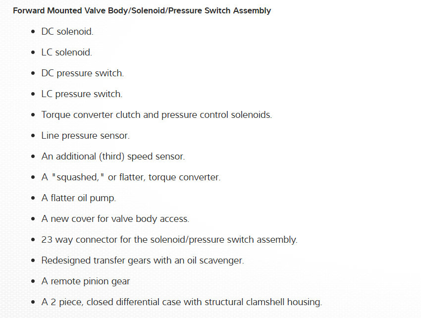

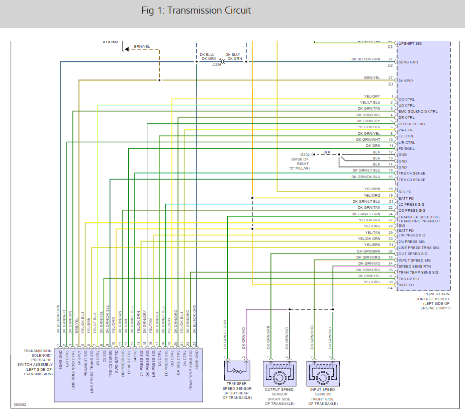

I have the vehicle listed above it is a Routan. P0740 TCC out of range.
Car has no issues and no symptoms yet. But when i cleared the code it takes a few miles and two to three cycles for check engine light to come on. What could be causing the problem?
Feb 22, 2018 at 6:13 AM
  • 55,433 POSTS

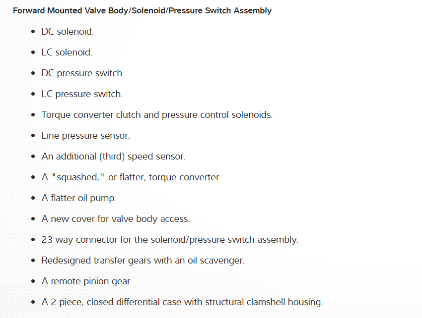

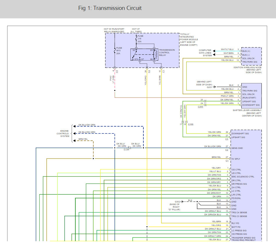

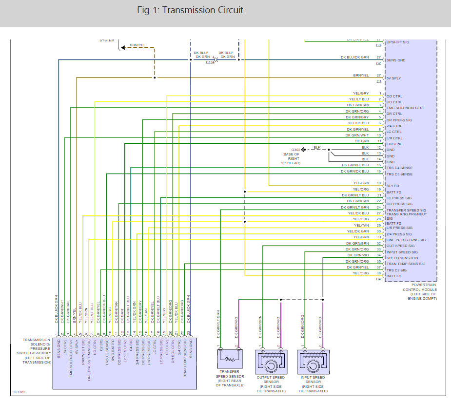

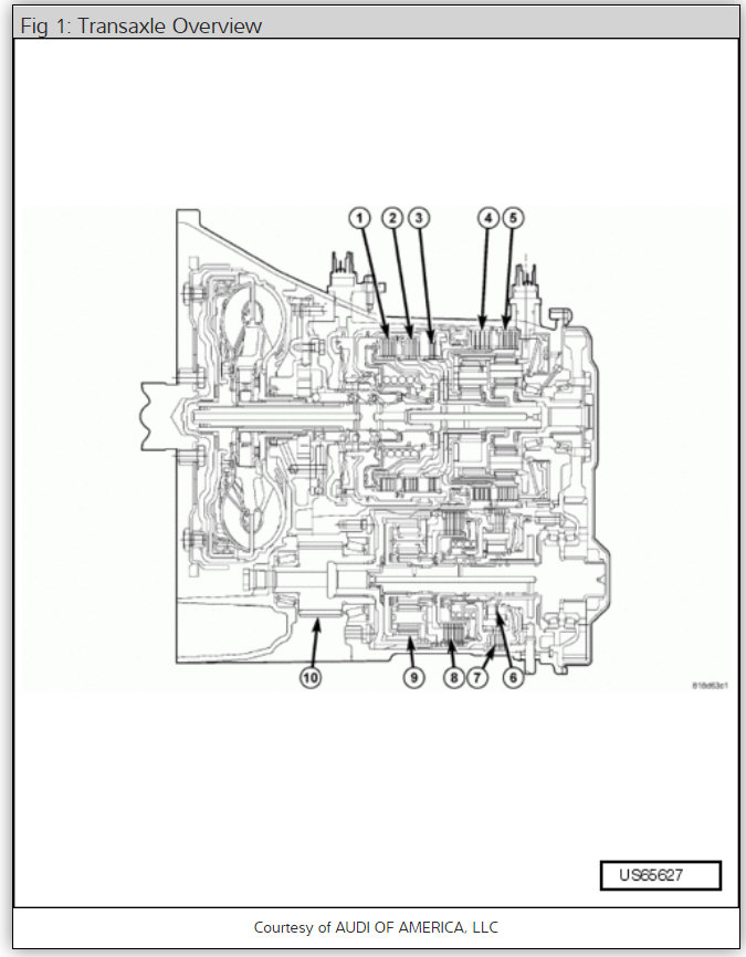

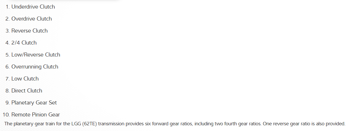

It sounds like you have torque converter control solenoid that needs replacement. Here is a guide to help you see what you are in for when removing the pan:
