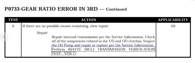

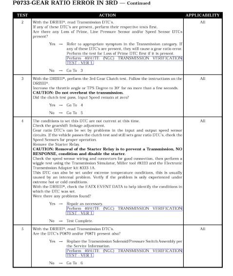

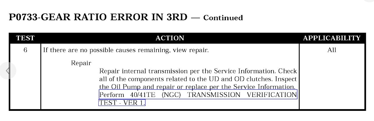

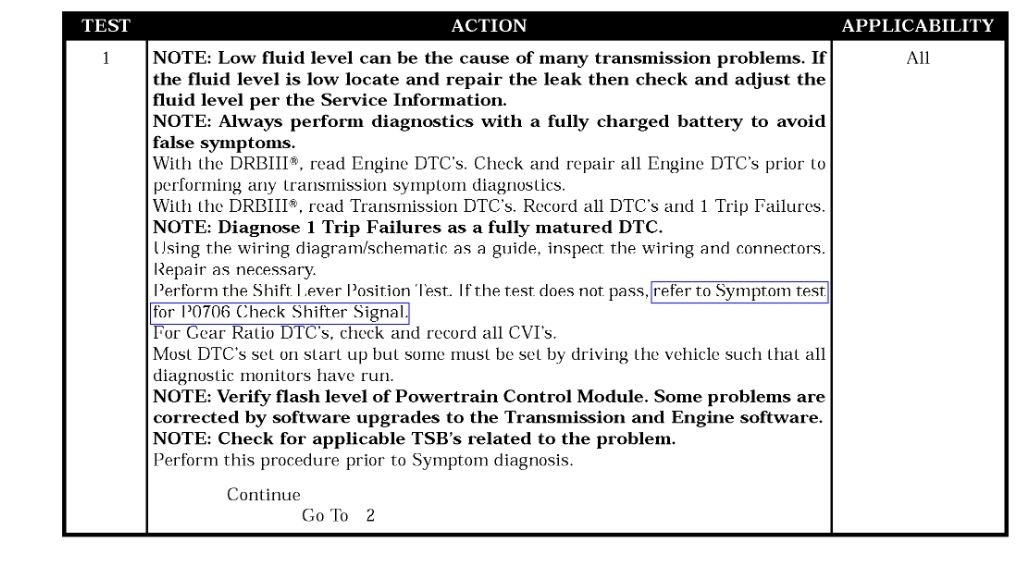

You would need an advanced scan tool to read live data from the transmission as you drive it and watch the voltage signals being sent to the solenoids.
Did you follow the flow chart I attached?
