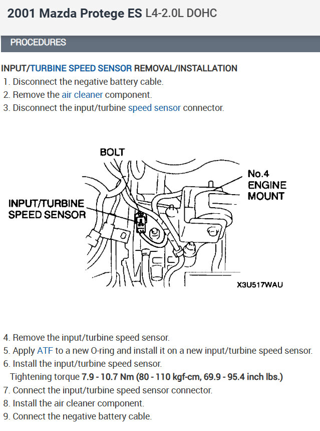

I had p0733 code on my vehicle listed above. I replaced all the solenoids in the valve body. Fresh transmission fluid and filter. Transmission fluid was always clean, not burnt/dirty. When starting up the car in the morning, when I put the car into drive, I hear a faint buzzing sound, and the transmission takes a minute or so to engage. When it engages, it shutters/jerks hard and OD/light flashes. It does this as I pull off and come to stops. It disengages as well and I have to put it into second or first gear to try and get it to engage in drive, so I can pull off from a stop. Others gears fine; it's just the jerking 1st gear. Any advice or suggestions? I was unable to get code from OD light after I cleared it but od light still flashes when car jerks to first. This problem just started within the last week. I have only driven it about 3-5 miles since it started.

This codes comes into play when the turbine shaft speed sensor is going out, here is the location so you can change it out and then clear the codes.
P0733 - Gear 3 Incorrect Ratio
Check out the images (below). Let us know what you find.

Do I have to disconnect the battery, so the PCM can relearn the new ISS sensor?
Apr 28, 2025 at 11:42 AM
  • 54,832 POSTS
Yes, it is a good idea to disconnect the battery, there should be no relearn for that sensor.
