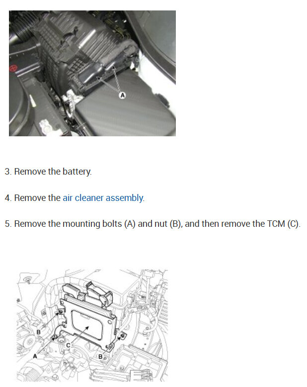

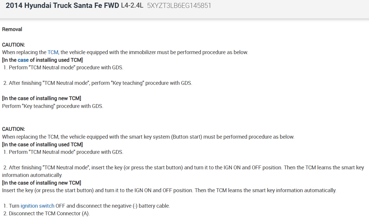

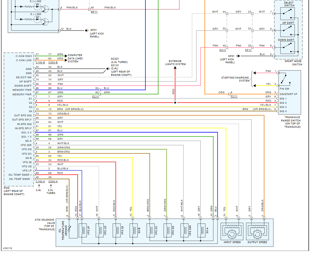

Code P0732, second gear incorrect ratio, where is the transmission module located?
2014 HYUNDAI SANTA FE
149,130 MILES • 2.4L • 4 CYL • 2WD • AUTOMATIC
ANDRIN ATEM
  • 406 POSTS

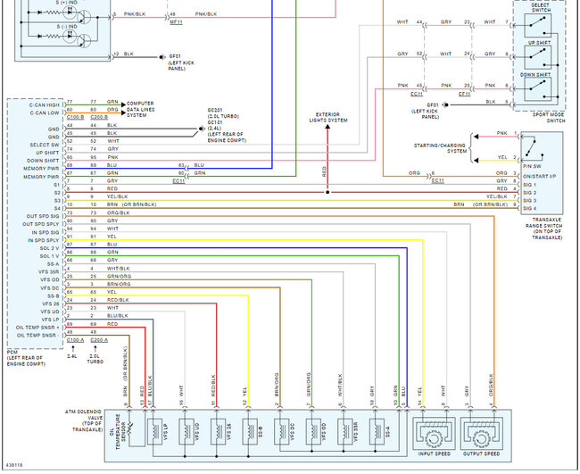

Please can you kindly provide me with the exact location of the transmission module and the wiring for a diagram containing ground signal.
Any information that can be helpful to solve this problem. Hi Ken, please I noticed I would just need the diagram and signals of this solenoid valve connector.
5XYZT3LB6EG145851
Dec 29, 2024 at 1:48 PM
  • 54,832 POSTS

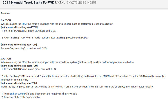

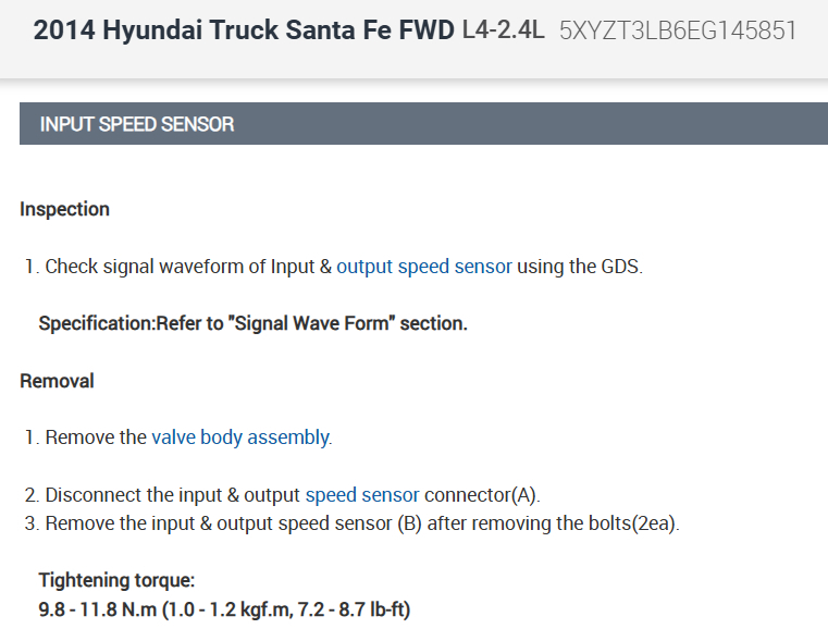

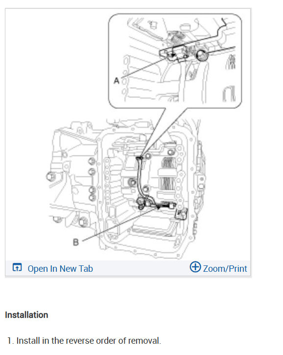

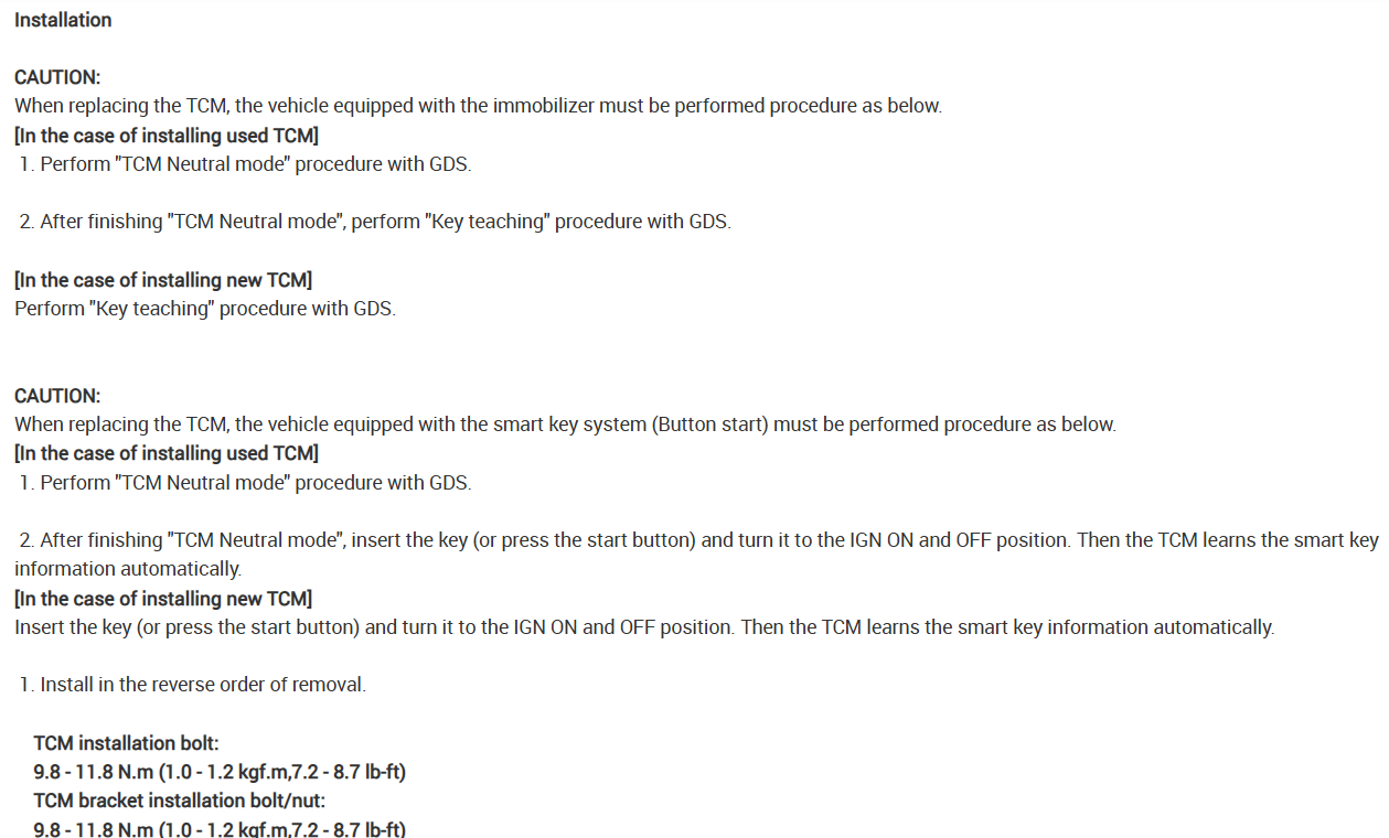

Hi Andrin,
Here is the location for the transmission control module and the wiring diagrams for it, but I can tell you I have seen a weak input shaft sensor cause this problem as well. Here is the location for the sensor as well. Clear the codes once the sensor or TCM is replaced. Check out the images (below). Please let us know what happens.

Thank you, Ken, i have read the updates and the diagrams. May i have measurements for testing the out speed sensor and input sensors? Also, if possible, to have the pinout of for the solenoid valve connector Pinout signals?
Dec 30, 2024 at 6:47 PM
  • 54,832 POSTS
This is what they say:
For most Hyundai models, the resistance of both sensors should be within the range of 500 to 1,000 ohms.
This sounds too high to me btw. Which solenoid valve are you talking about?

Transmission Output speed sensor and the input speed sensor, which is behind the valve body inside the gearbox.

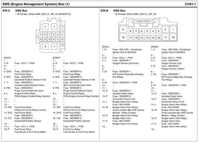

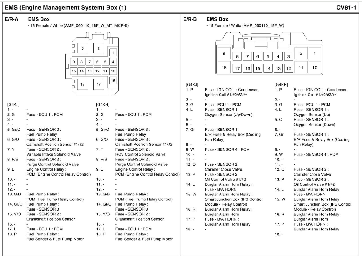

Also if I can get the pin out for the fuse box connector, and the power and ground for the TCM/ECM. For the ohms resistance, I will also double check. Thank you.
Dec 31, 2024 at 12:38 PM
  • 54,832 POSTS
There is no TCM only the PCM, here are the pinouts and the wiring diagrams I have provided above. Check out the images (below). Let us know what you find.

Thank Ken, what I realized, the output speed sensor is reading higher than the specified reading from the repair service manual. So I ordered a new sensors for replacement.

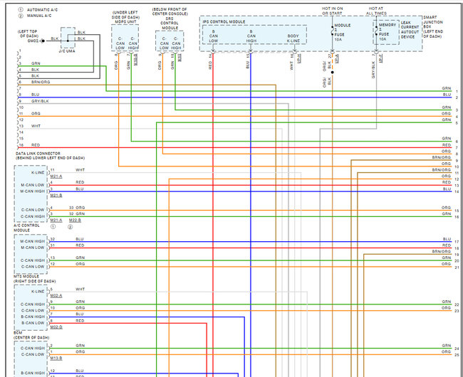

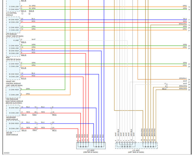

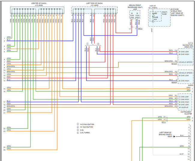

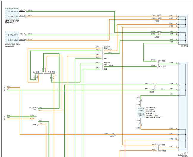

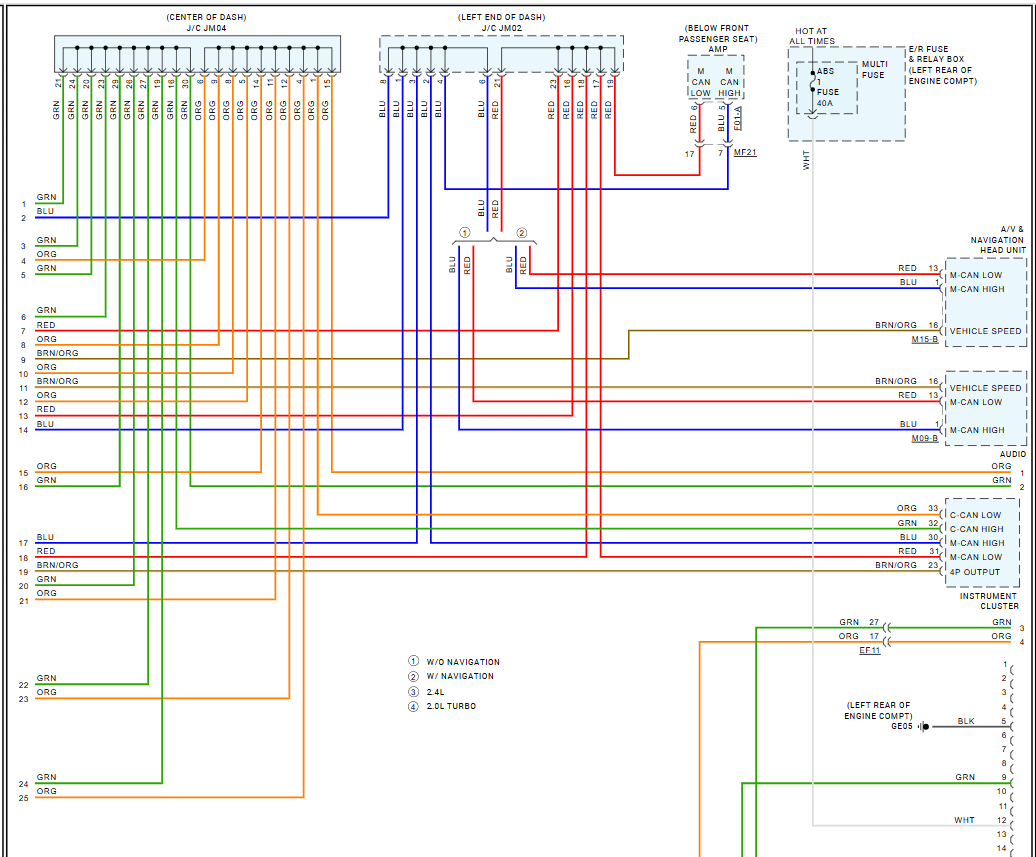

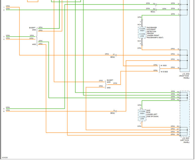

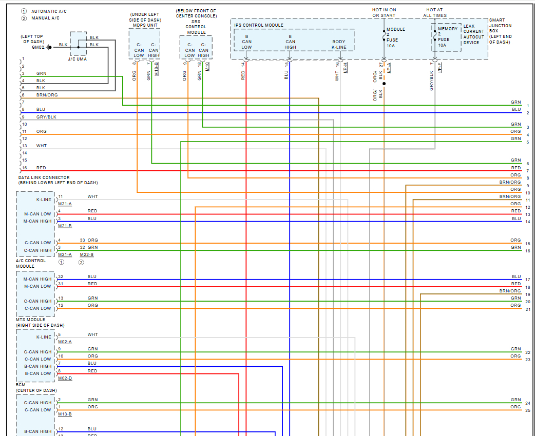

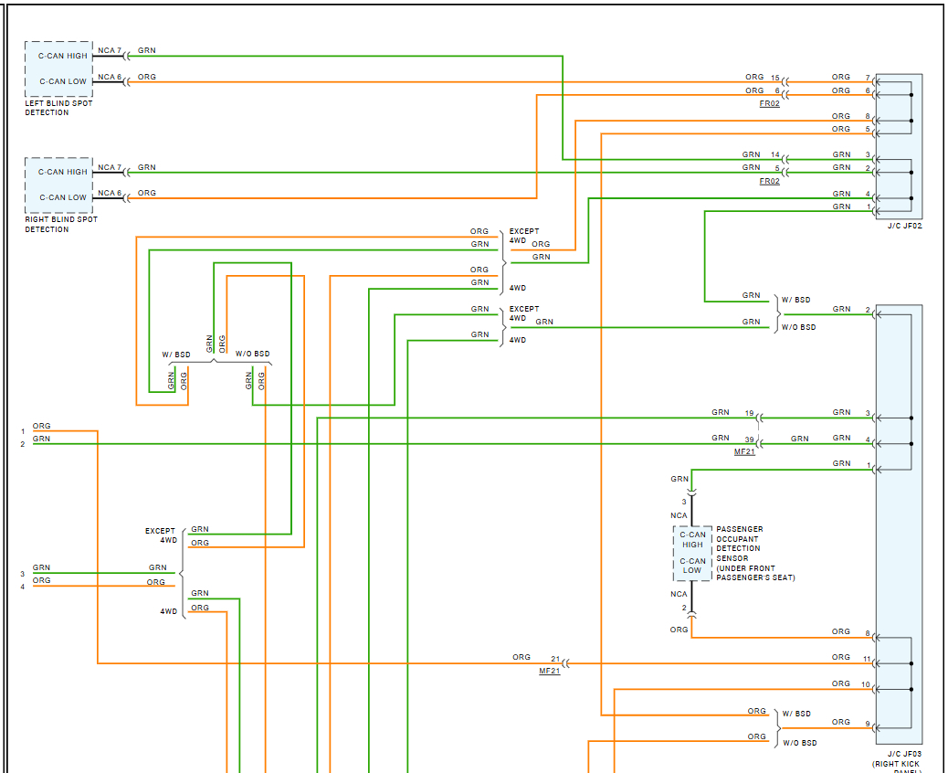

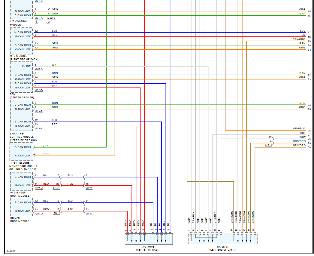

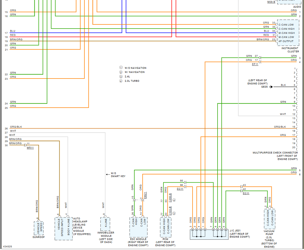

Please, i am still on this Hyundai as this has been a tough one for me, i have even replace a new transmission and yet the transmission is stock on 4th gear. Please may i have the network communication diagram for this transmission, also the grounding?
Feb 6, 2025 at 7:50 AM
ANDRIN ATEM
  • 406 POSTS
But what amazes me is that this hall affect output and input speed sensor has no resistance. Is the actually an information of a resistance for this sensors?
Feb 6, 2025 at 7:52 AM
  • 54,832 POSTS
P0732 - Gear 2 Incorrect Ratio
Hall Effect sensors typically do not have measurable resistance across their terminals when tested with a standard multimeter. Here is the CAN network diagrams as requested.
Feb 6, 2025 at 9:20 AM

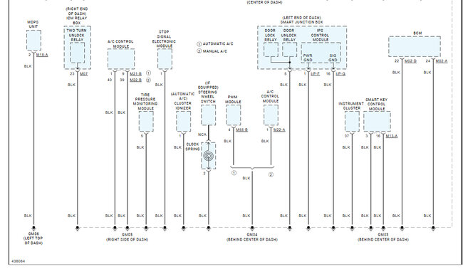

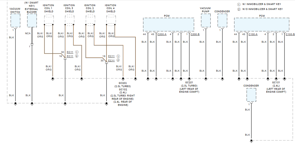

  • 406 POSTS

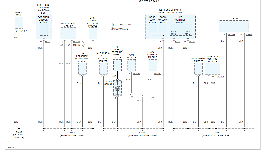

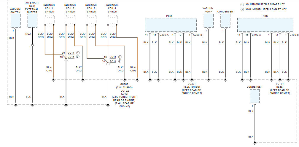

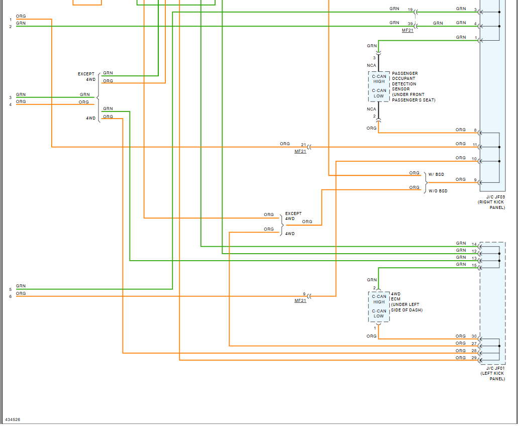

Thank you once more Ken, please can i get the ground location wires in the engine compactment?
Feb 7, 2025 at 6:49 AM
  • 54,832 POSTS
Sure, here are the engine compartment grounds. Check out the images (below). Let us know what you find.

Hi Ken, please I would like to truly verify if this Hyundai has a transmission module or it’s the same as the PCM or ECU.
Feb 12, 2025 at 11:54 AM
ANDRIN ATEM
  • 406 POSTS
And if it has a transmission module, can you help me get its exact position?
Feb 12, 2025 at 11:55 AM
  • 54,832 POSTS
There is no TCM only a PCM that runs the transmission.
Feb 13, 2025 at 9:11 AM

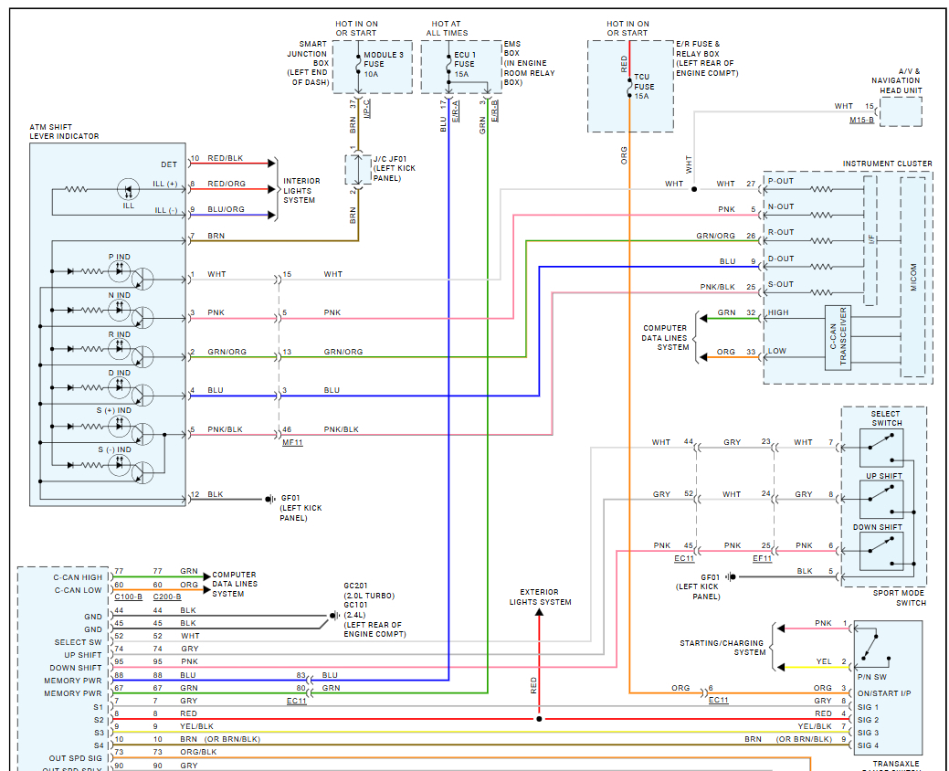

I have noticed that signals that leaves the TCM to the gear switch range senso are not consistent with what the factory diagram prescribes. So, I wonder if we might a wrong ecu on this car. Any ideas on what the correct Tec or ecu goes for this 2.4 gdi sports?
Feb 13, 2025 at 3:52 PM
  • 54,832 POSTS
Is this a euro car?
Feb 14, 2025 at 10:37 AM
ANDRIN ATEM
  • 406 POSTS
No, it’s from US
Feb 14, 2025 at 11:39 AM
  • 54,832 POSTS
Yep here is the info,
Non-SCC (Smart Cruise Control): ECU part number 211012GK02QQH
SCC-equipped: ECU part number 211012GK02QQH
Feb 15, 2025 at 9:50 AM
