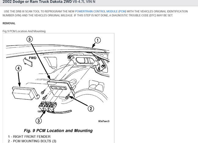

It sounds like the PCM is bad, I would send it out for testing here is the location so you can check it out, you can get a preprogrammed unit by searching Google or Ebay. here is more information:
The P0725 error code in an automobile diagnostic reading represents an issue with the "Engine Speed Input Circuit".
Check out the images (below). Please let us know how it goes.

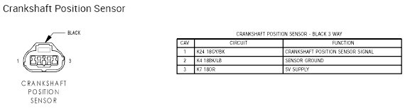

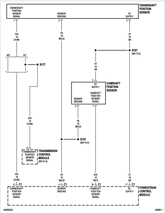

Any way you could send me wiring diagram for speed sensor.
Jun 26, 2023 at 10:30 PM
MATHGEN
  • 128 POSTS
Here is the schematic and connector pinout for the CKP sensor. Let us know if you need more assistance.
Jun 26, 2023 at 10:48 PM
EARL91
  • 88 POSTS
i see were the wires clip onto the PCM were broken causing a bad connection. so, i have ordered a new one. will keep ya'll updated.
