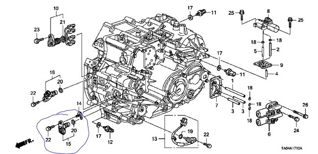

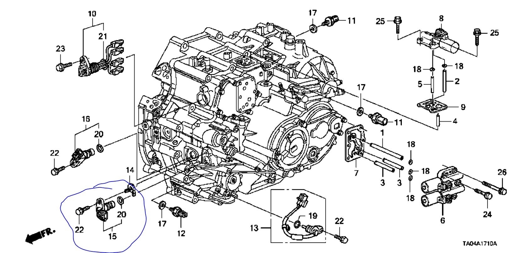

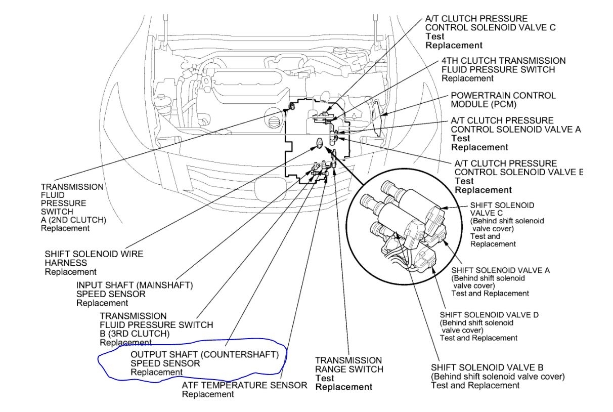

Where is the output speed sensor location? I have found the input but not the output.

I attached the location of the output speed sensor for you. Can you verify the code, please? I do not see this code list for the V6. Check out the diagrams (Below). Let us know what happens and please upload pictures or videos of the problem.
