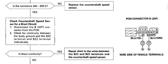

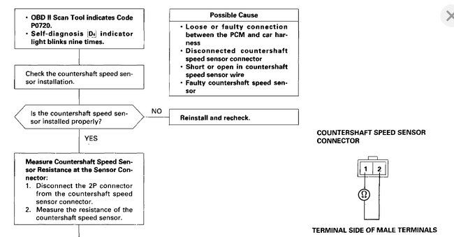

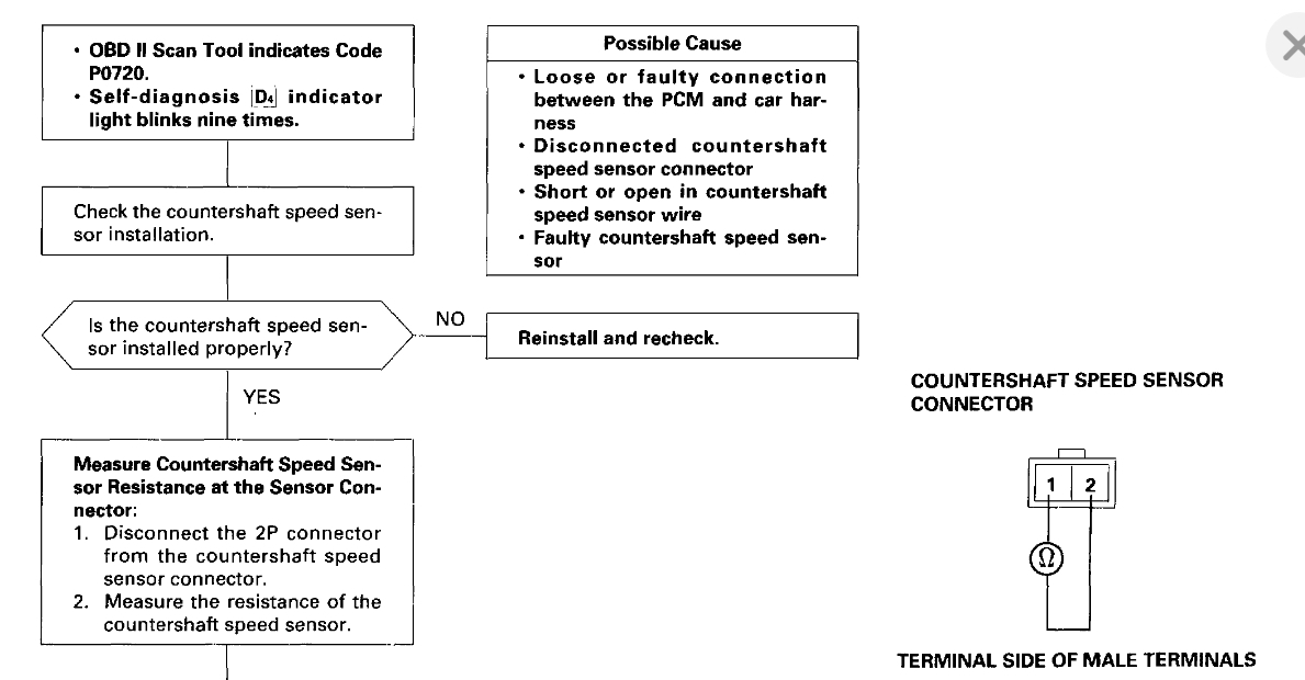

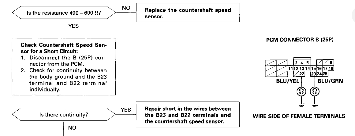

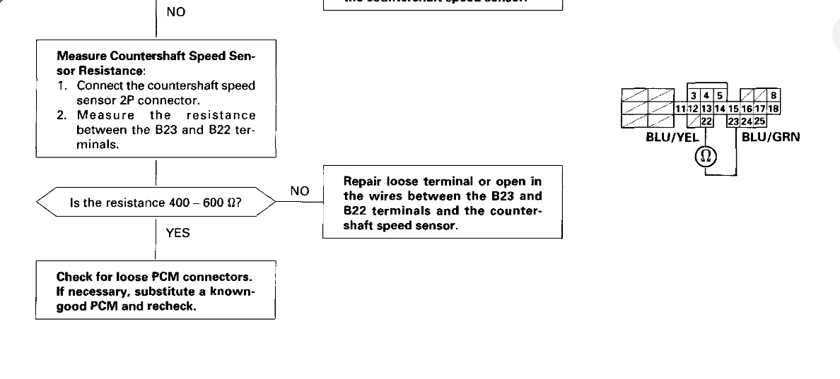

Had the VSS replaced after A check engine light showed P0720. But the code still appears after driving a minute.
Oct 3, 2019 at 1:02 AM
VIDIT MANGLANI
Need to get my car smogged. What else except the VSS could be causing the P0720 CEL?
Replacing the sensor didn’t help. Should I change/clean something else?
Oct 6, 2019 at 4:13 AM
SCGRANTURISMO
  • 4,897 POSTS
In the diagrams down below I have included a diagnostic troubleshooting flowchart from your vehicle's manufacturer for Direct Trouble Code(DTC) P0720. Please go through this guide and get back to us with what you find out.
