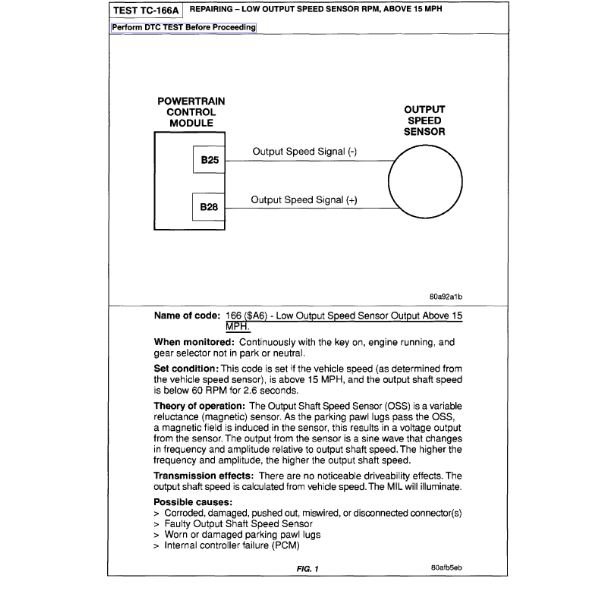

I was driving on the highway. and it acted like it would come out of gear and go back in gear off and on. I put my code reader on it when I got home and had a p0720 and p0545. So I changed out the output speed sensor and drove around about six miles and it ran fine and no codes. Drove it again about five miles and it did it again and got just the p0720 code again.
Jul 31, 2018 at 3:17 AM
Good afternoon.

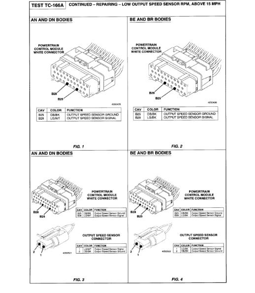

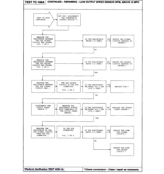

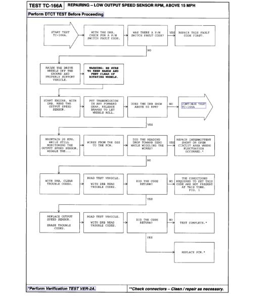

I attached a flow chart for you to follow. Before spending on money on parts you may not need, I would suggest going through the diagnostic.
Jul 31, 2018 at 6:54 AM
