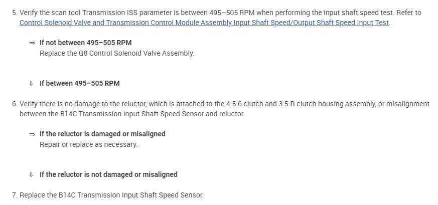

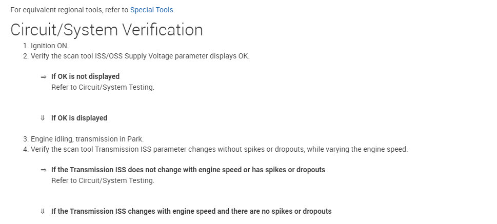

The issue could be a wiring problem, the toner ring that the sensor uses may be faulty, there could be a voltage related, and so on.
I attached the diagnostics below for the code. Take a look through them and let me know if you are comfortable performing them.

Thank you for the guidance! My ISS voltage is not showing any change/reading. How would I preform the circuit/system testing?

Were you able to check the voltage to the sensor? Do you have a scan tool that can do what is listed in the above tests?

I'm using an OBD2 reader that reads "vehicle speed sensor" and "control module voltage" previously they read "29 MPH" and "14.57 v" on the freeze frame and now they are both reading "0".

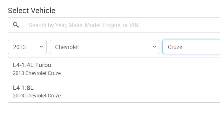

I tried going through schematics but found there are two possible transmissions. See pic below.
By chance do you know which one you have?
See pic below.

I have a 6t40, it's not a turbo.

Now I'm confused. LOL They didn't offer the 1.4L as a non-turbo. See pic below.
Is it possible that you have a 1.8L?

Oh lord, that's my fault lol! Yes, it's a 1.8L!
