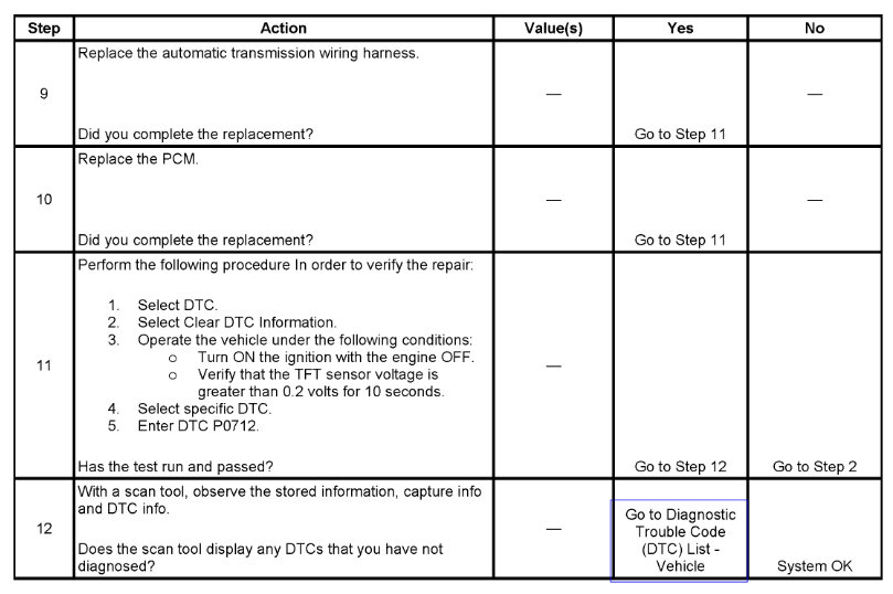

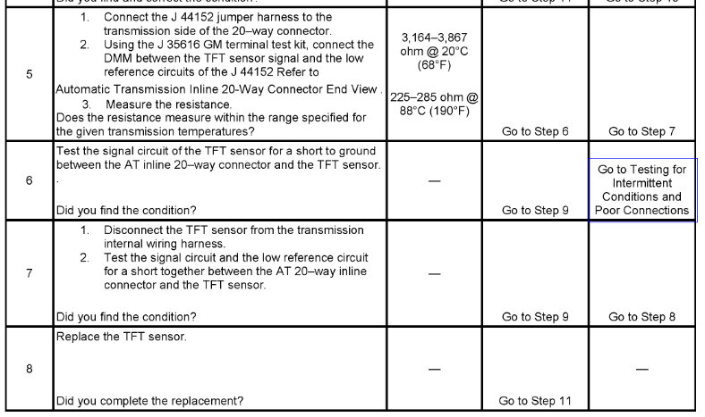

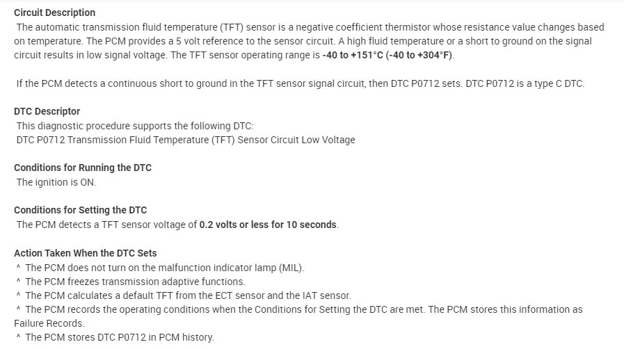

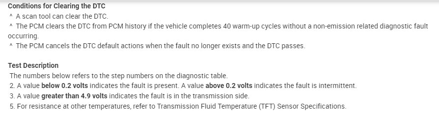

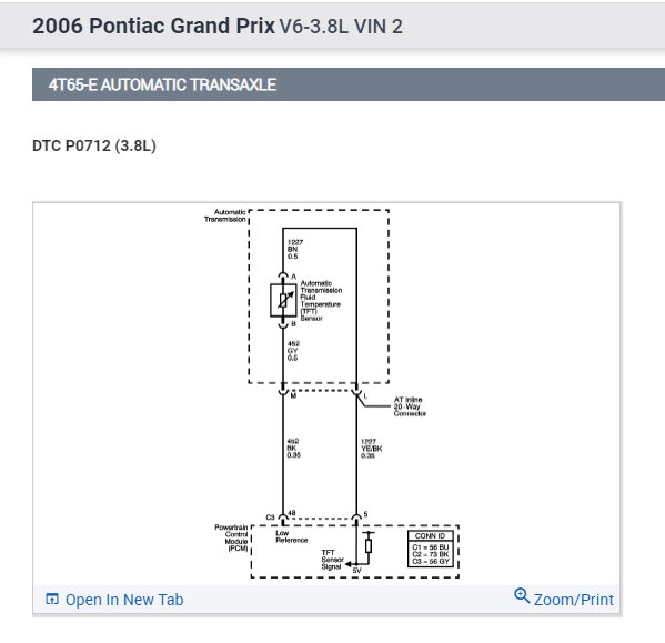

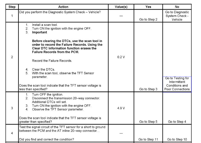

I don't feel the transmission needs to be replaced. Also, the fluid itself isn't the cause. You likely have a short in the wiring harness to the transmission.
I attached diagnostics below for you. Take a look through them and let me know if you are comfortable performing them.
May 29, 2023 at 7:41 PM
RONALD DEVOLD
  • 134 POSTS
Thanks. I cleared the code, and I changed the fluid and filter. It's been a few days since and the code did not come back, but a slight drag when shifting.
