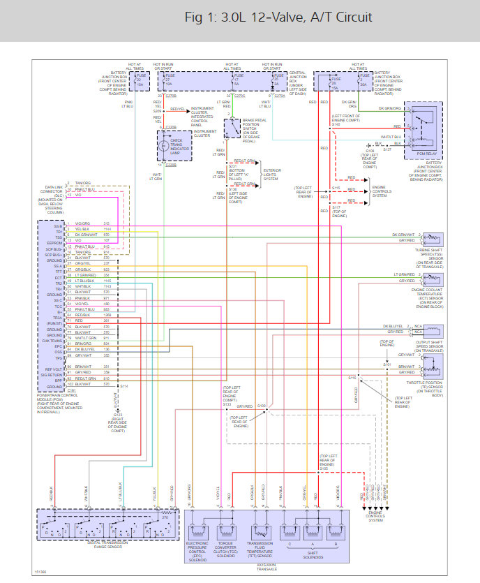

I have the car listed above LS model, 24V.
Both the engine light and the check trans-axle light came on yesterday. I pulled the code on it and it was a P0705.
So, I figure I would change the transmission range (TR) sensor (also called neutral position switch), not that difficult to replace. However, that did not fix the problem.
Each time I put the car in revers it "bucks" (but it has been doing this for seven to eight years), and when I put it in Drive (D) the Check trans-axle light starts blinking and it still throws the P0705 code.
I checked the transmission fluid and it looks clean, I could add a little, but the level is still in the hash.
The car still drove well after throwing the code, I have not test driven it after changing the TR sensor.
Any ideas on what to check next?

It sounds like you have a bad connection between the PCM and the range sensor. Here is a guide to help you check the connections:
Here are the wiring diagrams for your transmission.
Please run this test and get back to us.
