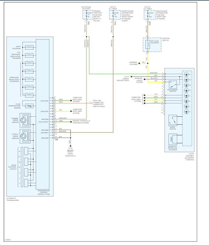

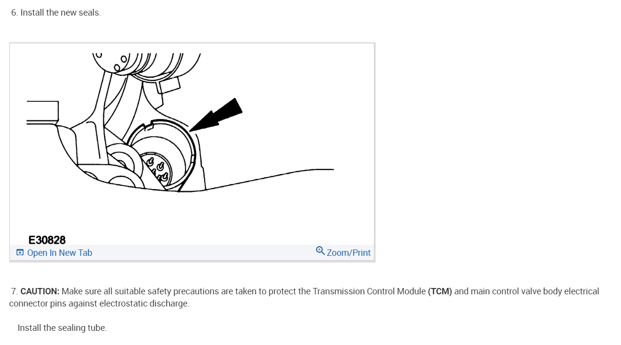

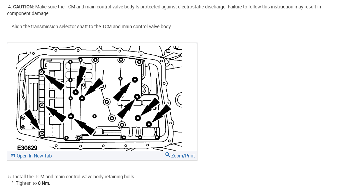

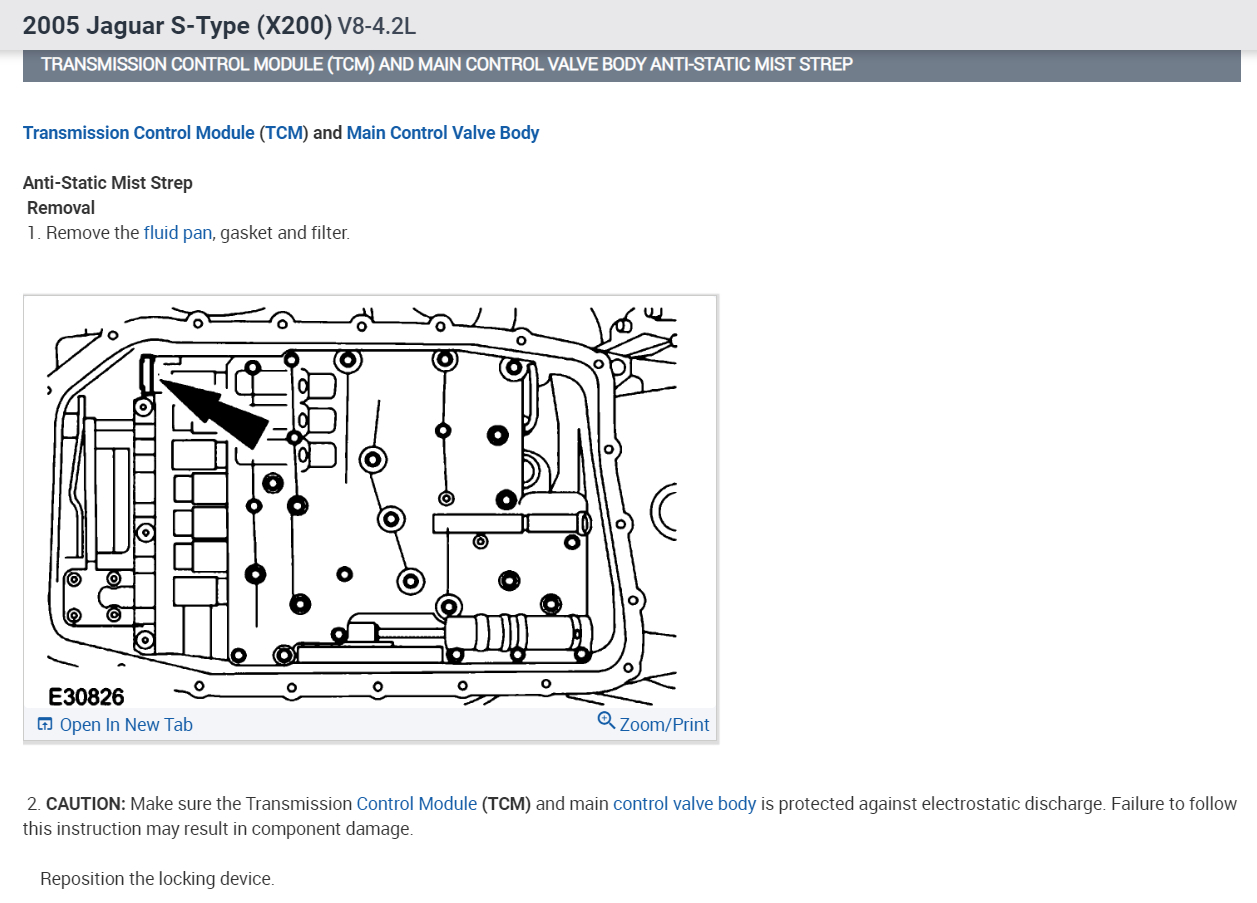

Code P0705, where is the transmission range sensor located?
120,000 MILES • 4.2L • V8 • 4WD • AUTOMATIC
LITA DAVIS

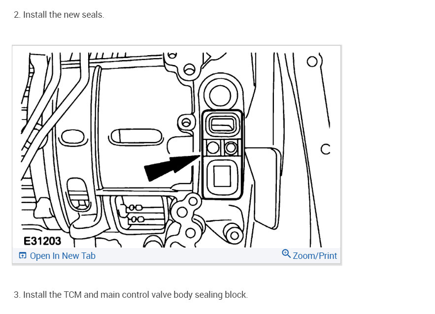

Transmission range sensor location needed.
Mar 25, 2023 at 3:10 PM
  • 55,456 POSTS

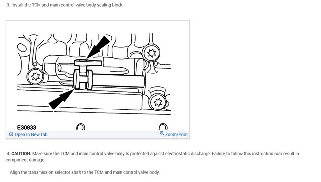

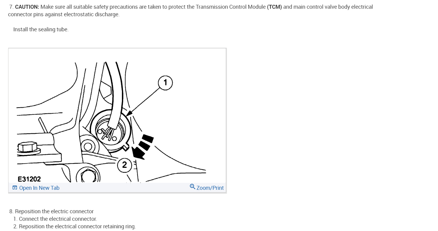

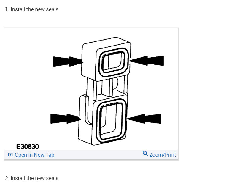

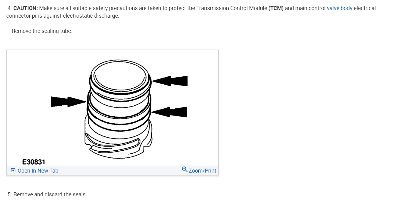

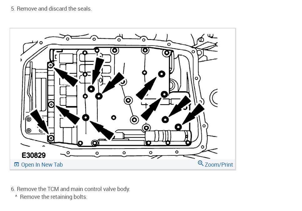

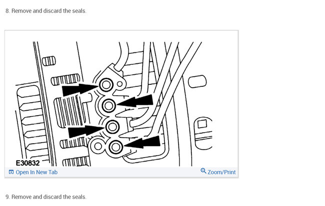

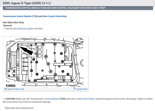

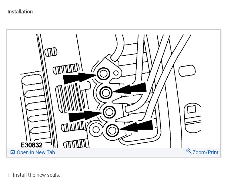

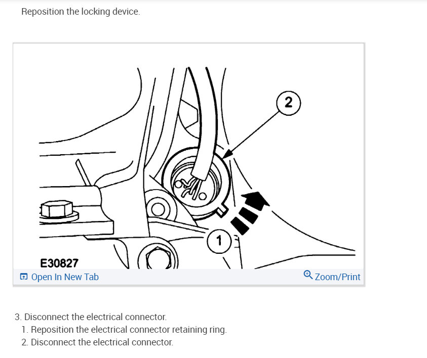

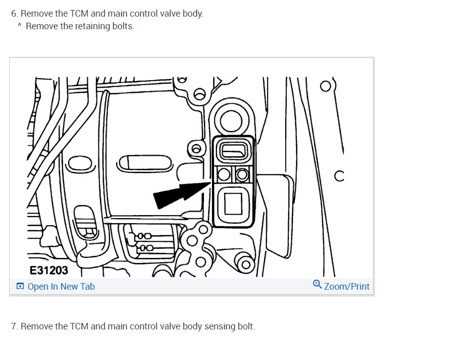

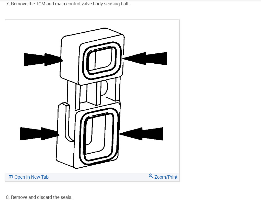

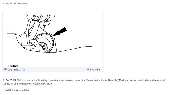

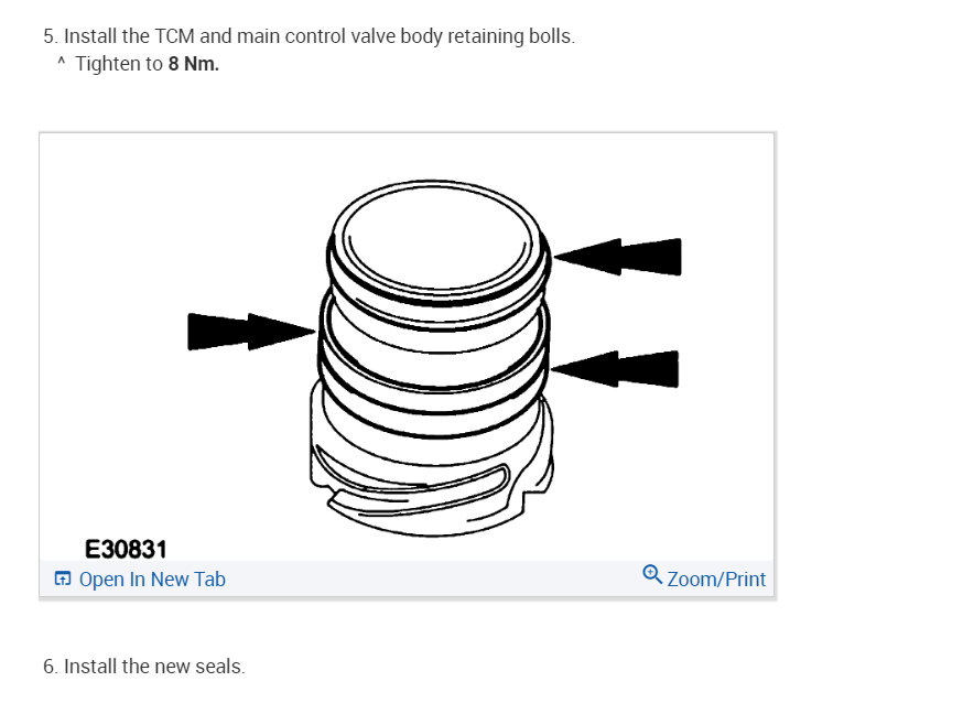

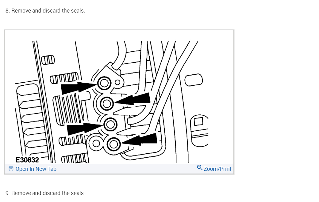

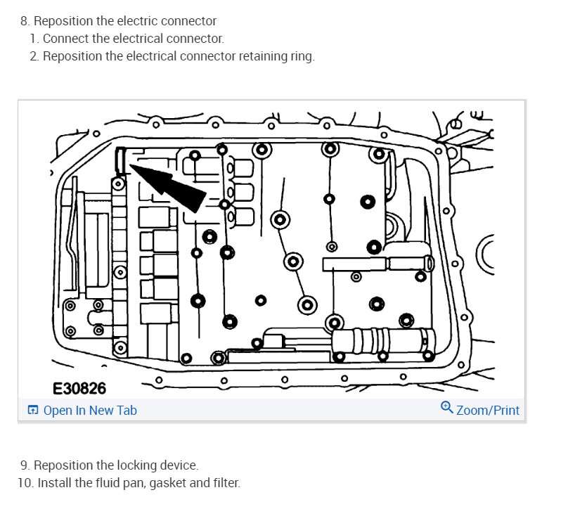

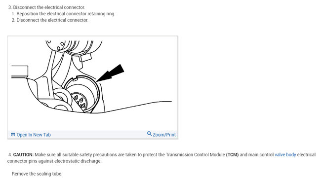

The transmission range sensor is located inside the transmission which is internally housed inside the TCM (transmission control module) which is inside the transmission. Here are the wiring diagrams so you can see how the system works and how to change out the TCM. Check out the images (below). Please let us know if you need anything else to get the problem fixed.
