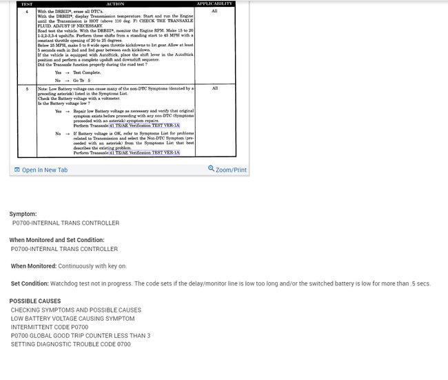

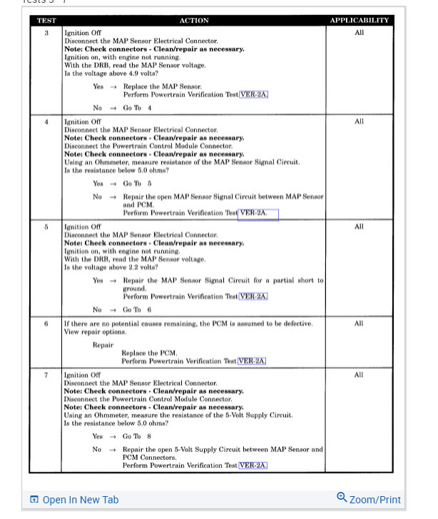

Driving and went into safety/limp mode no power spits and spudders idles very rough. What could trigger these three codes and mechanical issues?
Dec 16, 2021 at 1:07 PM
Experienced Mechanic
52,796 POSTS
Good morning,

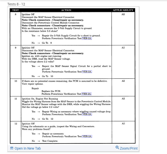

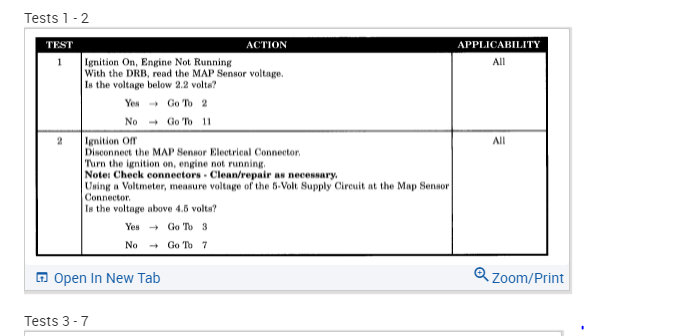

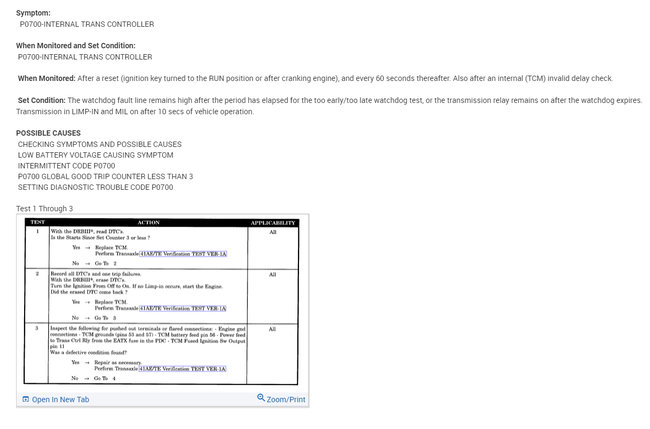

I attached the flow chart for the 700 codes for the transmission for you. Follow the steps the best you can and let me know how you make out.

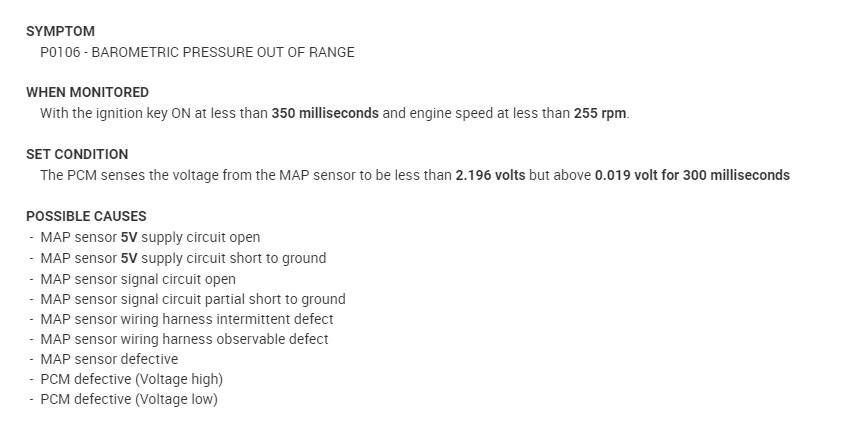

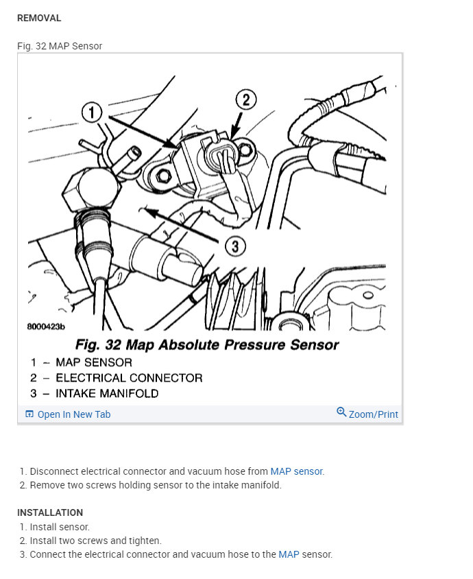

The 0106 is for the map sensor. verify the voltage at the connector before condemning the sensor itself.
I cannot find the 1714 or 714 code. Can you verify that one for me?
