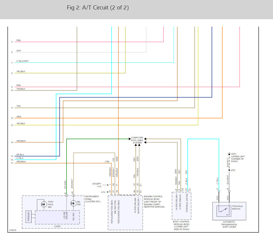

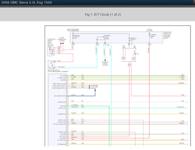

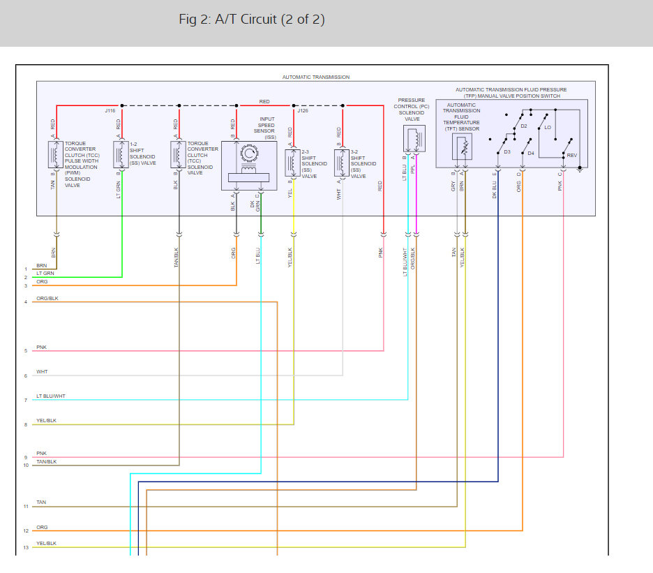

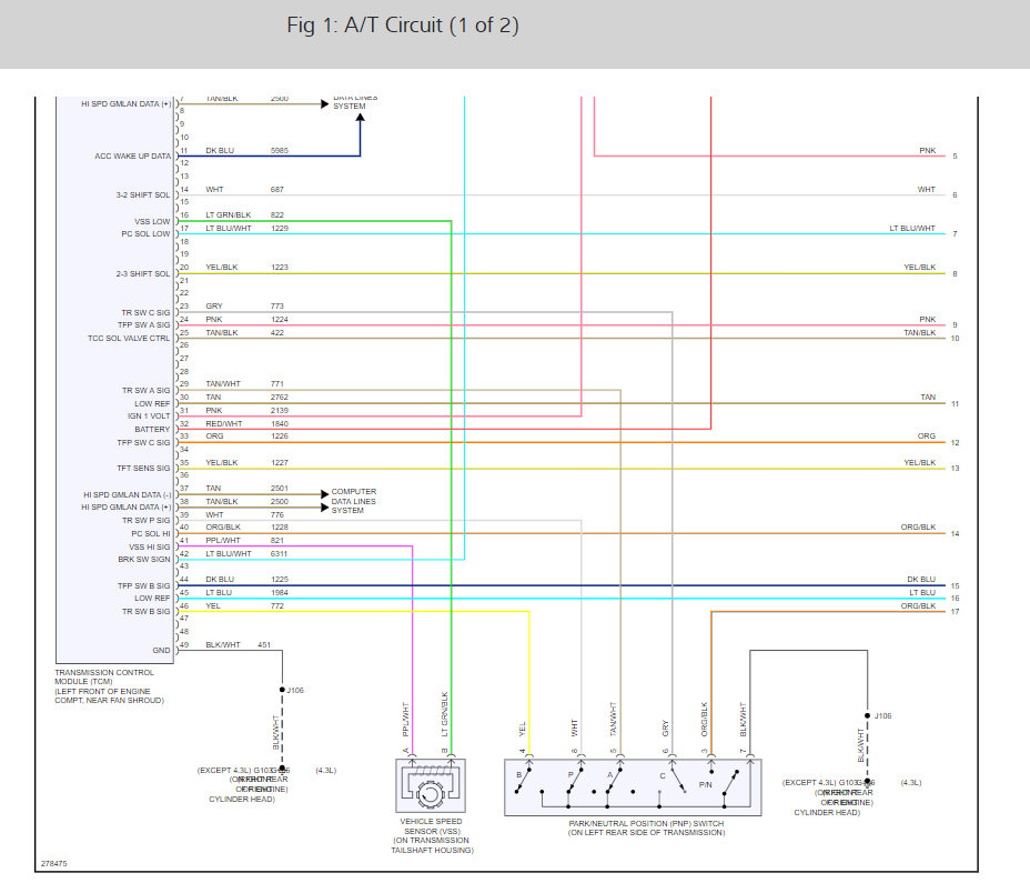

Lets unplug the transmission and then replace the fuse to see if it pops. also I have included the transmission wiring diagrams so you can see how it works. Check out the diagrams (below). Please let us know what you find. We are interested to see what it is.
