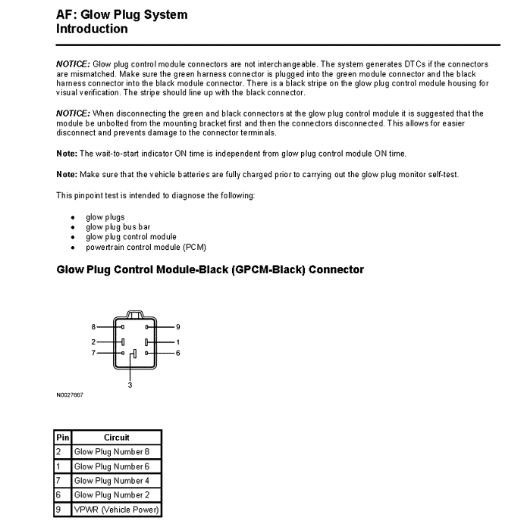

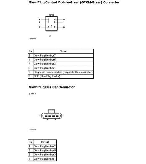

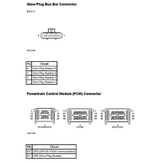

I attached some possibilities for you to view and I also attached a flow chart for you to follow.
P0677
Descriptor
Probable Causes
Glow Plug 7
Glow Plug 7 Circuit Open
Glow Plug 7 Circuit Shorted to Ground
Glow Plug 7 Circuit Shorted to Voltage
