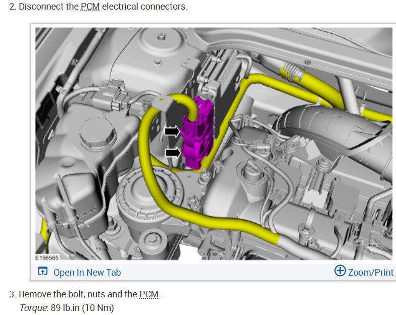

The car on driving after warmup throws out a DTC code P0657 Powertrain error. Prior to the error message the car drives fine, accelerates and shifts fine. Automatic Transmission.
Upon receiving the error message P0657 the car goes into limp mode that allows me to get the car home. I understand the features of the safety mode but prior to this it had been acting fine. When I research the code further it indicates an "Actuator Supply Voltage Circuit/ Open. It reports the primary fix as "Repair Wire harness at Transmission."
Another fix listed on the report is "Repair Transmission Main Connector Wiring"
I can clear the code with my scanner, and it runs fine, no trouble with the transmission at all. Shifts fine, Goes into reverse fine. I cannot image that the transmission is bad.
Any thoughts on this would be appreciated.

I would start by checking the battery voltage and then all of the fuses.
This guide can help:
The P0657 DTC refers to an issue with the "Actuator Supply Voltage 'A' Circuit/Open."

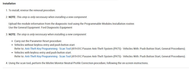

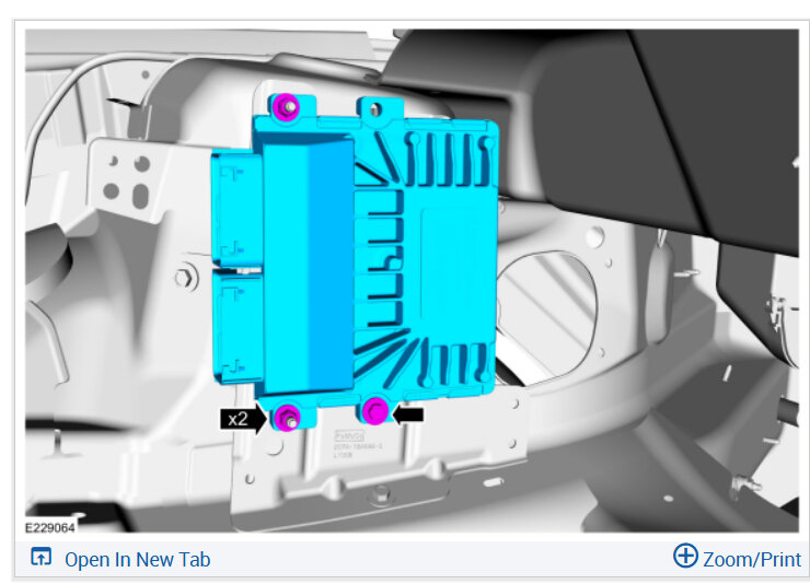

If the fuses and battery are okay, I would say the PCM is bad, there are no "Actuators" inside the transmission, only sensors and shift solenoids. I have left the location and instructions on how to change out the PCM, you can get a preprogrammed unit by searching Google or Ebay. Check out the images (below). Please let us know what happens.

Yes, it will need to be programed but you can get a preprogrammed unit by searching google or eBay. Check out the images (below).
