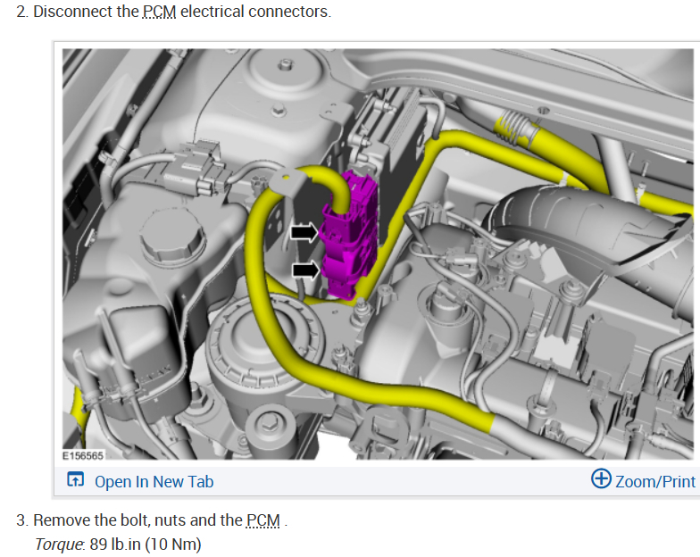

I would start by checking the battery voltage and then all of the fuses.
This guide can help:
The P0657 DTC refers to an issue with the "Actuator Supply Voltage 'A' Circuit/Open."

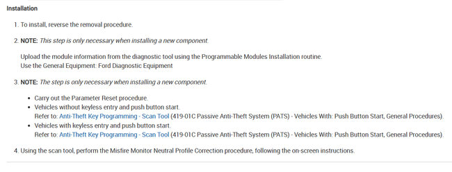

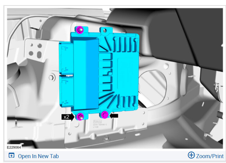

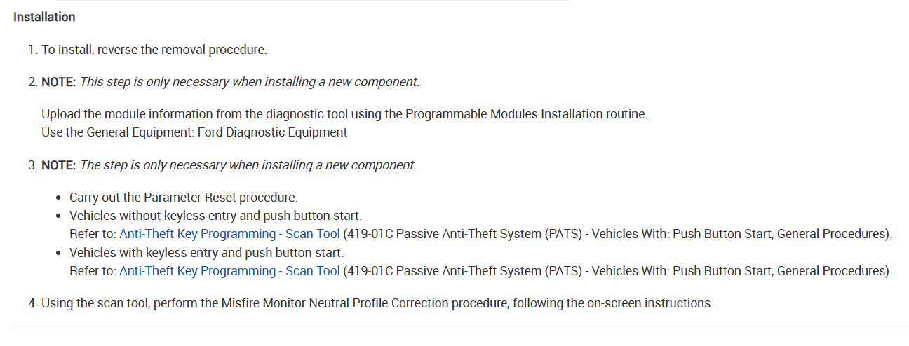

If the fuses and battery are okay, I would say the PCM is bad, there are no "Actuators" inside the transmission, only sensors and shift solenoids. I have left the location and instructions on how to change out the PCM, you can get a preprogrammed unit by searching Google or Ebay. Check out the images (below). Please let us know what happens.

Thank you for your quick reply. I will definitely keep you posted and thank you for the information. So, if it’s the PCM would it need to be reprogrammed to match the car? And would it be a safe assumption that there isn’t anything mechanically wrong with the transmission then?
Kind regards
Dec 14, 2024 at 4:22 AM
  • 55,399 POSTS
Yes, it will need to be programed but you can get a preprogrammed unit by searching google or eBay. Check out the images (below).
