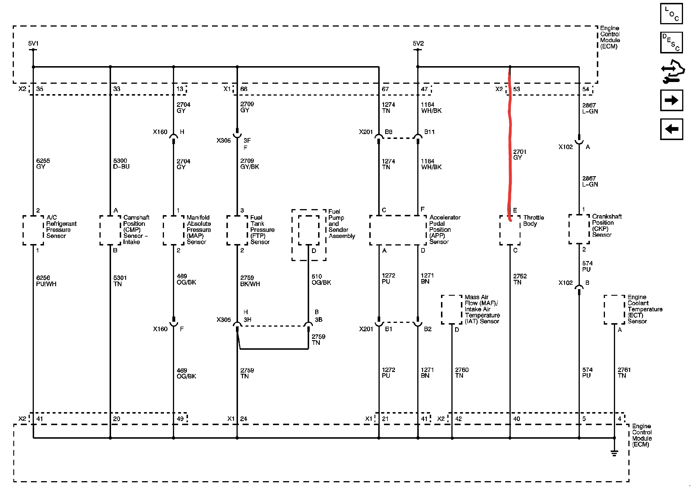

5vB is missing (5v2).

Hello and welcome to 2CarPros. Here is a circuit description so you can see what is controlled on the 5 volt reference:

Circuit/System Description
The engine control module (ECM) has 2 internal 5-volt reference busses called 5-volt reference 1 and 5-volt reference 2. Each reference buss provides 5-volt reference circuits for more than one sensor. A fault condition on one 5-volt reference circuit will affect the other 5-volt reference circuits connected to that reference buss. The ECM monitors the voltage on the 5-volt reference buss.
The 5-volt reference 1 buss provides 5 volts to the following sensors:
 *  The manifold absolute pressure (MAP) sensor
 *  The fuel tank pressure (FTP) sensor
 *  The air conditioning (A/C) refrigerant pressure sensor
 *  The accelerator pedal position (APP) sensor 2
 *  The exhaust camshaft position (CMP) sensor
 *  The intake CMP sensor
The 5-volt reference 2 buss provides 5 volts to the following sensors:
 *  The APP sensor 1
 *  The throttle position (TP) sensor 1 and 2
 *  The crankshaft position (CKP) sensor
 *  The secondary air injection (AIR) solenoid
At the throttle body, back probe the grey wire on the connector with key on engine off.since the 5 volts is missing, unplug the connector with the probe still attached. If the 5 volts comes back on the throttle is bad. If no 5 volts then start unplugging every component on bus 2. The APP is the accelerator pedal so unplug it. If the 5 volts comes back on then the APP is bad and if not unplug every component until you get 5 volts back. Let us know what the test results are.
You can also work backwards and unplug everything in that circuit and plug one item at a time until you lose the 5 volts to isolate the problem. If you have any questions, don't hesitate to ask.

Turned out to be Secondary Air Injection Shut-Off and Check Valve found one at junk yard $25 all fixed.. Thanks for your guidance
