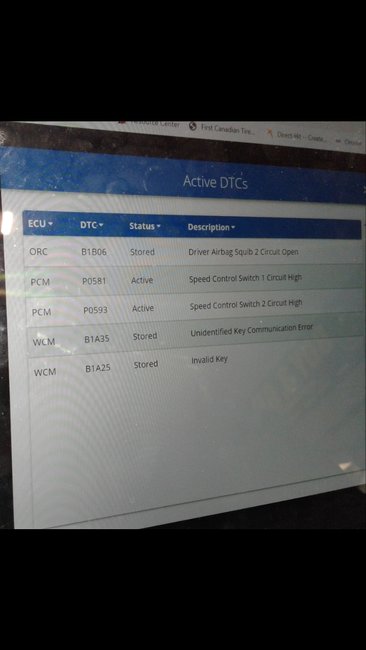

  • 16 POSTS
These are the 3 codes. The airbag one is B1B06 and as you can see from all 3 codes all 3 circuits are high. Whatever that means lol. I'm thinking the B1B06 aka clock spring (right?). Is causing the other 2 codes to go off and my car doesn't even have cruise control. As for the software thing the dealership can't just check that, that's part of a diagnostic which is $162.00, so I doubt I'll so it unless I really have to and no one can ever figure out why the rpm's go up while downshifting. Once again thanks for your help and time Roy.
Oct 28, 2019 at 8:01 AM
The 2 B codes you showed are for unidentified keys.
Did you use an incorrect key to start?
The other ones should be part of the update on the software since you do not have cruise.
I would not get a clock spring. What makes you think you need a clock spring?
Oct 28, 2019 at 8:14 AM

MITCHRUBIN09
  • 16 POSTS
The first code is also a B code, you said my 2 B codes and I have 3. You are saying the first B code which has to do with the airbag has nothing to do with the speed circuit high codes and the reason I'm getting these codes is most like because of the bottom 2 codes which are also B codes? And I need a factory update done?
Oct 28, 2019 at 11:06 AM
What was the third B code. I could not read it in the picture.
Oct 28, 2019 at 11:35 AM
MITCHRUBIN09
  • 16 POSTS
B1b06, b1a35, b1a25 a. those 3 say stored under status, the p0593 and p0581 says active under status.
Oct 28, 2019 at 12:08 PM
Can you verify the B1b06 code? I see nothing at all for this code for your car.
Oct 29, 2019 at 5:51 AM
MITCHRUBIN09
  • 16 POSTS
The first code is b1b06 (status/stored)-driver airbag squib 2 circuit high. The next code is p0581(status/active)-speed control switch 1 circuit high and the 3rd code is p0593 (status/active)-speed control switch 2 circuit high. I attached a picture, not sure why you couldn't see the b1b06 code? But it's there with the other 2.
Oct 29, 2019 at 11:42 AM
I am not saying I cannot see it on your picture, I do not see it in my information system.
Anyway, the explanation indicates a short somewhere in the harness with the high voltage code. Yes, it could be the clock spring but also could be a short somewhere else.
I would start by getting the reprogramming done for the other codes so they do not mislead you to thinking the other codes may not be real.
