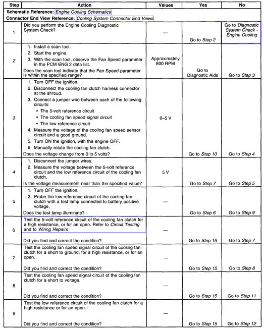

Code P0526 and running rough
2004 ISUZU ASCENDER
174,000 MILES • 4.2L • 6 CYL • 2WD • AUTOMATIC
CASEY LANE BUJNOCH
This vehicle is the same as Trailblazer/Envoy. Check engine light code is P0526 but will run rough sometimes. Disconnect battery and will be okay for a while then do it again.

The code you indicated is related to the cooling fan on both the GM and Isuzu. I'm not sure how that would cause it to run rough. However, I have a few questions. First, does the engine light only come on when it is running rough? Is there ever any engine temperature concerns?

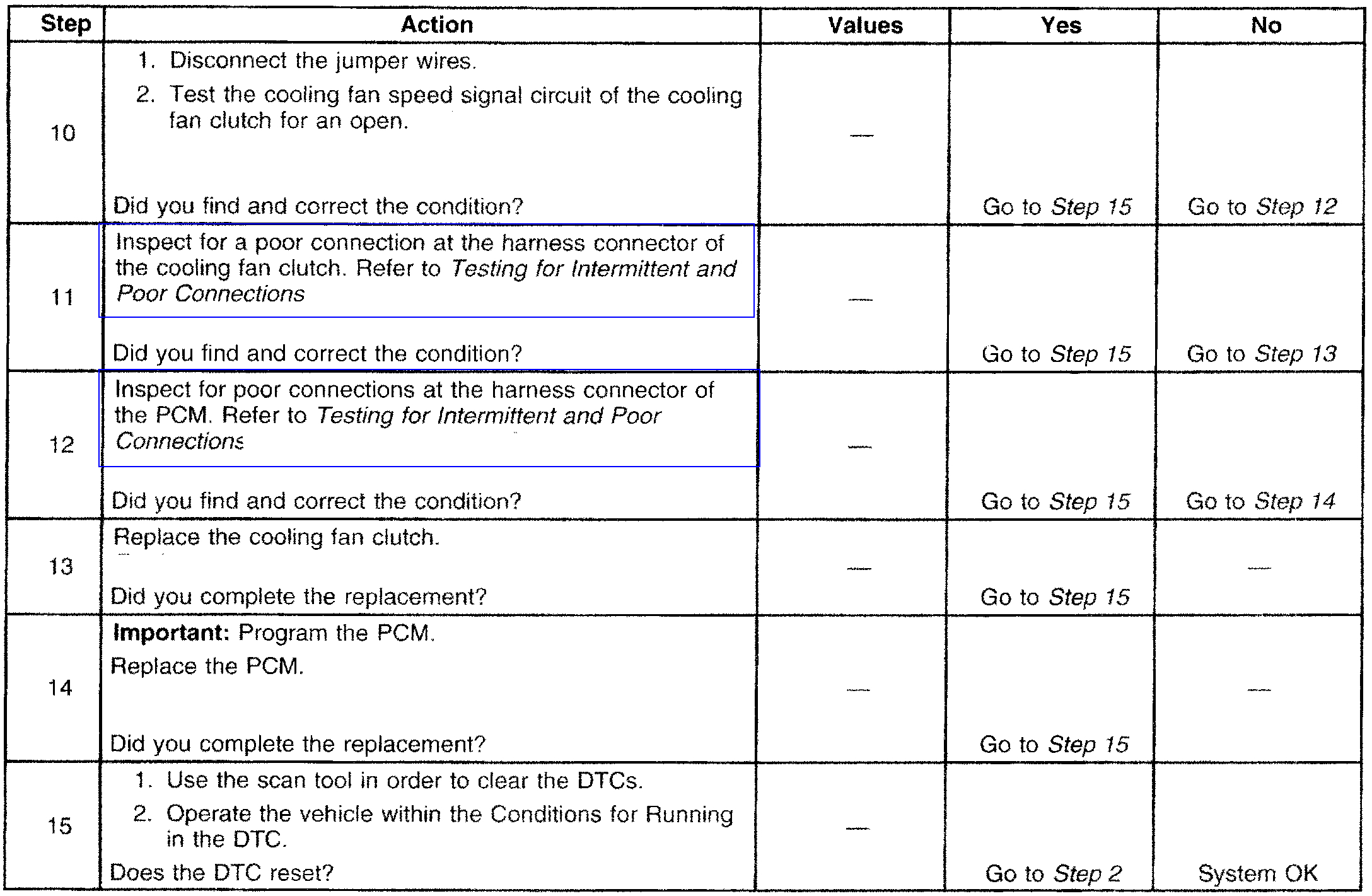

Here is the description of the code on a GM vehicle. The attached two pics are a flow chart explaining how to locate and repair the issue. The same information is on the Isuzu page.
2004 Chevy Truck TrailBlazer 2WD L6-4.2L VIN S
P0526
Vehicle ALL Diagnostic Trouble Codes ( DTC ) Testing and Inspection P Code Charts P0526
P0526
DTC P0526
Circuit Description
The Powertrain Control Module (PCM) uses the cooling fan speed signal in order to determine the actual fan speed in relation to the desired fan speed. The PCM uses the cooling fan speed signal in order to reduce the cooling fan noise and in order to maintain the powertrain cooling requirements. The PCM supplies power and ground to the clutch hall effect sensor of the cooling fan clutch. The hall effect sensor returns a signal pulse through the speed signal circuit in response to the reluctor track, which is located inside the fan clutch. If during operation, the PCM detects a loss of the cooling fan speed signal, DTC P0526 will set.

2. Tests that the PCM receives a cooling fan speed signal through the cooling fan speed signal circuit. If answer to question is Yes, ensure to refer to all Diagnostic Aids.
3. Tests for the proper operation of the cooling fan clutch hall effect sensor. The voltage should fluctuate between 0 and 5 volts. If the voltage stays at 0 volts, the signal circuit is shorted to ground.
4. Tests for the proper operation of the 5-volt reference circuit and of the low reference circuit of the cooling fan clutch.

The check engine light stays on except when the code is cleared by scanner or by disconnecting the battery but then will come back on after awhile.

Could it be the PCM or BCM?

Yes it could be the PCM (not BCM). However, it could be a corroded connection, broken wire, and so on. If could also be the reluctor ring in the clutch assembly or the hall affect sensor has failed. If you have access to a scanner that can identify freeze frame data, check to see when the failure occurred, and where the problem seems to originate.
If that isn't an option, I feel I would focus on the fan assembly itself. Not saying the PCM can be an issue, but based on the code, I don't feel it is. Instead, I feel the sensor is a more likely suspect or a bad connection. In reality, the PCM seems to be functioning properly by requesting 100% from the fan.
Check the sensor and connections first. If you look through my last post, it will describe how to do it. Please feel free to ask me questions if you run into trouble.
