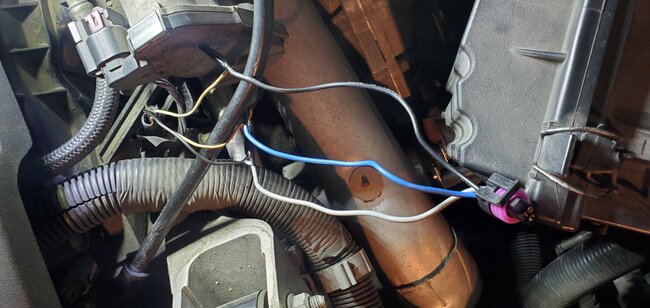

Hello, I changed out my oil with fresh oil change and also replaced the connector pigtail over the oil pressure sensor with ACDelco. Then I brought another oil pressure sensor AutoZone, but when I start car only the check light comes on, I don't get any other sounds like chimes from the dash or other blinking light just check light only. I checked for leaks no leaks and also, I checked the oil pressure sensor plus screen it's all good, but this code is bothering me because I keep replacing everything and it only comes on when I start the car. Where is the oil level sensor located on this car? I will probably replace that ASAP too.

P0521 is for “Engine Oil Pressure Sensor/Switch Range/Performance I would recheck the wiring at the connector and make sure it matches the sensor, if okay I would get another sensor because it sounds like yours is defective. Here is the location of the oil pressure and oil level sensors and how to replace them. Check out the images (below). Please let us know what you find. We are interested to see what it is.

Going to send you a photo of my pigtail I replaced, the reason I replaced was the old ring was missing and the ops had oil inside the sensor and now I change all that but sending you update what I change so far. Going to take photos now.
Oct 14, 2022 at 8:49 AM
LAVELL11
  • 98 POSTS
Check photo and see if I got it right. there are no leaks, like I said.

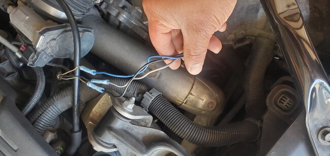

Thanks for the video, it looks like it is working but I am wondering about the wiring connections, they cannot be twisted together because the connection will be broken when the engine is running. I would solder or use crimp connectors. Once this is done clear the codes again, please. let me know.
Oct 15, 2022 at 5:24 AM
LAVELL11
  • 98 POSTS
Okay, thanks I will try doing that to the connectors ASAP.
Oct 15, 2022 at 5:26 AM
LAVELL11
  • 98 POSTS
I have them lock in, I will clear code and drive and let you know my results soon.
Oct 15, 2022 at 6:44 AM
  • 55,782 POSTS
Nice work, let me know, I hope that fixed it.
