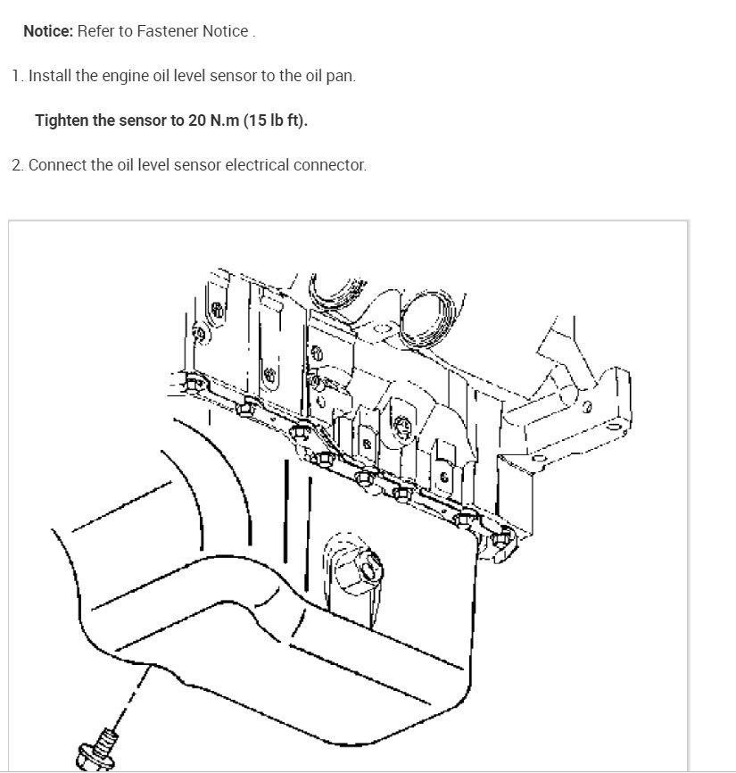

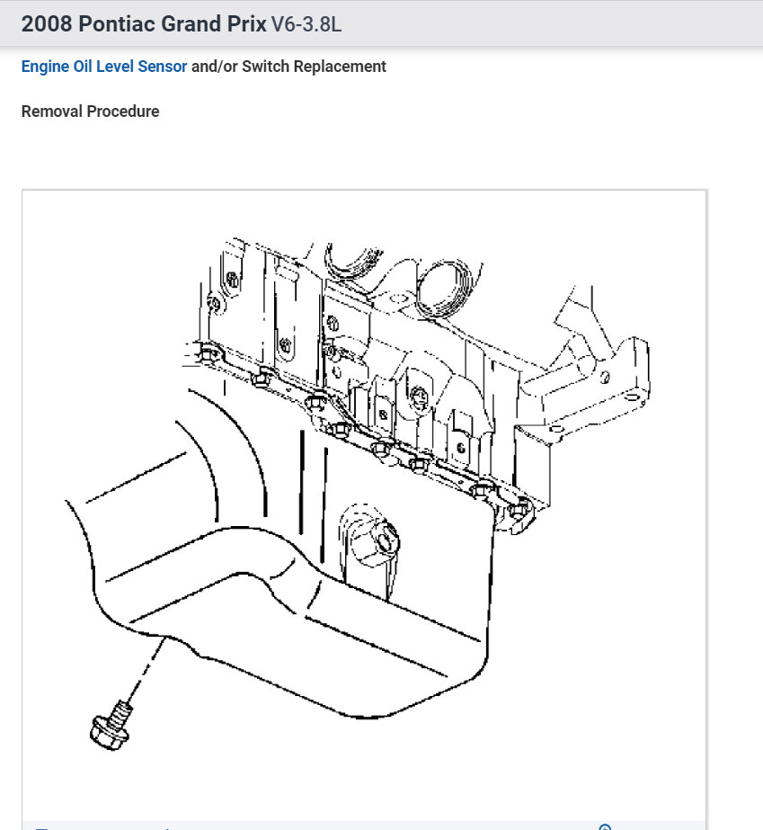

Hello, I changed out my oil with fresh oil change and also replaced the connector pigtail over the oil pressure sensor with ACDelco. Then I brought another oil pressure sensor AutoZone, but when I start car only the check light comes on, I don't get any other sounds like chimes from the dash or other blinking light just check light only. I checked for leaks no leaks and also, I checked the oil pressure sensor plus screen it's all good, but this code is bothering me because I keep replacing everything and it only comes on when I start the car. Where is the oil level sensor located on this car? I will probably replace that ASAP too.

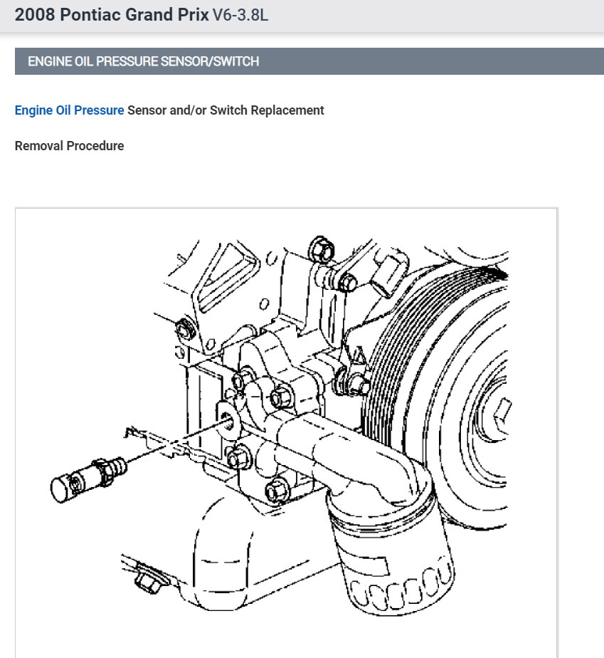

P0521 is for “Engine Oil Pressure Sensor/Switch Range/Performance I would recheck the wiring at the connector and make sure it matches the sensor, if okay I would get another sensor because it sounds like yours is defective. Here is the location of the oil pressure and oil level sensors and how to replace them. Check out the images (below). Please let us know what you find. We are interested to see what it is.
Oct 14, 2022 at 8:43 AM

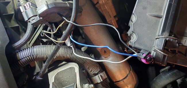

Going to send you a photo of my pigtail I replaced, the reason I replaced was the old ring was missing and the ops had oil inside the sensor and now I change all that but sending you update what I change so far. Going to take photos now.
Oct 14, 2022 at 8:49 AM

Check photo and see if I got it right. there are no leaks, like I said.
Oct 14, 2022 at 8:54 AM

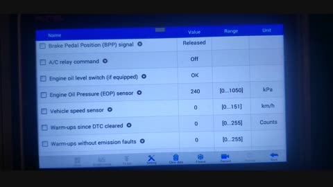

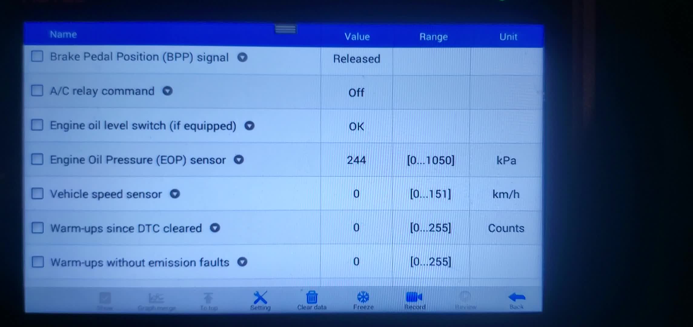

I have Maxicom 808bt scanner when I check the oil pressure is reads 260 kpa, I don't know what that means in PSI, but let me know I can send photos as well too.
Oct 14, 2022 at 8:55 AM

This is my video of my oil pressure sensor on my scan tool. Let me know what kpa means in PSI terms to determine if the sensor good or not, thanks.
Oct 14, 2022 at 9:37 AM

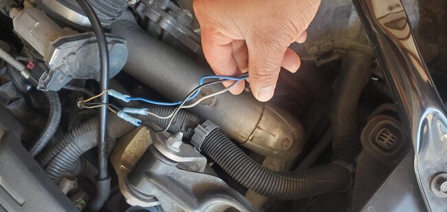

Thanks for the video, it looks like it is working but I am wondering about the wiring connections, they cannot be twisted together because the connection will be broken when the engine is running. I would solder or use crimp connectors. Once this is done clear the codes again, please. let me know.
Oct 15, 2022 at 5:24 AM

LAVELL11
  • 98 POSTS
I have them lock in, I will clear code and drive and let you know my results soon.

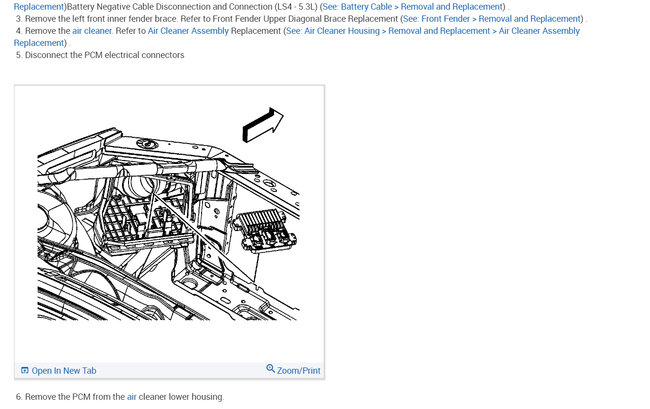

  • 55,423 POSTS

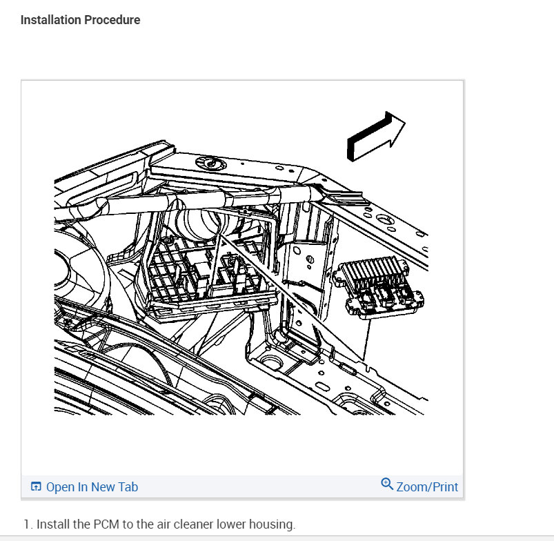

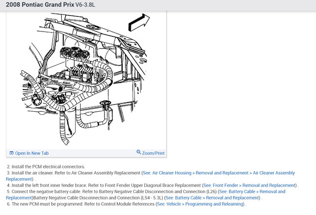

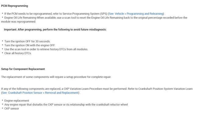

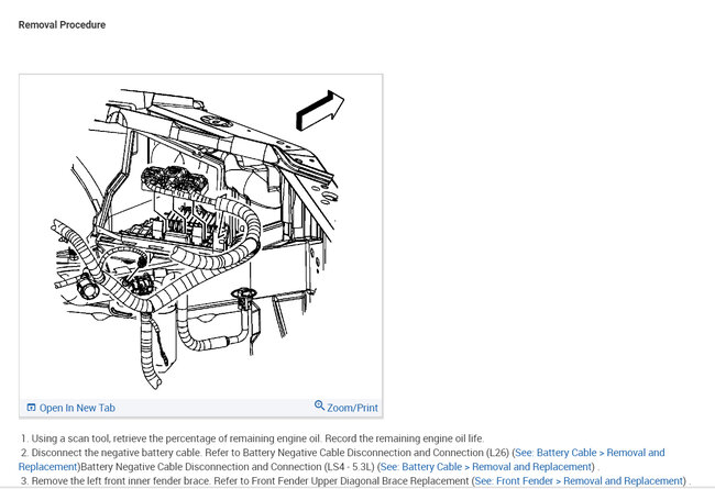

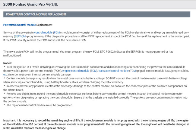

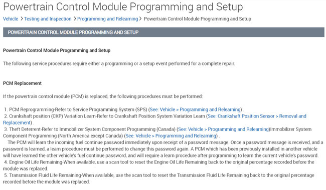

You could have a bad PCM which is causing he problem. if the oil pressure is good and the wiring and sensor is good I would replace the PCM. You can get a rebuilt unit by searching Google or Ebay. Here is how the job is done in the images below.
Oct 20, 2022 at 4:18 AM

LAVELL11
  • 98 POSTS

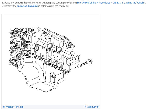

Hello, I'm back once again. So, I changed out the PCM that good, light still comes on and now I'm looking into the oil pickup tube, no chimes message on the screen just the check light itself. I got an Autel scanner shop tool so I check the sensor it's reading around 200kpa which is normal, but the light is my concern. If you anyany tips what I need to diagnose next let me know.
Nov 14, 2022 at 3:56 AM
  • 55,423 POSTS
Yep, that is the next step you may have a clogged oil pump pick up which would cause the sensor not to activate, you might want to try to bypass the sensor with a wire to confirm the issue.
