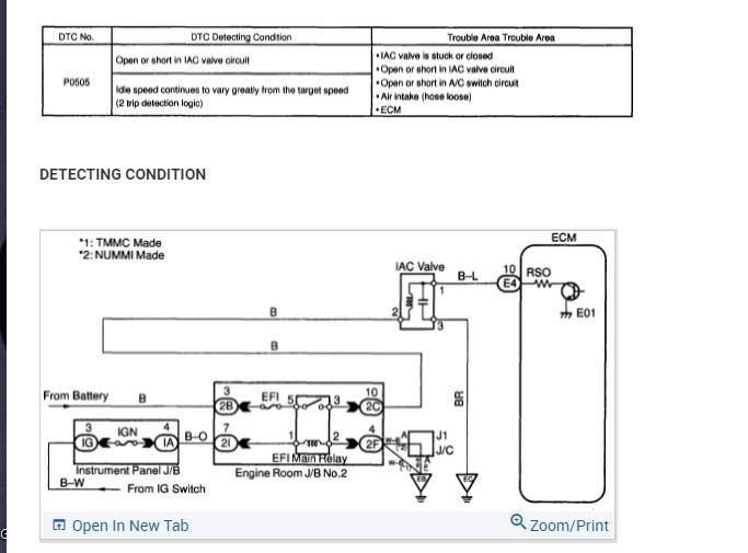

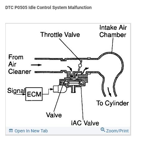

I've replaced the IAC valve, thoroughly cleaned the throttle body and can't find any vacuum leaks. Idles very high and can't figure this out. please help.
Thank you

Okay, you are going to need a scan tool to hook up to your car and monitor the IAC valve. The scan tool can command the valve to move in and out to verify that it is moving freely.
If that is working correctly, then good chance the ECM is a failure as it controls the operation of the motor.
