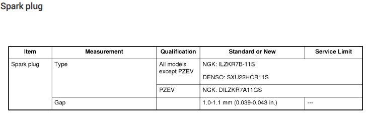

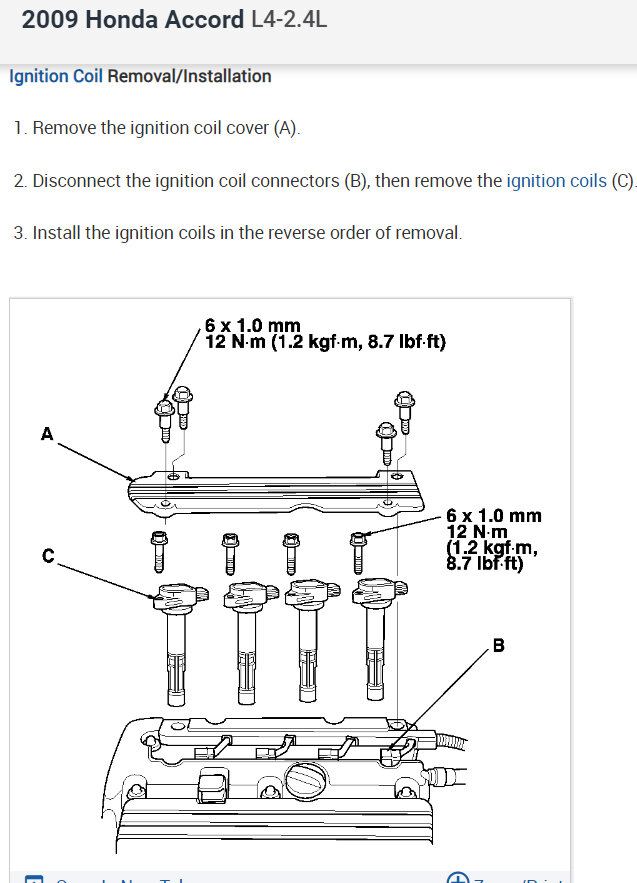

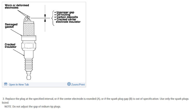

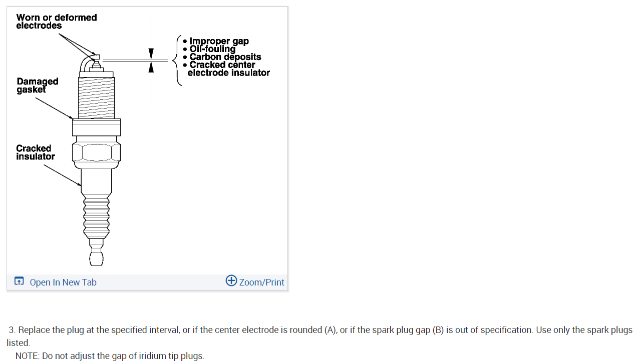

I would worry about the P0302 code first, which is a misfire code for cylinder number 2. remove the spark plug and replace it along with the ignition coil which should fix it.
Here is a guide to help with more information:
This guide should help as well:
https://www.2carpros.com/articles/how-to-change-spark-plugs
Clear the codes once the repair is completed. Check out the images (below). Please upload pictures or videos in your response of any problems so we can see what to help you with.
