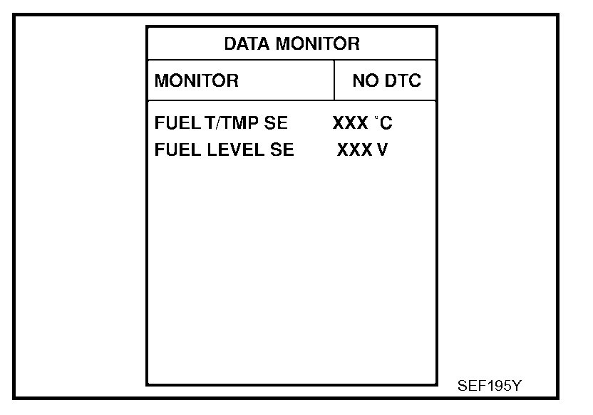

Starting off by saying gas gauge also stuck under E. So I Googled it and said possibly fuel pump and sending unit but they look good to me. I cleaned the pins but they weren’t dirty. Pump isn’t yellow from being old either so I feel like that isn’t the problem. All fuses are good as well. I have read threads about the problem and one problem said it could b the cluster messed up. I turn the car to on and I can hear the pump make a vibration noise. The needle moves up a little bit also but stays on or under E. So I don’t know if I should replace fuel pump and sending unit or cluster or I’m not sure.

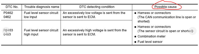

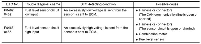

The code indicates there is low voltage from the level sensor circuit. Take a look at the attached pic. It indicates possible causes. Honestly, the code doesn't tie into the instrument cluster.

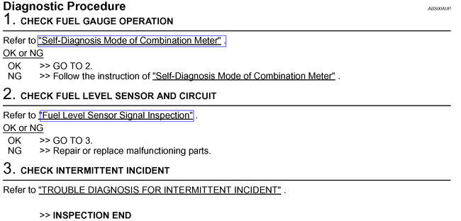

I don't know if you have a scan tool which can perform the test, but here is a diagnostic flow chart related to the code:

On Board Diagnosis Logic
NOTE: If DTC P0462 or P0463 is displayed with DTC U1000 or U1001, first perform the trouble diagnosis for DTC U1000, U1001. Refer to EC-166, "DTC U1000, U1001 CAN COMMUNICATION LINE". See: A L L Diagnostic Trouble Codes ( DTC ) > U Code Charts > Engine Control System
This diagnosis indicates the former, to detect open or short circuit malfunction.

1. Turn ignition switch ON.
pic 4
2. Select "DATA MONITOR" mode with CONSULT-II.
3. Wait at least 5 seconds.
4. If 1st trip DTC is detected, go to "Diagnostic Procedure".
pic 5

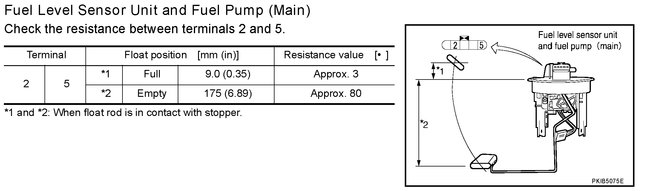

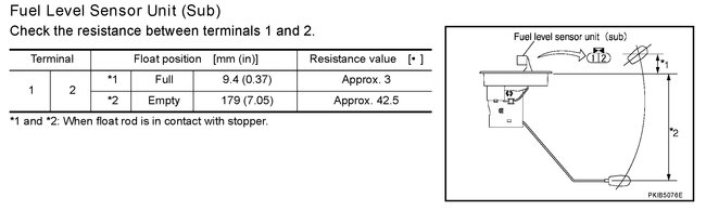

If you have a digital multi meter, the last two pics show what resistance should be based on level location. You could use that information to check the level sensor's rheostat.
Let me know if any of this helps or if you have other questions.
