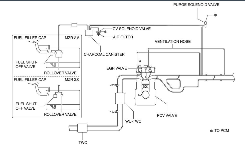

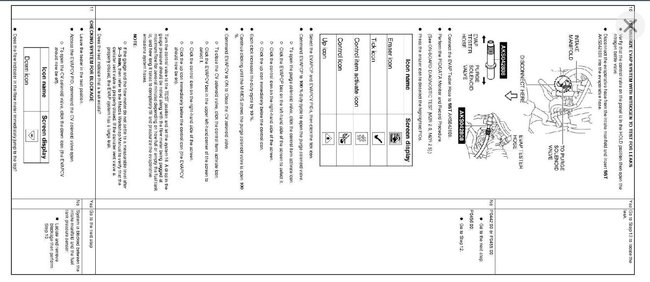

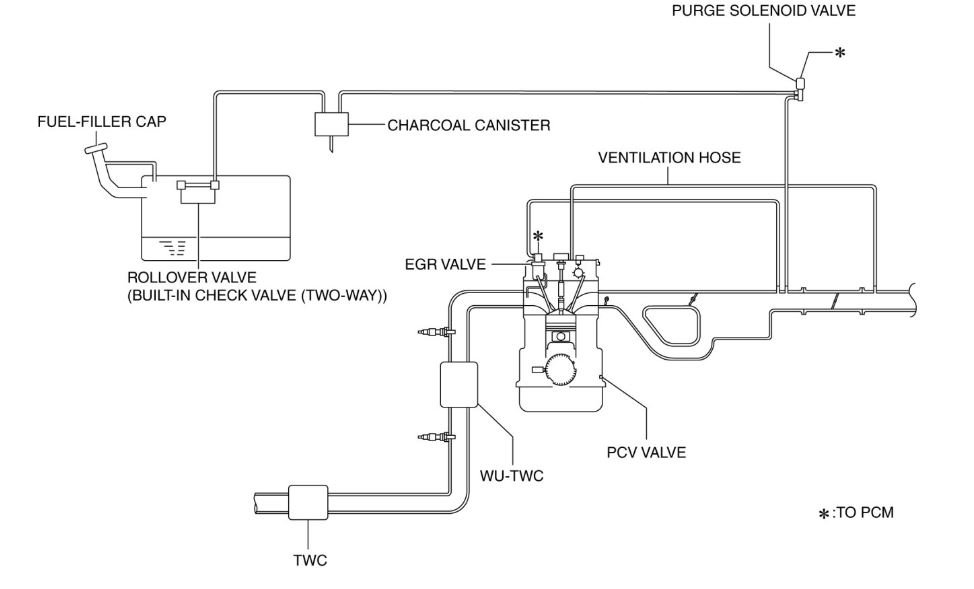

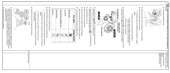

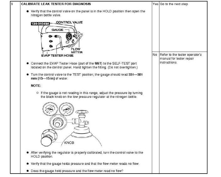

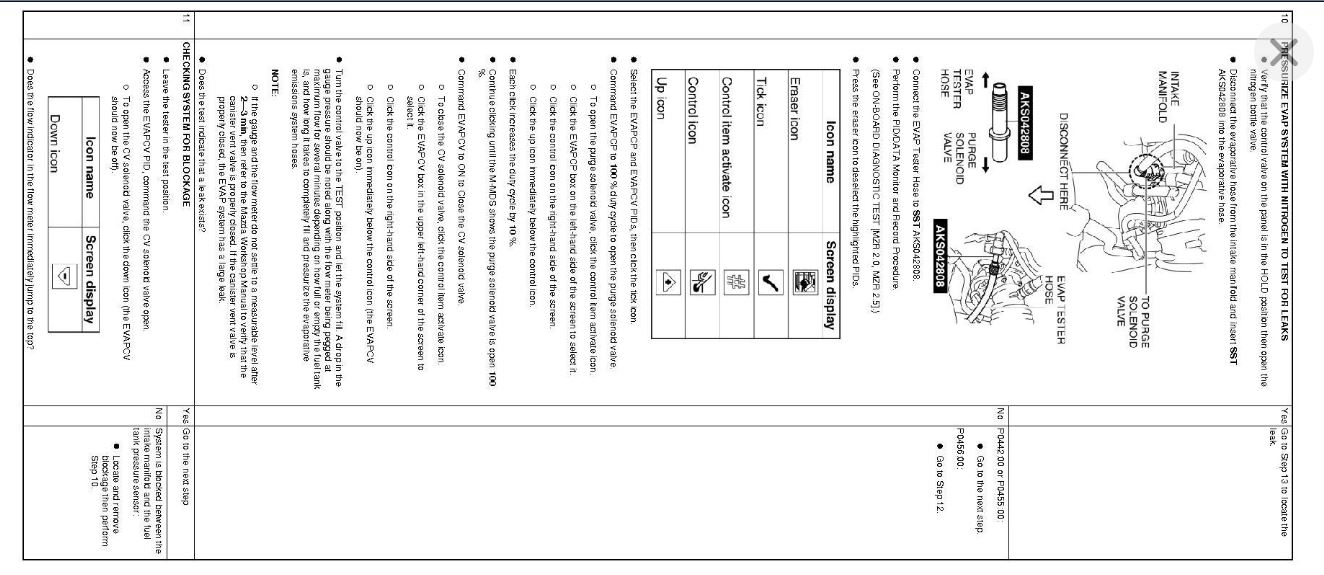

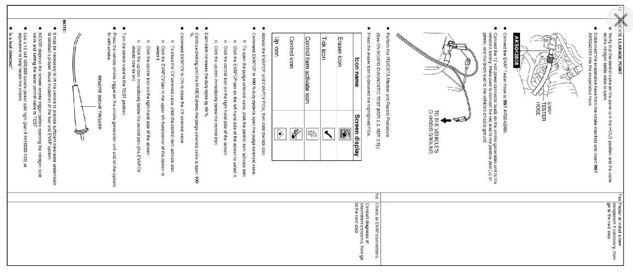

You will need a smoke machine and an advanced scan tool to manually open and close the purge valve and the vent valve for proper operation. This is something not normally done by people without the proper equipment. The leak rate is small enough that visual testing is not good enough.
Check your gas cap as I attached a TSB for you about that setting a code. If you replace the cap, use one from the manufacturer as aftermarkets are cheap but do not always work.
https://www.2carpros.com/articles/evap-system-code-repair
https://www.2carpros.com/articles/how-emission-control-systems-work

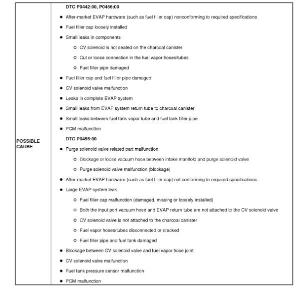

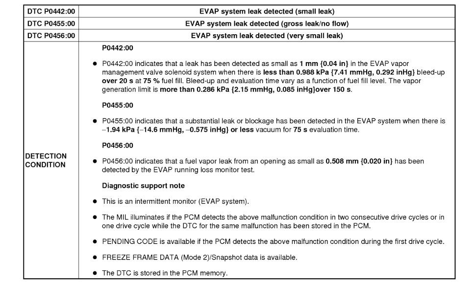

Some vehicles may exhibit the check engine light on with DTC P0456 stored in the PCM memory.
P0456: EVAP system leak detected (very small leak)
The concern is most likely the result of the customer not getting the fuel cap completely closed after fueling the vehicle. This causes a small fuel vapor leak and turns DTC P0456 on.

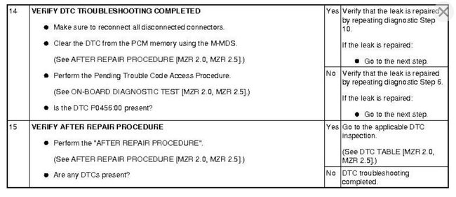

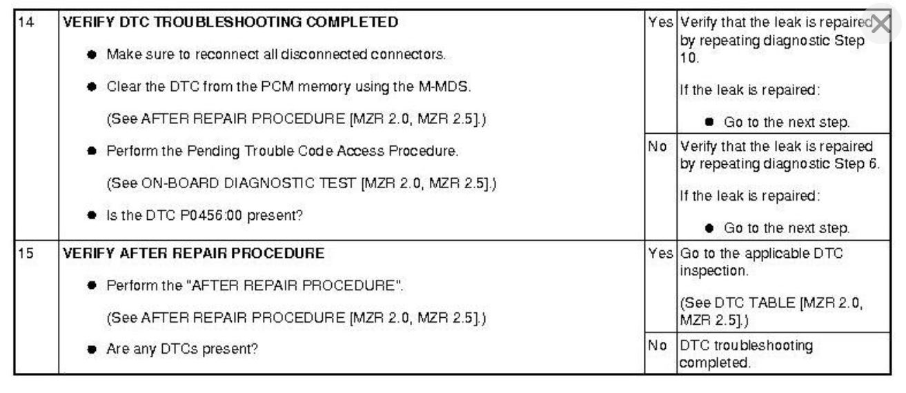

1.Verify the customer concern (and that DTC P0456 is stored in the PCM memory).

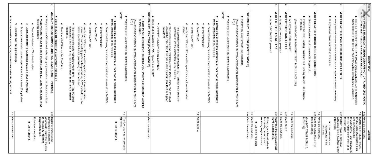

2.Perform the workshop manual diagnosis procedures for DTC P0456.
If a leak is detected, repair it according to the instructions on MS3 online or the Workshop Manual.
If no leak is detected, the most probable cause is the fuel cap was not completely sealed (B).
