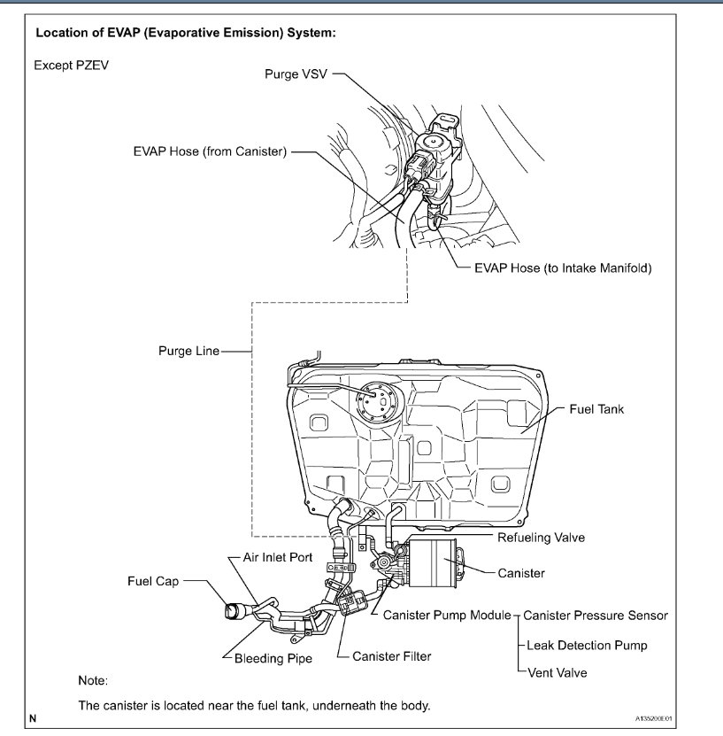

Check engine light on, code P0453

I have a CEL on my dash. The diagnostic code shows [P0453 EVAP System Pressure Sensor/Switch High Input]. for the life of me I cannot find that sensor. Any help would be highly appreciated.

It looks like it is on the charcoal canister. here is a diagram to show the exact location in the images below. Check out the diagrams (below). Please let us know if you need anything else to get the problem fixed.
