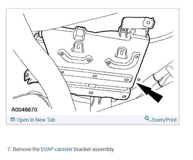

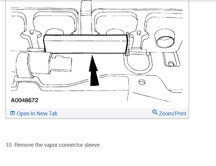

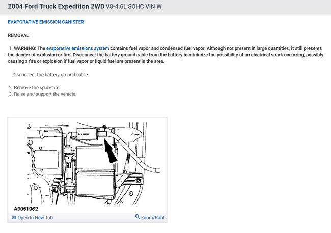

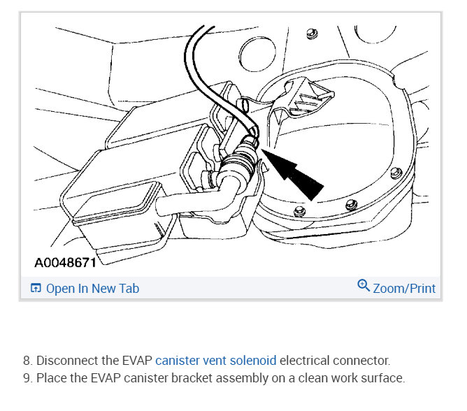

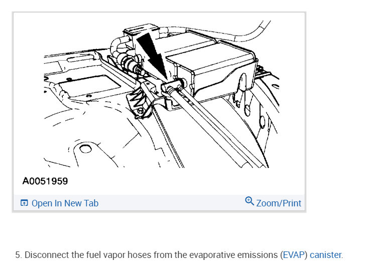

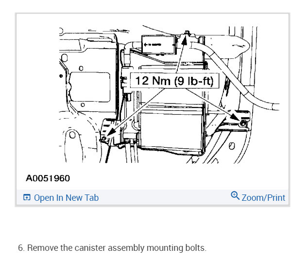

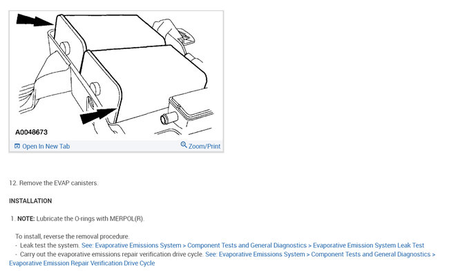

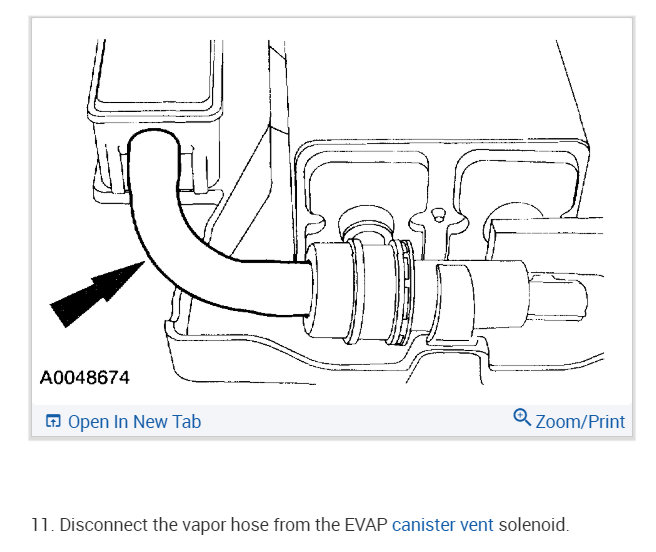

Any ideas on how to fix it? I've already replaced the vapor canister solenoid because that was the main resolution for that code, but it didn't fix it. Help please!
Dec 6, 2019 at 5:09 AM
  • 55,808 POSTS
The EVAP system is sealed if there is any kinds of leak it will show this codes. here is a video of an EVAP repair on a similar car which will apply to yours as well:
https://youtu.be/iH92vcUWJzs
It can be the charcoal canister is leaking as well. Check out the diagrams (below). Please let us know what you find. We are interested to see what it is.
Dec 8, 2019 at 5:51 AM
