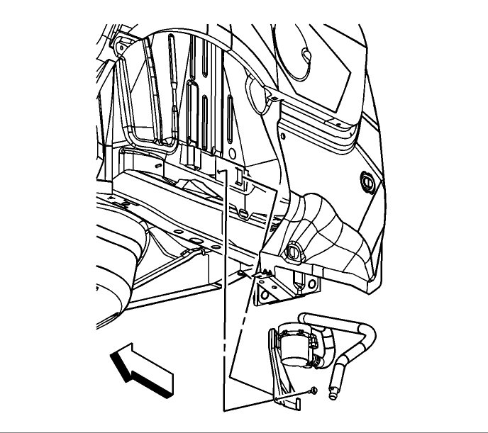

Code P0449 came on. I was told to replace the solenoid vent canister. i did, reset the code and it popped right back up. Tried resetting it a few times and it kept returning. Tested the fuse in passenger compartment there is continuity. what can it be? A break in the wire?

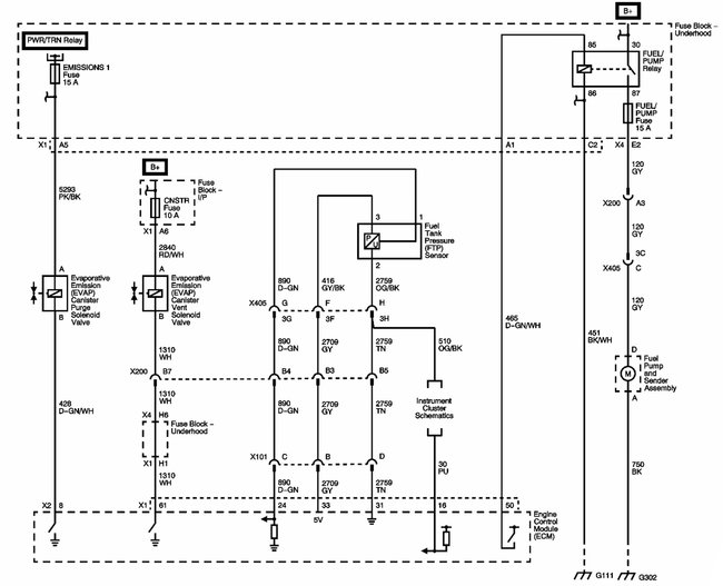

Broken wire, bad connection are a couple of things, or a leak between the solenoid and the charcoal canister.

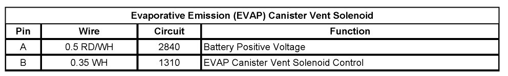

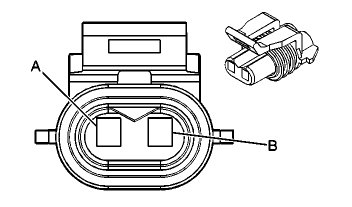

To see if it's a bad wire you need to check the wires at the valve. There will be Red with white stripe and one all white.
The Red/White wire should have battery voltage. The white wire is a computer controlled ground. If you use a pin to connect to the white wire, you should hear the solenoid click on/off as you touch a jumper connected to the pin to ground. If you hear that then the power side is OK.
To check the control side wire, the easy way is to use a good scan tool and turn the valve on/off. The harder way is to find that wire at the PCM and apply ground at that pin and listen for the solenoid to click.
Also check that there is power at the canstr fuse in the fuse box.
