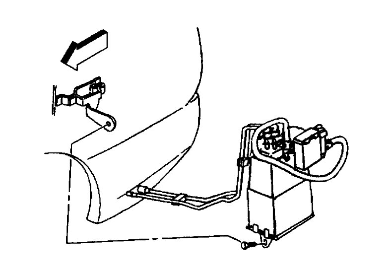

Keep in mind, the code indicates a problem with the EVAP vent system. The vent valve is under the vehicle near the fuel tank. I have attached a picture of what to look for. Also, here are the directions for replacement if you decide this is the issue.
____________________________
REMOVAL PROCEDURE
1. Raise the vehicle. Refer to Lifting and Jacking the Vehicle in General Information.
2. Bend the EVAP vent valve retaining tab.
3. Remove the valve from the EVAP vent valve bracket.
4. Disconnect the EVAP vent valve electrical connector.
5. Loosen the vent hose clamp and remove the vent hose from the EVAP vent valve.
6. Remove the EVAP vent valve from the vehicle.
INSTALLATION PROCEDURE
1. Connect the vent hose to the EVAP canister vent valve and tighten the hose clamp.
2. Connect the EVAP vent valve electrical connector.
3. Install the EVAP vent valve to the EVAP vent valve bracket.
4. Bend the EVAP vent valve retaining tap.
5. Lower the vehicle.

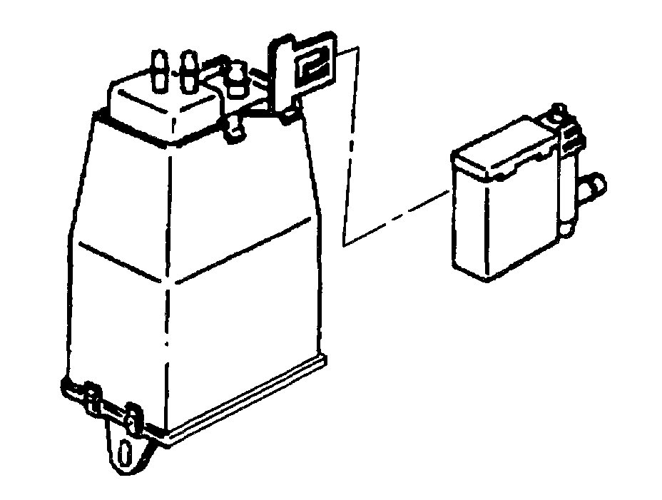

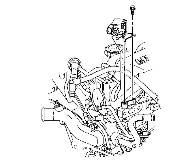

I tried YouTube to find too. Can you show any pictures or tell me exactly where this whole evap circuit control unit would be? I have only found one piece of information. That indicates it is supposed to be right behind one of the tires (back passenger side) under the car. On my 2001 Lumina I do not see anything there that looks like it.
Nov 26, 2018 at 2:14 PM
Good morning,
I attached pictures of the canister and the purge valve for you to view.
Joe gave you the view of the vent valve already.
REMOVAL PROCEDURE
1. Turn OFF the ignition.
2. Raise the vehicle. Refer to Lifting and Jacking the Vehicle in General Information.
3. Remove the driver side rear wheel and housing liner.
4. Remove the hoses from canister. Mark the hoses to ensure correct installation on new canister.
IMPORTANT: Inspect the canister hoses for damage or deterioration. Refer to Emission Hose Routing Diagram for proper routing of canister hoses. When replacing the lines, use the correct replacement part.
5. Remove the canister and latch assembly from the canister bracket.
6. Release the latch securing the canister.
7. Remove the canister.
REMOVAL PROCEDURE
2. Note the position of the EVAP hoses for installation.
3. Disconnect the electrical connector and hoses from the EVAP canister purge valve.
4. Remove the bolt from the valve mounting bracket.
5. Remove the EVAP vent valve.
Nov 26, 2018 at 8:21 PM
TRA
  • 41 POSTS
So driver's side then instead. Okay, thanks.
