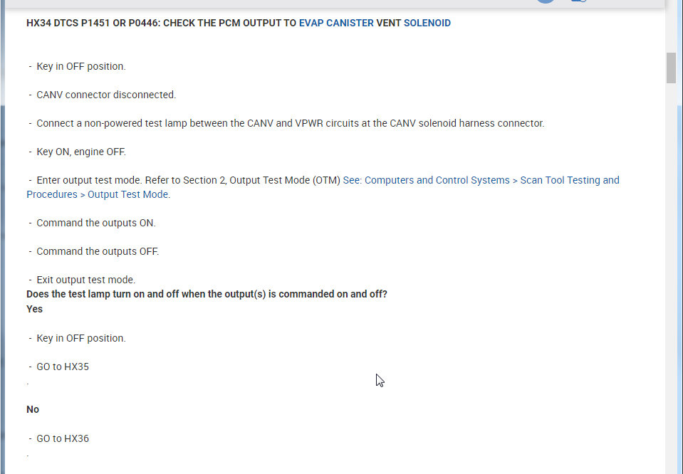

I found the ground switching wire at the plug right by the vent solenoid was broken, I made a solder repair, tested the plug and now have battery voltage when the key is on. Cleared the code, but still immediately get the code returned as soon as the truck is started. I have a Solus Ultra, when I go in to output controls on the Solus to toggle the canister vent solenoid on and off, it never loses battery voltage until the key is off. I know that the ground is the switching wire, but something is keeping it from switching off with the scanner and when the PCM is doing the initial checks upon startup. not too sure what to do next...
Feb 20, 2021 at 11:36 PM

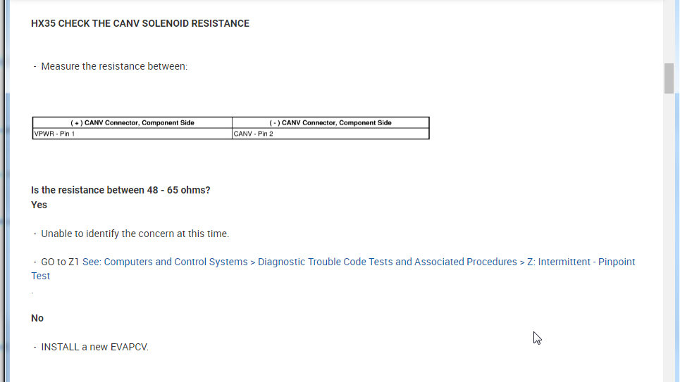

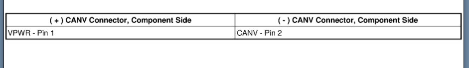

I am attaching the testing that we need to run through in order to find out what the issue is. There are only a couple steps so let's run through this and see what happens.
Here is a guide that will help with this type of testing:
Let me know if you have questions. Thanks
