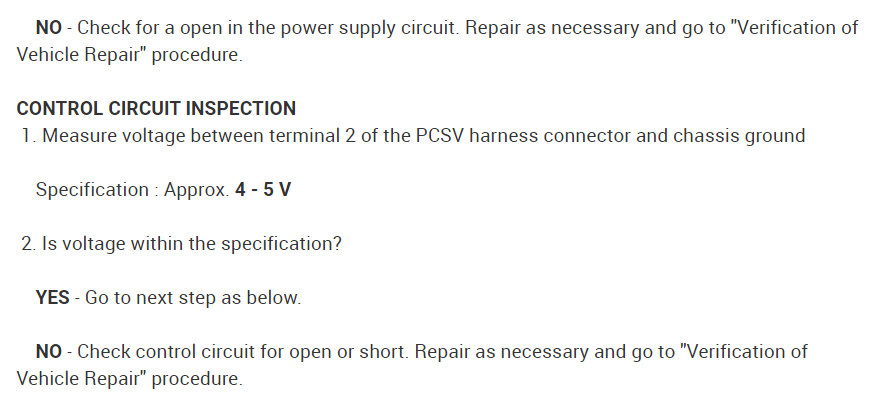

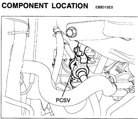

I just change my purge valve. And a couple weeks later light came back on with p0445 is it possible that the bottom hose on the purge valve has been damaged during the valve change? I had a lot of trouble getting the clamp to loosen. Also there is a PCV hose that leads to the top of engine under the valve cover runs across the top this looks like it's damaged, but i'm not sure what its actually called. I do not work on cars but have no choice since i had an accident in 2019 and put my front end back together with no experience. Winging it with help from others occasionally.

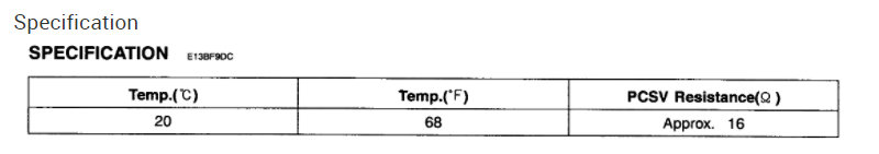

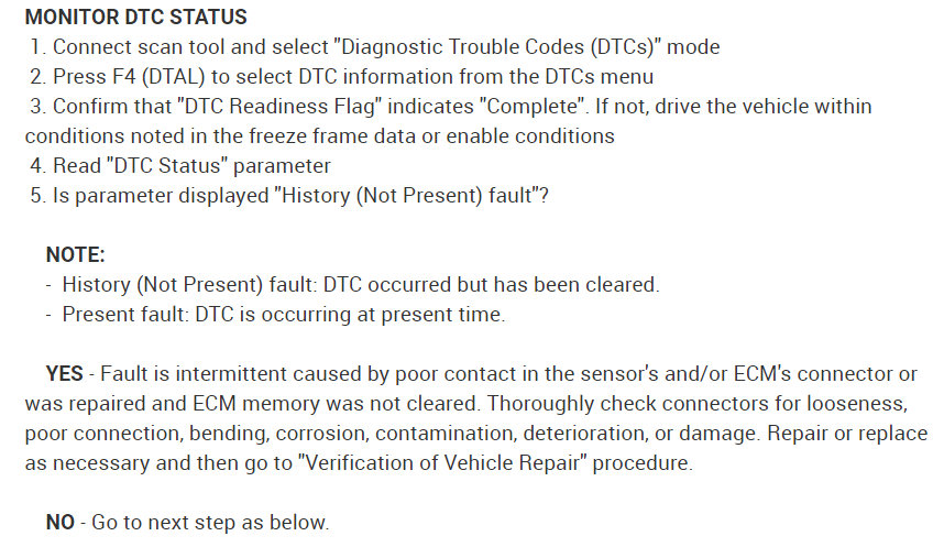

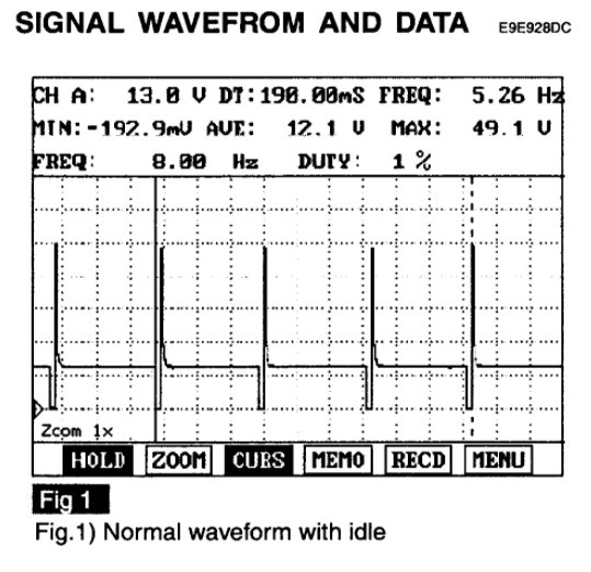

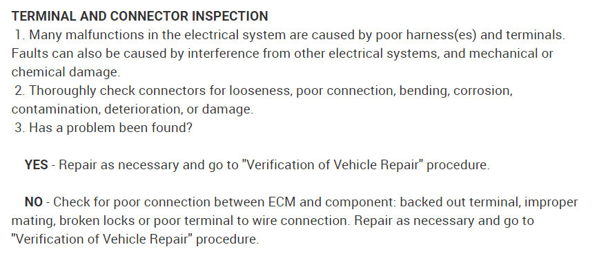

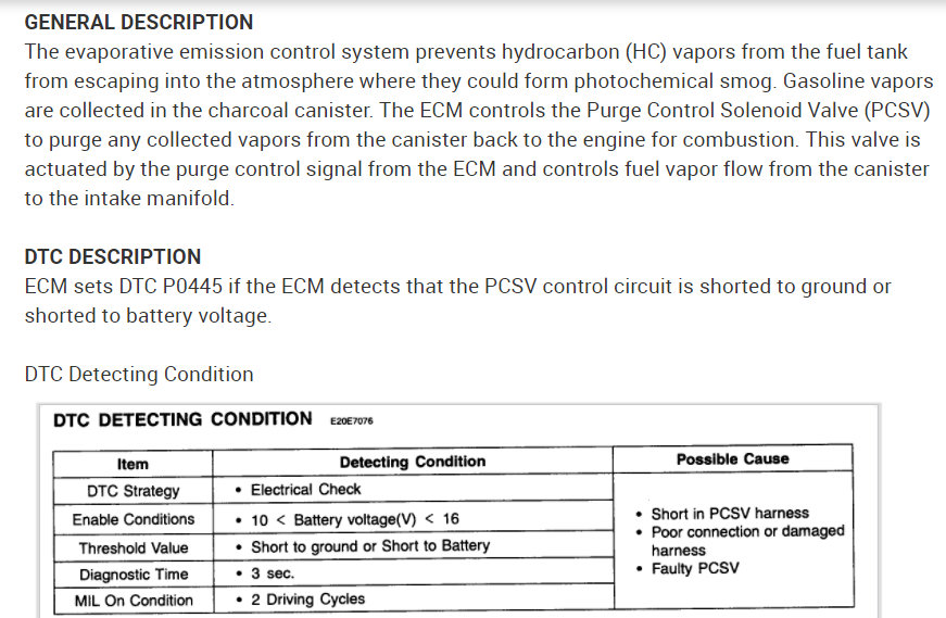

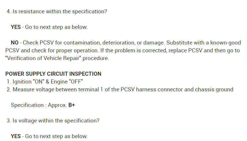

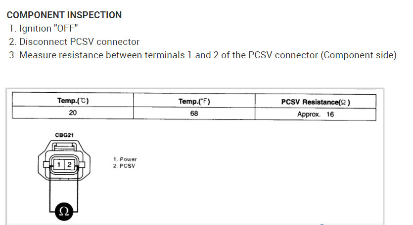

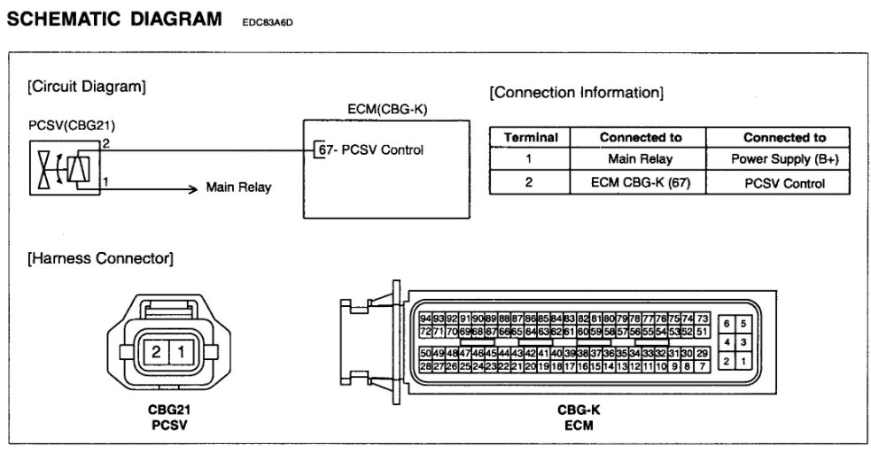

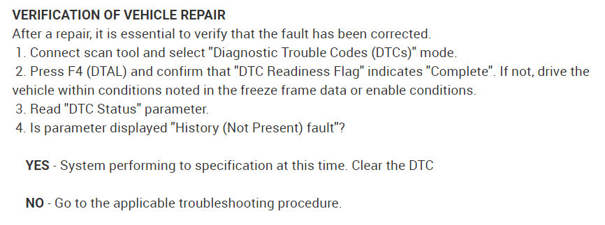

I've attached picture diagnostic steps your your car below relating to your code P0445. Get back to us is with what you find. Hope this helps and thanks for using 2CarPros.

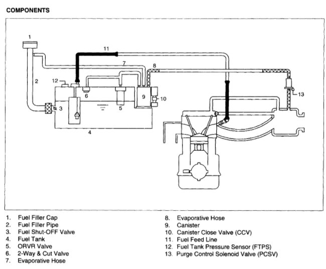

If you can use your cell phone to upload images of the hoses you are speaking of and upload here. That can help us identify them better. I've attached a picture diagram of the EVAP system hoses and posted below. If you can match the hoses from the diagram that can help us as well. Get back to us and we'll go from there. Hope this helps and thanks again for using 2CarPros.

So the tube that is attached to the bottom of number 13. Is this just a PVC hose? Local auto parts stores don't seem to carry this. And the other hose is not on this diagram but o believe its the crankcase breather hose.

Yes, the bottom #13 lower hose is a plastic PVC hose for pressure and emissions. I will find out if you can buy the line in bulk and cut to fit as opposed to buying a preformed line from the dealership. Can you take a picture of the crankcase breather hose you are speaking of ? Take a picture of this and upload here so we can be on the same page. Get back to us and we'll go from there. Hope this helps and thanks again for using 2CarPros.
