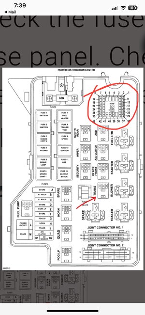

Yes, there is a transmission control relay I would swap out and then clear the codes, this relay controls the transmission and EVAP systems.
P0443 - EVAP Purge Solenoid Circuit
P0753 - 3-4 Shift Solenoid Circuit (Transmission)
P1765 - Trans 12 Volt Supply Relay Control Circuit
Here is the location of the relay and check the fuse#1 as well in the same fuse panel. Check out the images (below). Please let us know what happens.

So, I just tested the relay and it’s good. Also, fuse #1 (labeled battery) is good.
I noticed the screw holding this big plug was loose, so I tightened it. Here’s a photo of what I’m talking about.
May 15, 2025 at 1:13 AM
  • 55,797 POSTS
Yep, that can do it, I would remove the connector completely to see if any of the connections are burned/corroded. Also, a relay can click but the contacts inside may not work, I would swap it out just in case. Let me know :)
