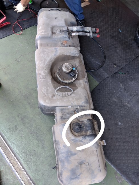

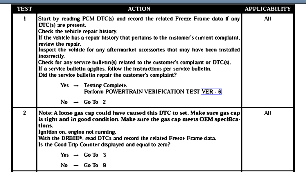

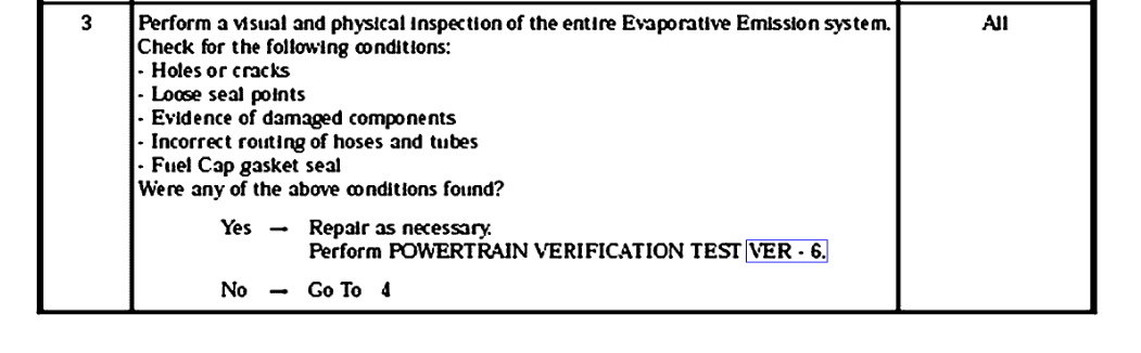

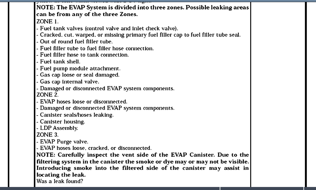

P0442 code small evap leak
2001 DODGE VAN
96,500 MILES • 5.9L • V8 • 2WD • AUTOMATIC
NHEBERT1987
Mechanic advised leak coming from circled area, any way to repair? Have been unable to source replacement fuel tank.
May 11, 2019 at 2:59 PM
SCGRANTURISMO
  • 4,897 POSTS

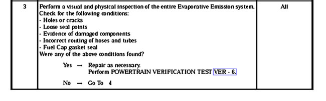

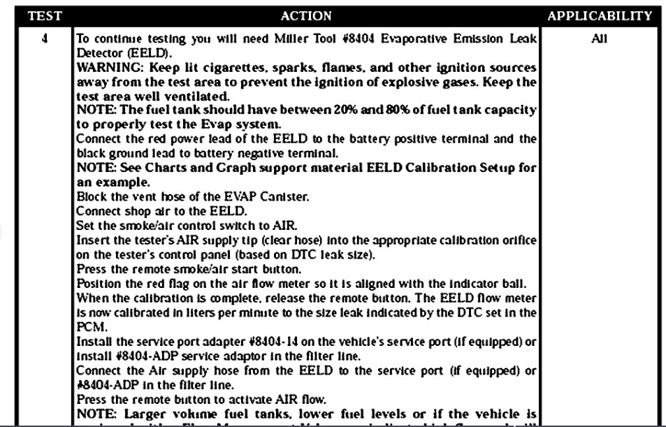

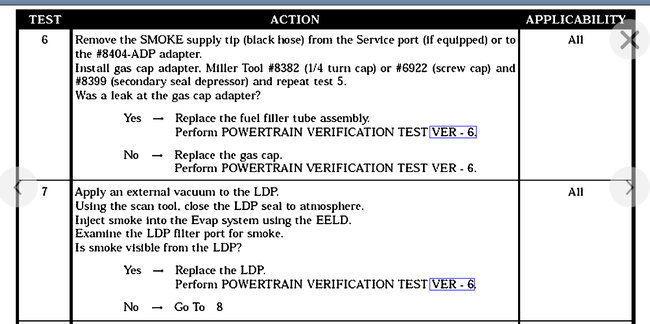

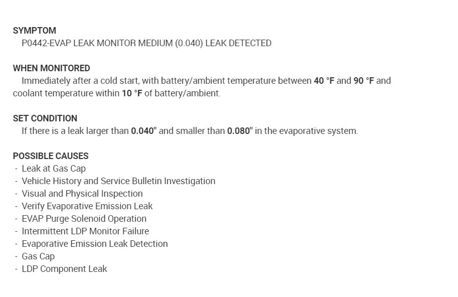

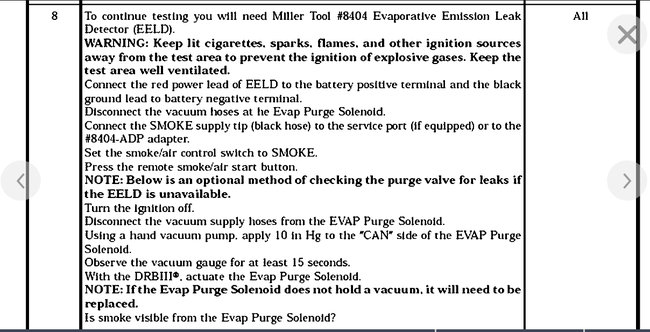

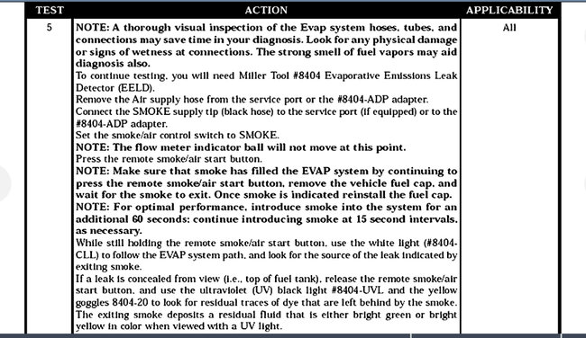

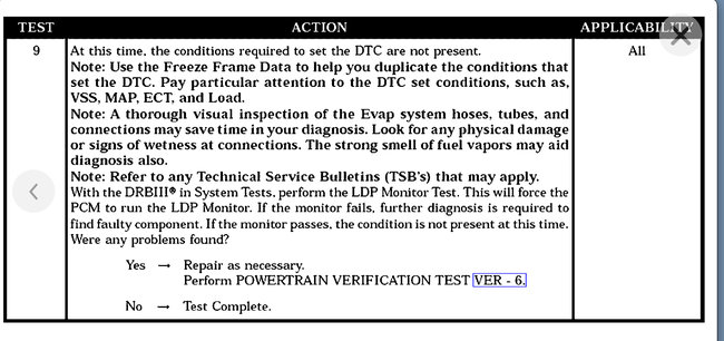

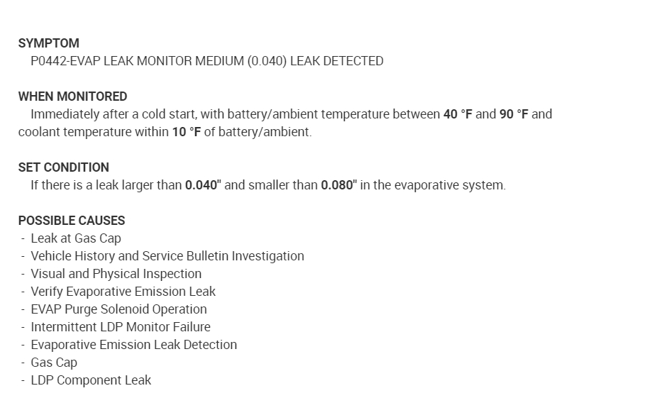

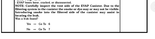

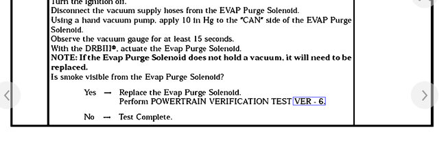

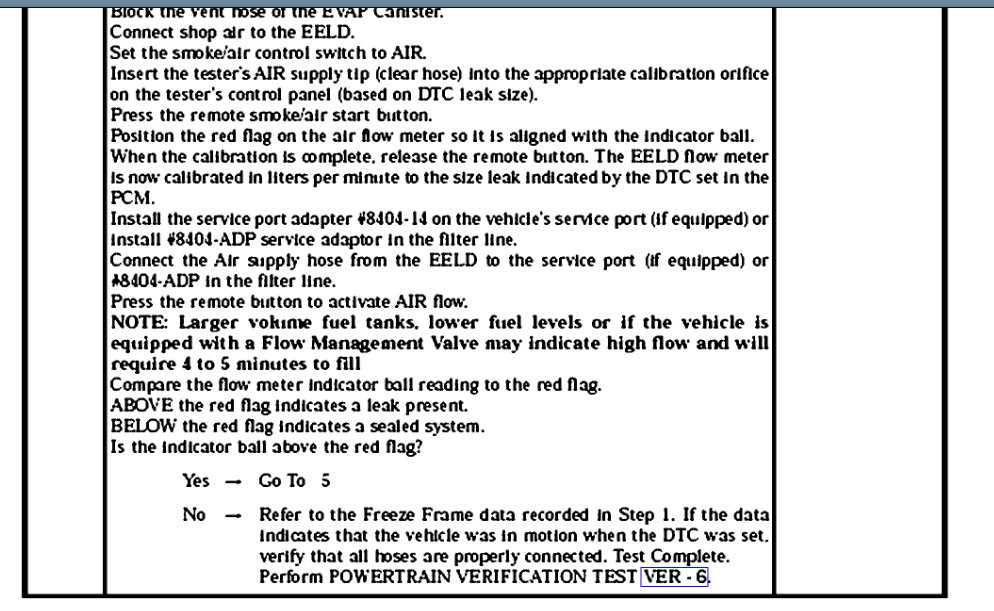

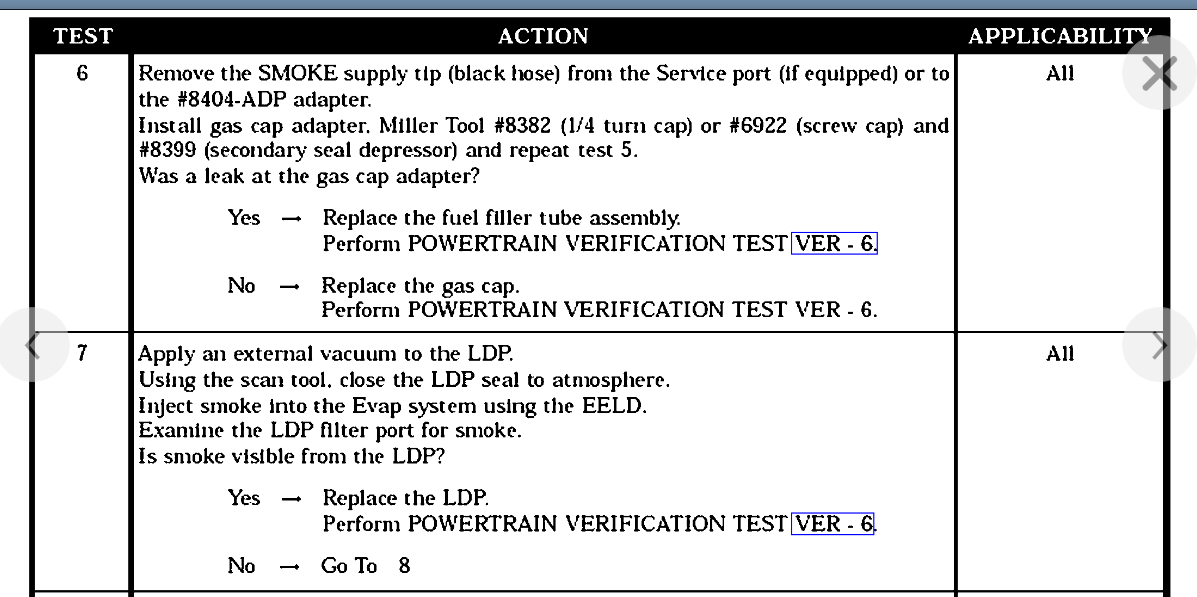

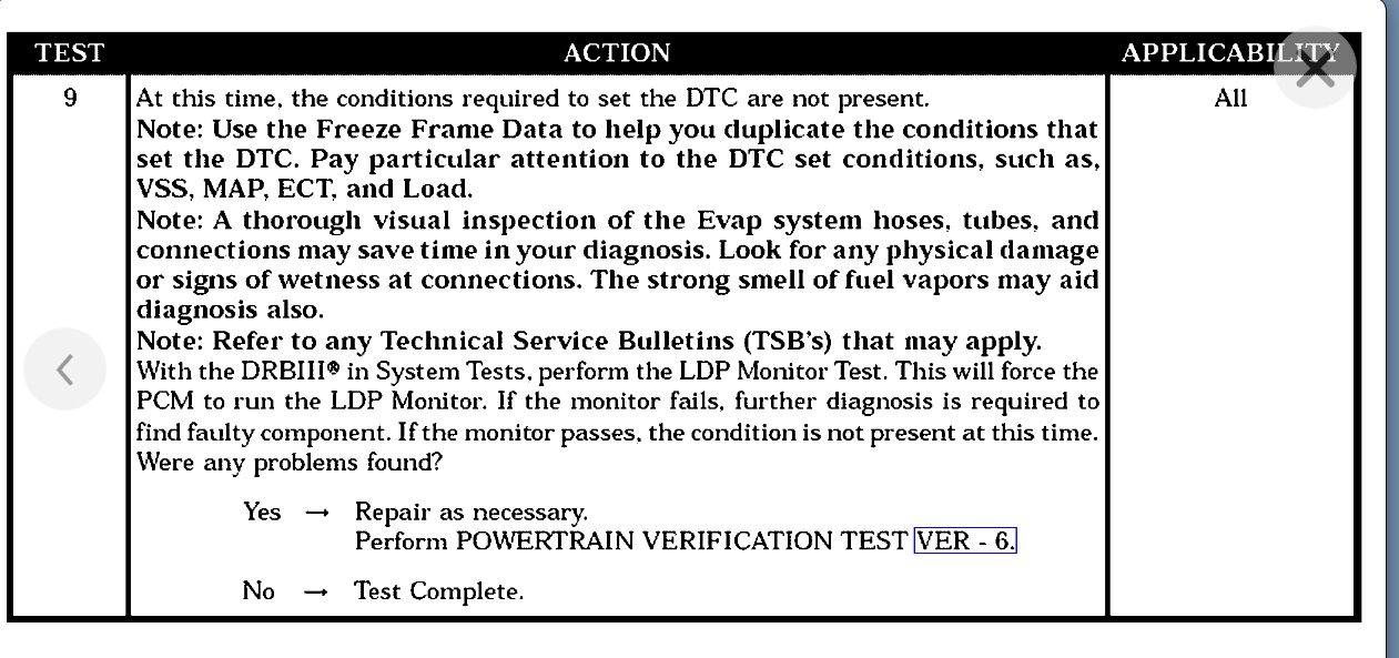

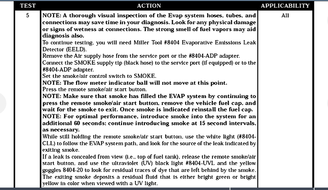

I have include for you in the diagrams down below a factory troubleshooting diagnostic flowchart. It will pinpoint down your vehicle's EVAP leak. Please go through it and get back to us with what you are able to find out please.
Thanks,
Alex
