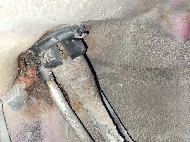

Found the leak. That is where the pipe that connects to the gas inlet goes to the tank. Is it at all possible to fix that? It's very loose as well. Do I need to replace the whole tank?

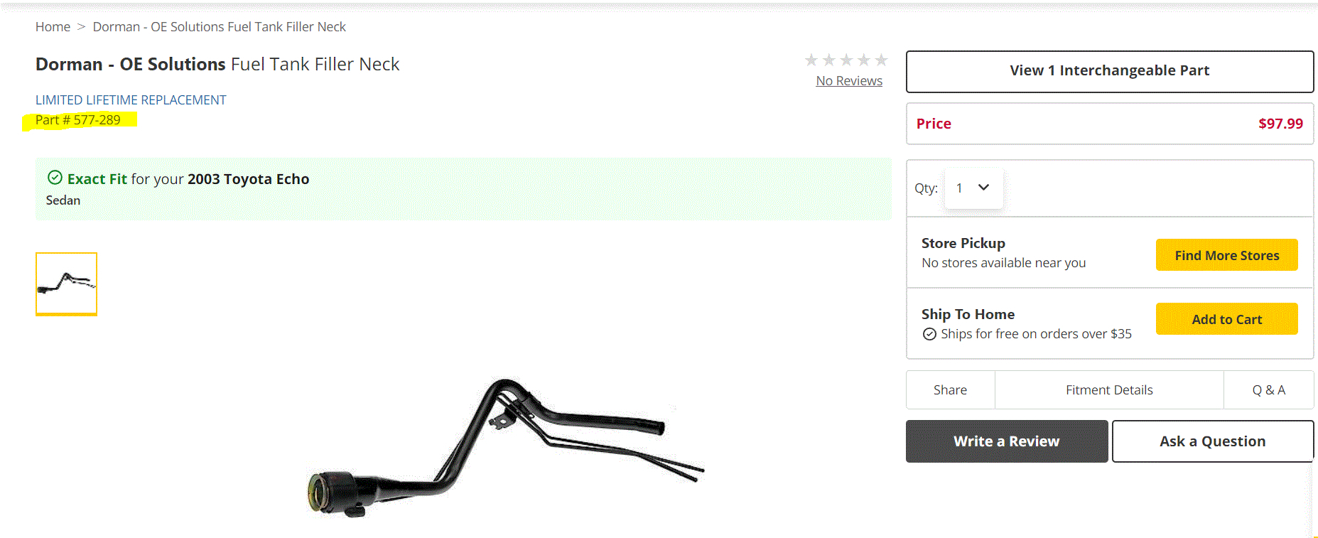

If the fuel inlet is rusted through, that is the likely problem. You can replace just the fuel filler neck. If you look below, I provided a pic of it for you. I highlighted the Dorman part number. Chances are you can find it for less money.
Let me know if that helps.
Take care.
See pic below.

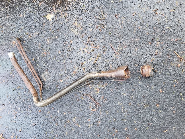

It looks like you were right. Thanks for that. The filler neck was completely eroded into two parts. I ran the smoke test after replacing it and I no longer see any leak. Thanks again.
Apr 9, 2022 at 4:12 AM
  • 110,251 POSTS
Wow, that does look bad. If you have a scan tool, delete the codes and see if they return. I suspect they won't. However, if anything changes or I can help in any way, let me know.

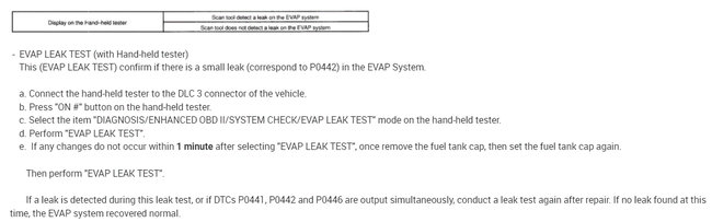

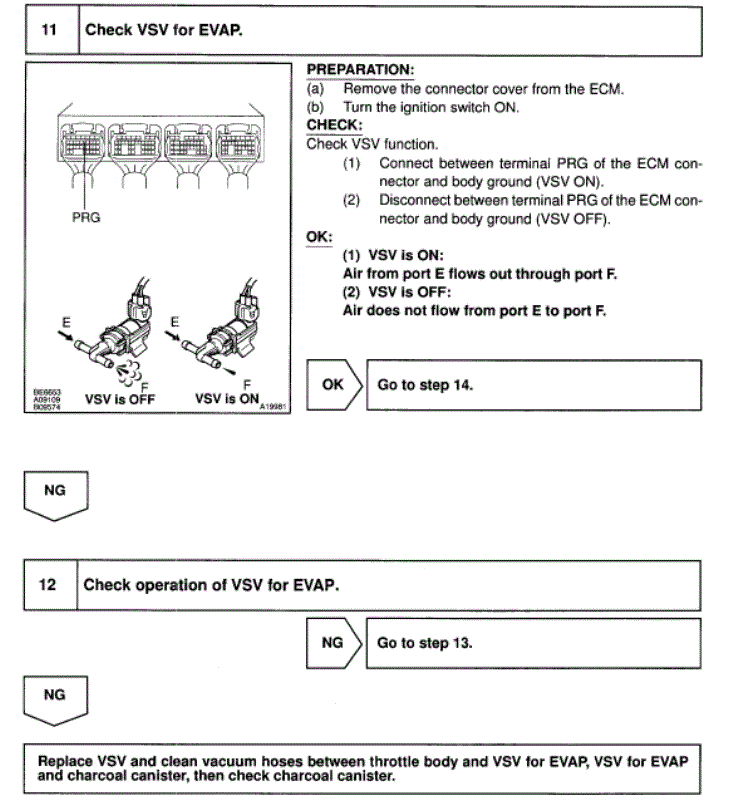

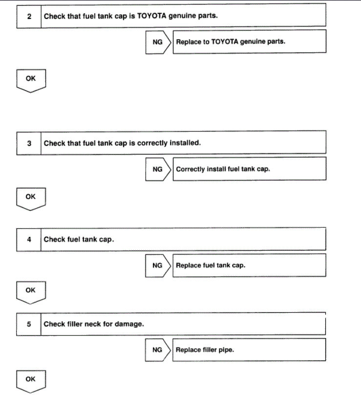

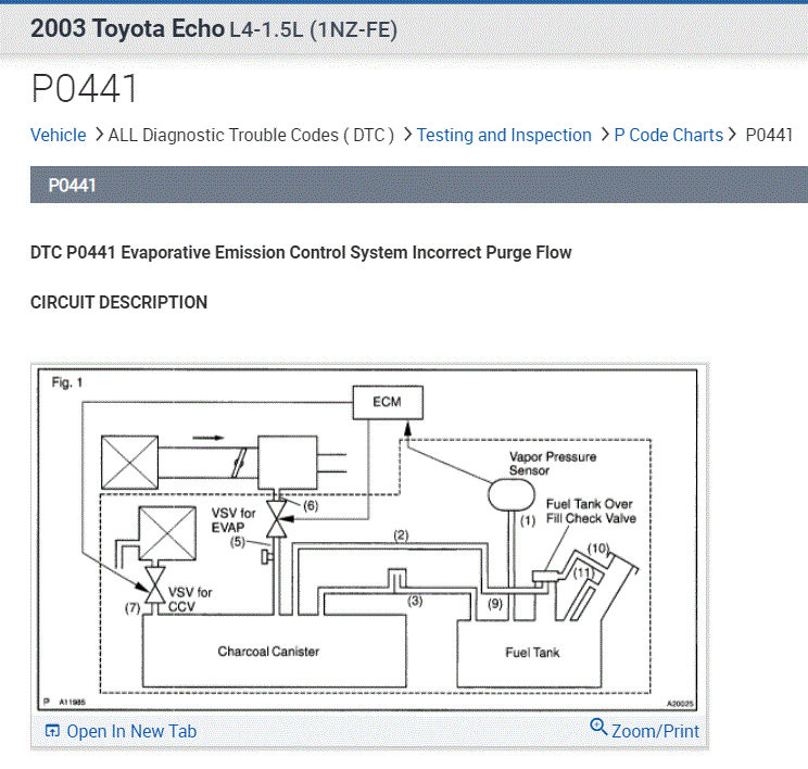

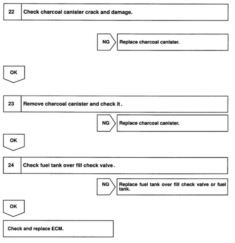

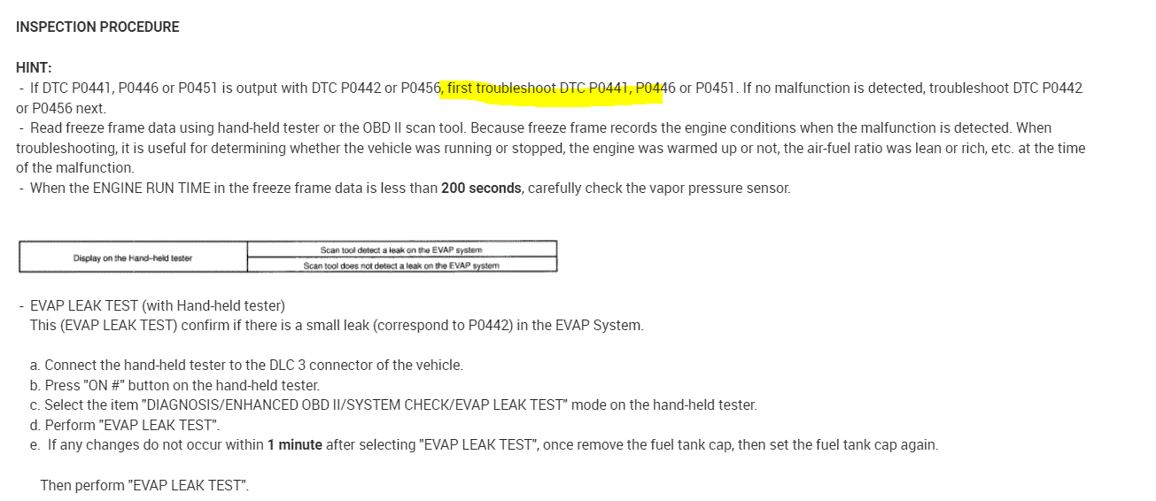

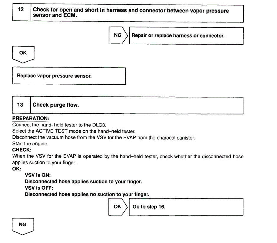

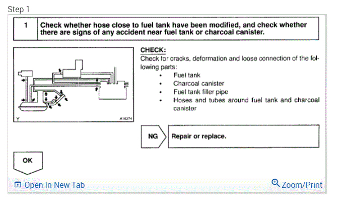

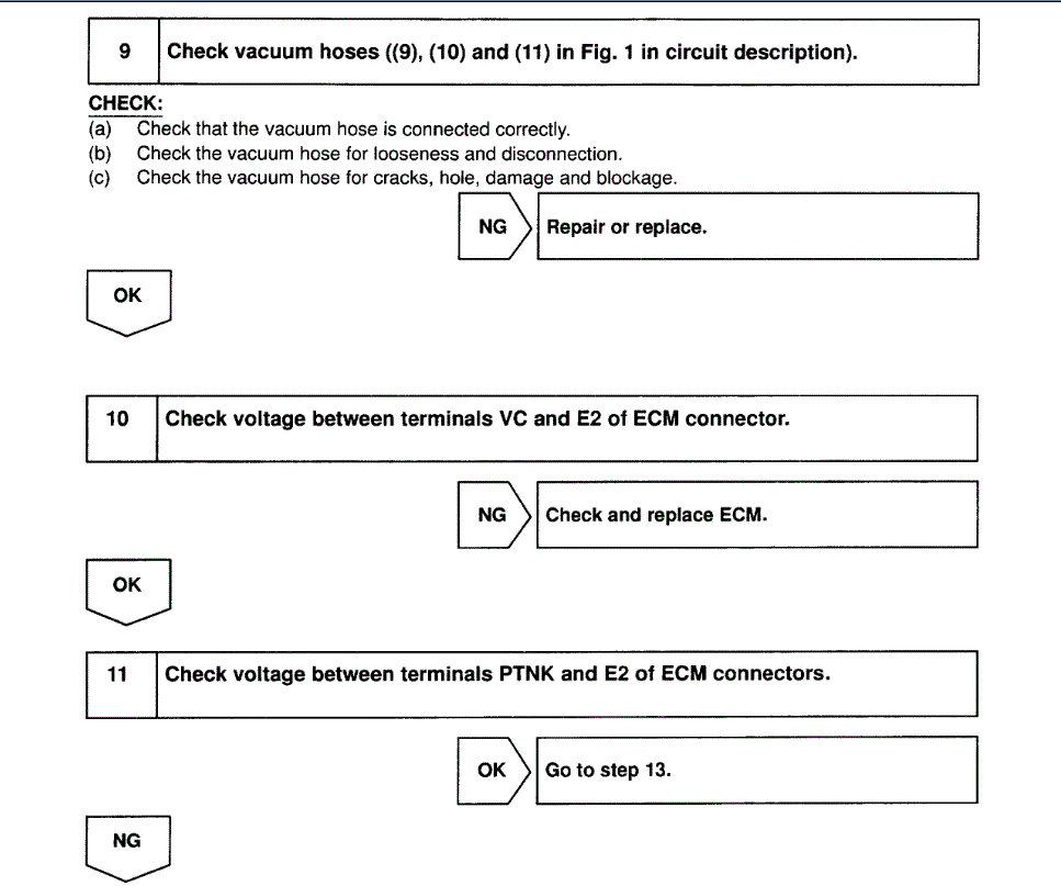

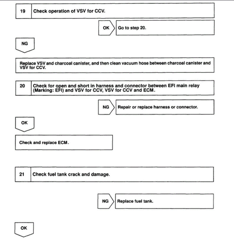

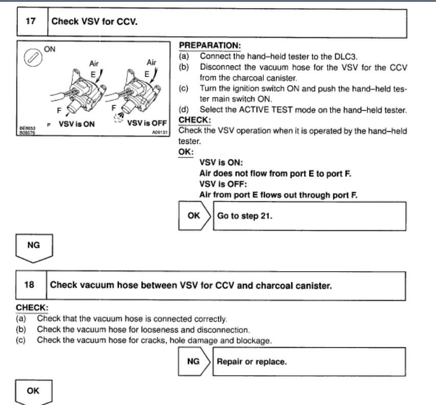

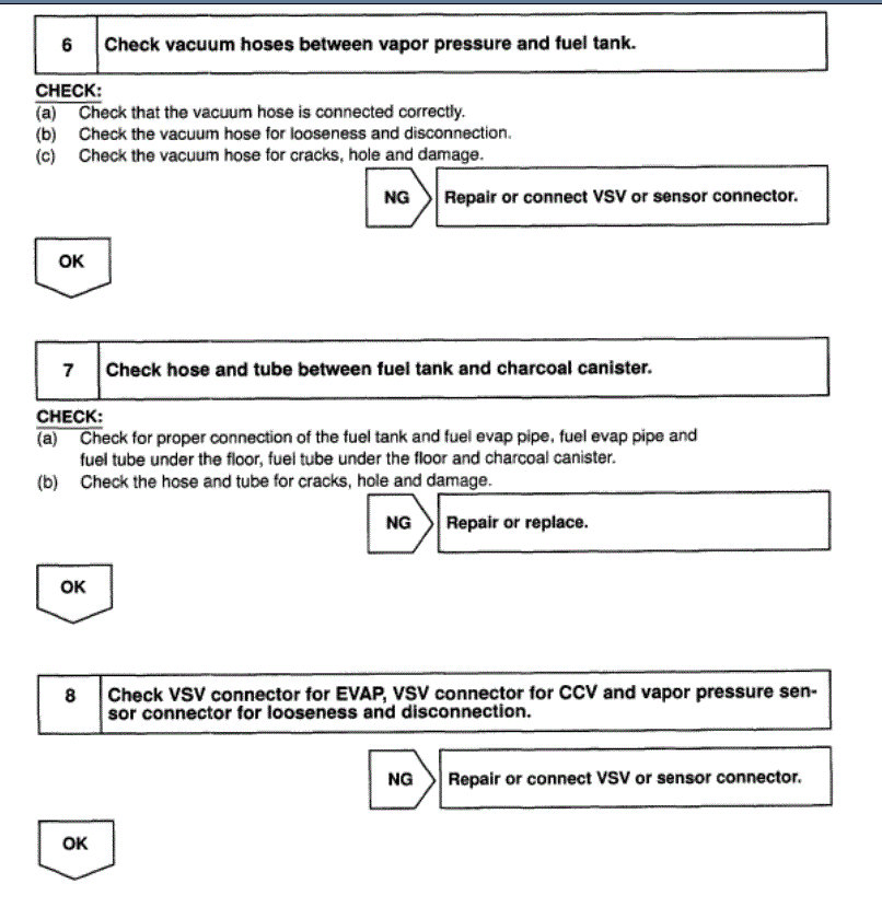

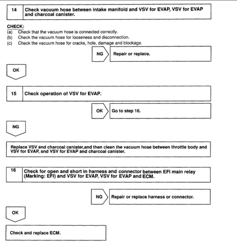

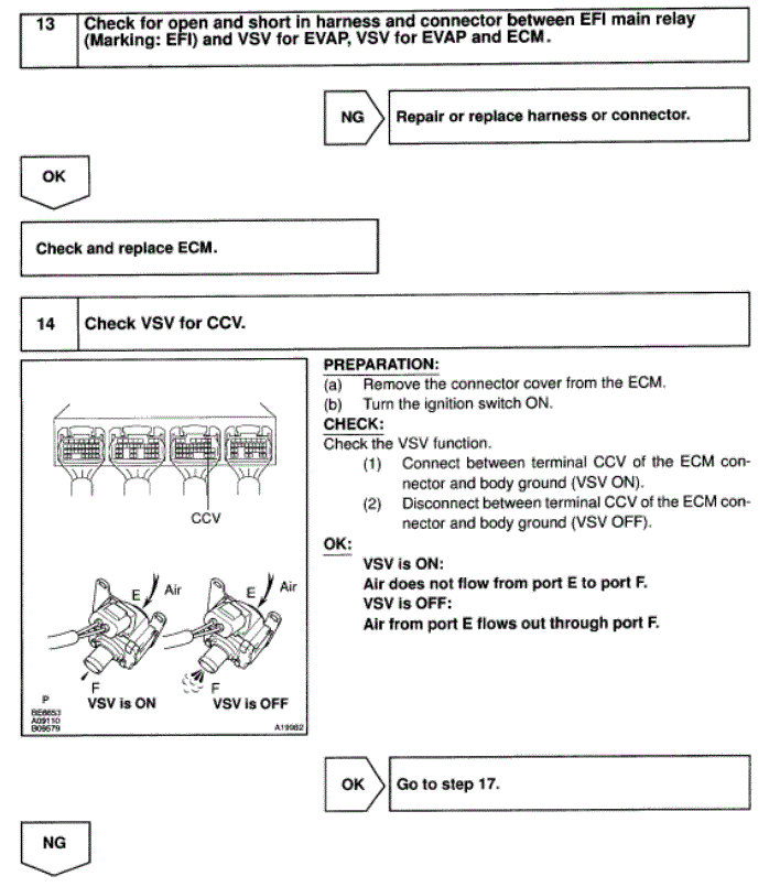

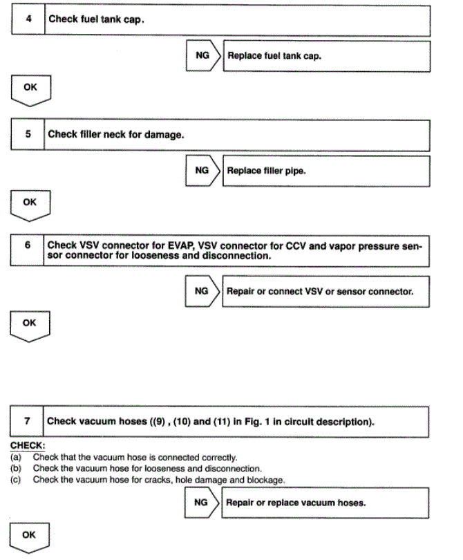

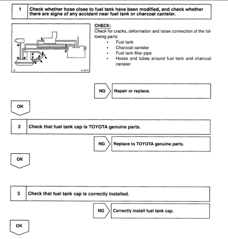

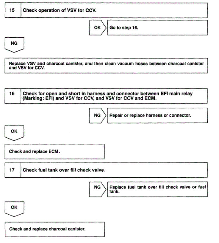

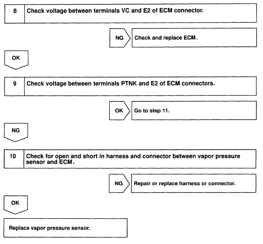

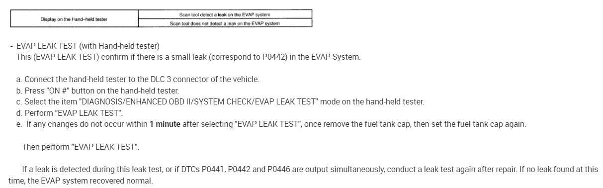

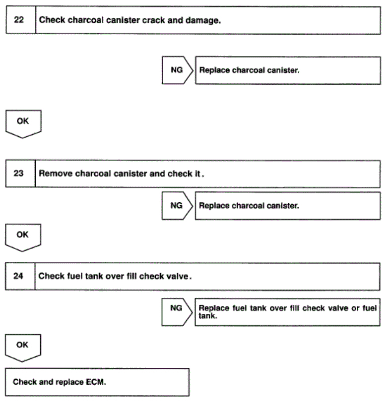

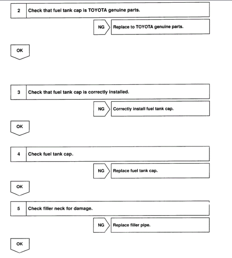

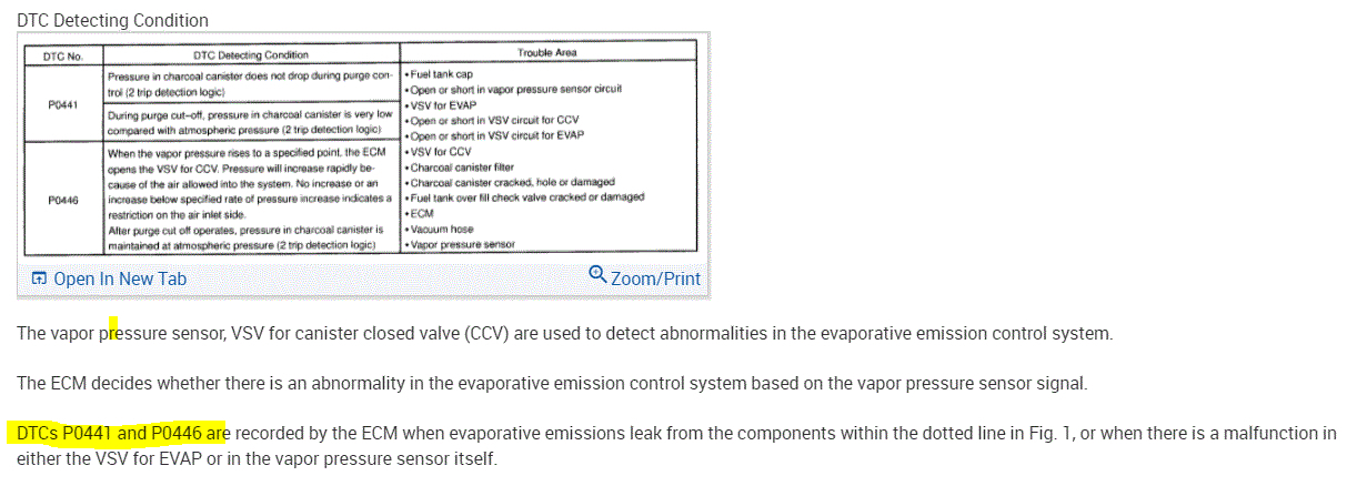

Okay. That leads to a new list of diagnostics. Since the 441 and 446 are both present, we need to start there. The 442 isn't setting the light.
I have attached the extensive diagnostics below. I am hoping you won't need to go through all of them. Hopefully, the problem will present itself early in the procedure.
You will need a scanner that can communicate with the PCM.
Take a look through them. Don't be overwhelmed.
31
Let me know your thoughts.

Thanks for uploading those for me. I was worried I would need some better equipment. My scanner is just a simple code reader. I've got that code reader and a multimeter. I can do the smoke test and I have test leads. That's the extent of my diagnostic tools. Of course, I can rent whatever the auto parts store has available, but I don't think they have the good scanners. Looks like I'll have to take it to a pro. Thank you again.

So, I took it to a mechanic. There was a leak in the vapor canister. So, I'm going to replace that. My smoke test didn't show that leak because it doesn't pressurize the system. My question now is, would that possibly cause the stalling or near stalling that I described in my original post or do you think that is a separate issue?
Apr 20, 2022 at 9:54 AM
  • 110,251 POSTS
That produces a vacuum-related issue and certainly can cause a rough idle and stalling.
Replace it since we know it's bad, and let's see how it runs.
