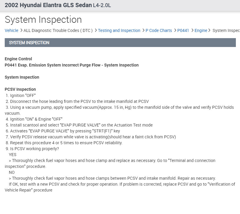

I'm getting a P0441 incorrect purge flow code and I was wondering what procedures I could take to diagnose my problem. Whenever I get gas, it always takes a huge amount of time as the pump keeps clicking off. When I try to start my car after finally filling it up it drops to almost no RPMs and stalls when hitting the gas for the first time. After that it's fine. I did notice however that it takes about five minutes for the gauge to correctly display the amount of gas I put in. Any help will be appreciated.
Jun 14, 2022 at 11:04 AM
SQM
  • 6,383 POSTS

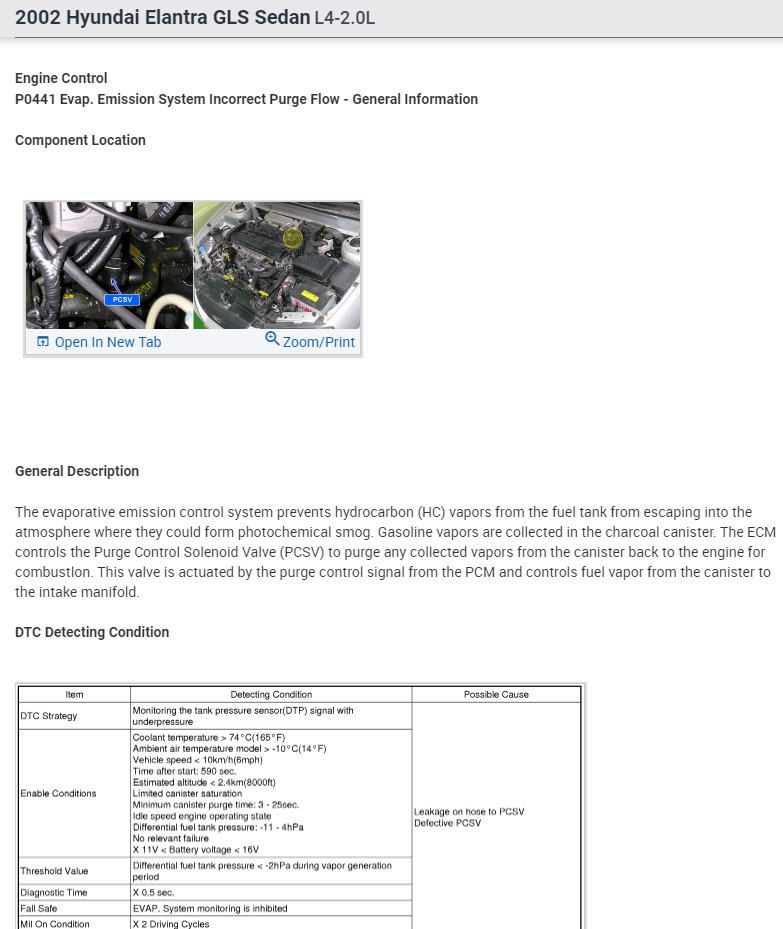

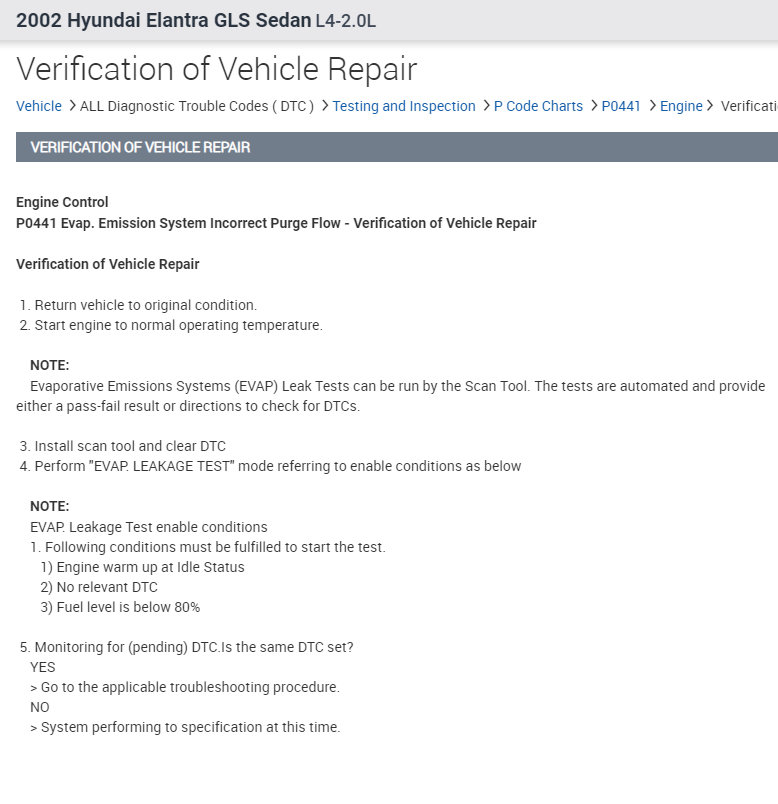

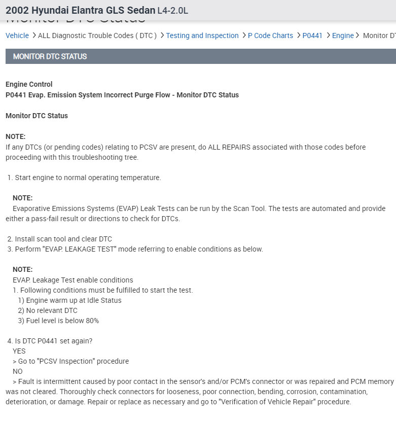

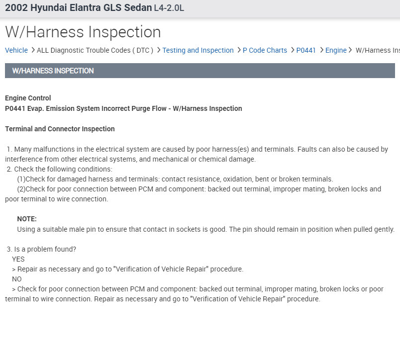

The code P0441 can get triggered due to a faulty purge control solenoid, leak on the hose that goes to the solenoid, it can also be due to wiring issue.
I have attached the troubleshooting guide for the code below for your reference.
Follow that guide as it can help you determine the issue.
Let me know of any questions.
