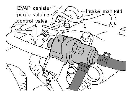

My car listed above GXE 1.6 automatic transmission started to get both P0446 and P0440 codes a few months ago. I bought a new gas tank filler cap and the P0446 code went away. I am getting only P0440 code every month now. I know the new cap is holding vacuum because when I unscrew it, air hisses in to fill the vacuum. What could be causing P0440 and how to fix it?

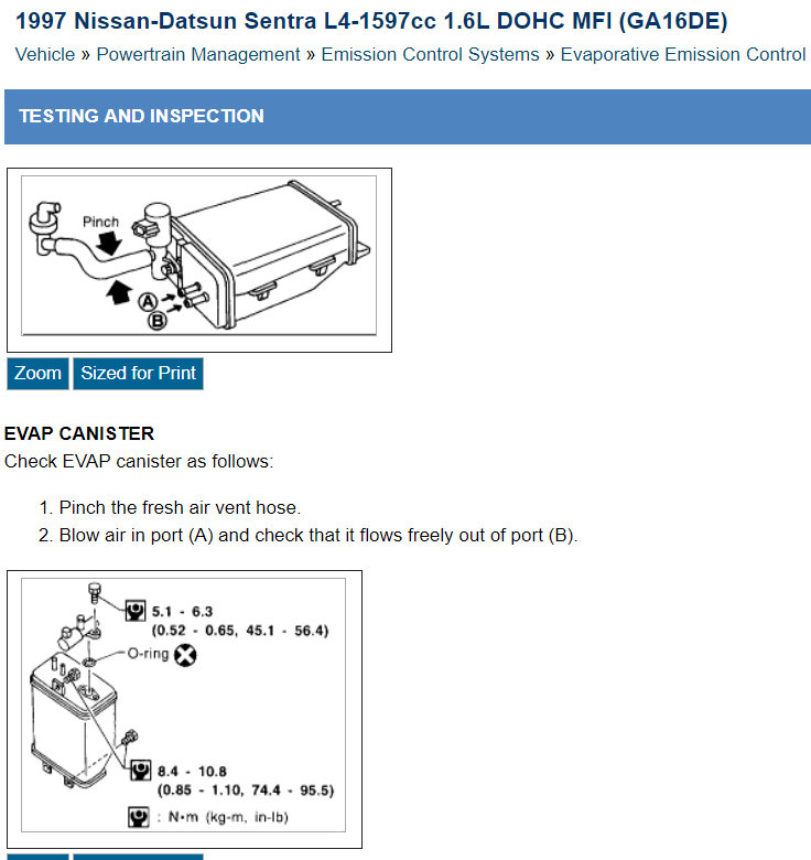

Thanks for your reply. I could not figure out the location of the EVAP canister from the diagram. Can you please post an actual photo?
Is this something that a technically inclined car owner can do?
Before changing the canister, should I check the hoses or smoke test it?
Thanks again.
May 8, 2018 at 7:19 PM
  • 54,837 POSTS
The code indicates there is a large leak int he EVAP system so I would start with a smoke test. I have seen the charcoal canister cause this issue which is back near the rear of the car.
