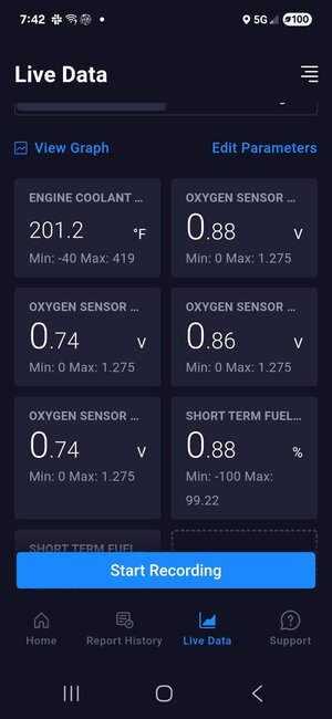

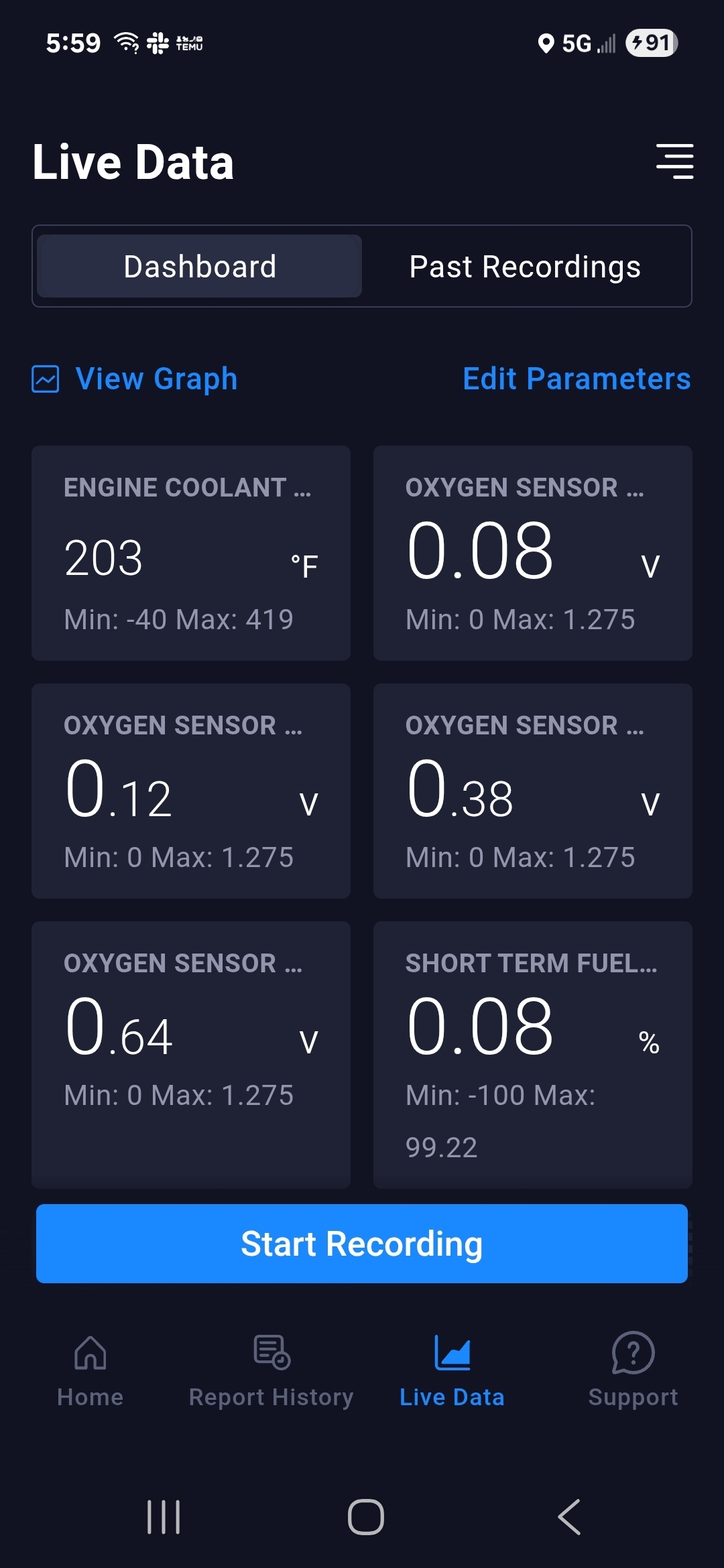

Have dtc codes p0431/p0421. Put new "cat" and new 02 sensors. Cleared codes. Car drove fine before and after new parts were put on. Codes returned after a day of new parts were put on. What else could be the problem? What other test can i do to solve the codes?

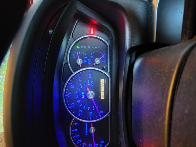

Strange that is has bank 2 on a 4 cylinder since there is only bank 1, hmm anyway I would check the engine cooling system thermostat, does the car have a engine temperature gauge, and if so does it stay on the cold side for a long time? This can mean the engine is not warming up fast enough and it will give you these codes.

Picture of scanner readings. Before and after pics of fuel gauge.

MATTSTORMS42
  • 26 POSTS
Temp took from 4:21pm to 4:43 to reach mid point of temp gauge on dash
Nov 11, 2025 at 6:40 AM
  • 55,433 POSTS
Yep, way to long, it should be at operating temperature with in 5-7 minutes, I would install a new thermostat and then clear the codes. Can you just tell, (type) me the codes?

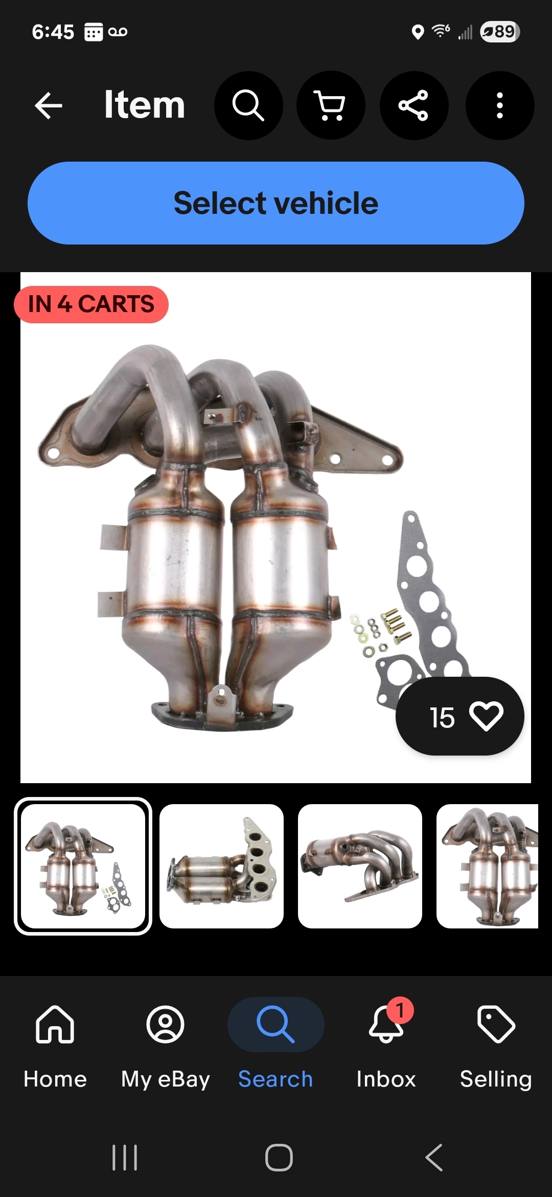

MATTSTORMS42
  • 26 POSTS
Picture of catalytic converter
Nov 17, 2025 at 6:48 AM
  • 55,433 POSTS
It is so strange that you have bank 2 on a four cylinder, some generic scan tools will label downstream sensors as "Bank 2" or assign “Bank 2” codes to rear/secondary oxygen sensors. If so if you had these codes before the cat swap and you still have them I would say the PCM is bad. I would remove it and send it out for testing.
