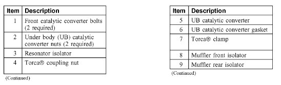

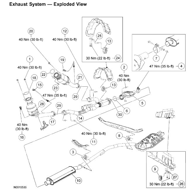

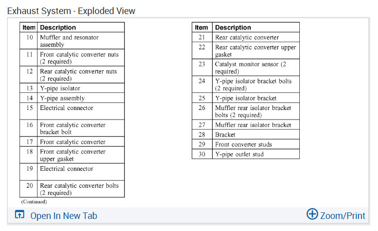

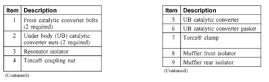

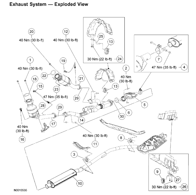

Catalytic system efficiency below threshold, can I get a diagram listing the bank 1 and 2 location. Can’t remember off the top of my head.
Nov 12, 2024 at 3:33 AM
Experienced Mechanic
55,594 POSTS
Sure, here is the bank1 and bank2 catalytic converter locations. Check out the images (below). Let us know if you need anything else.
Images (Click to enlarge)
