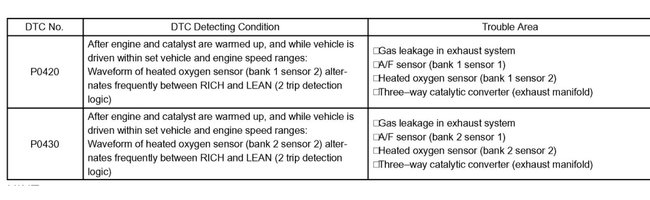

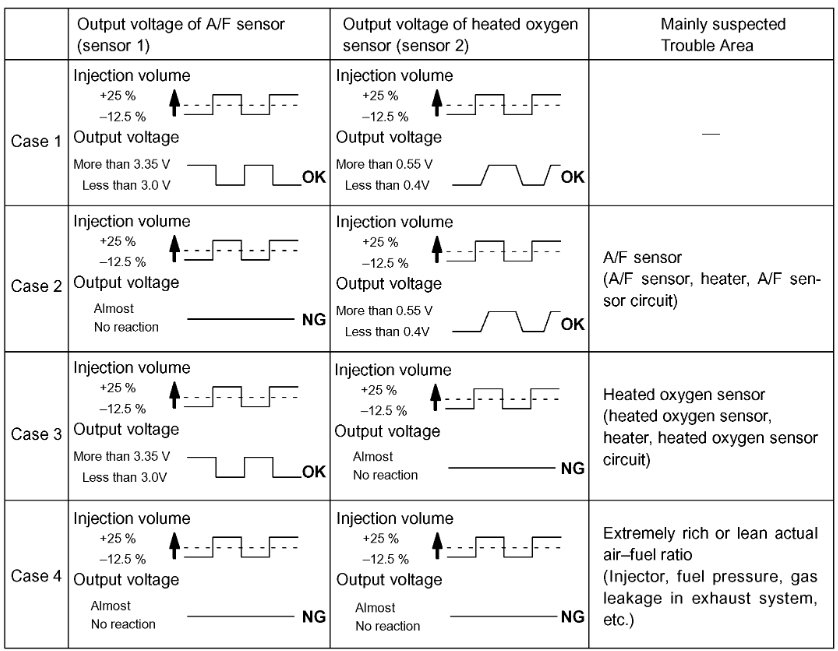

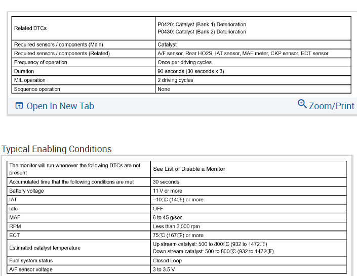

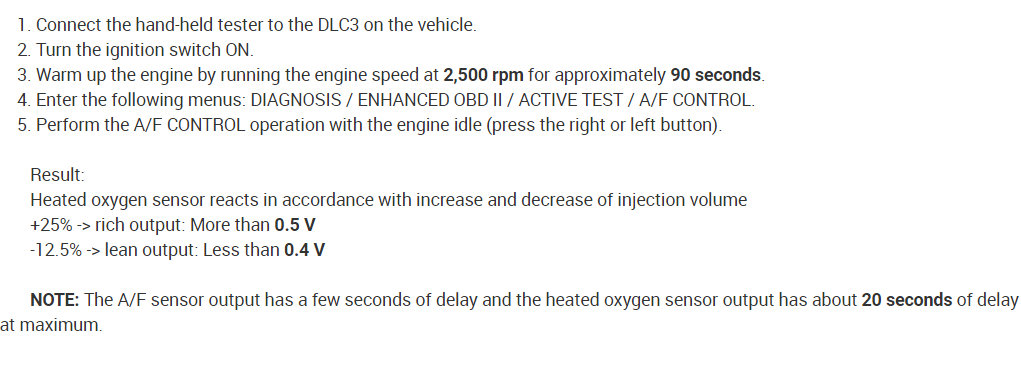

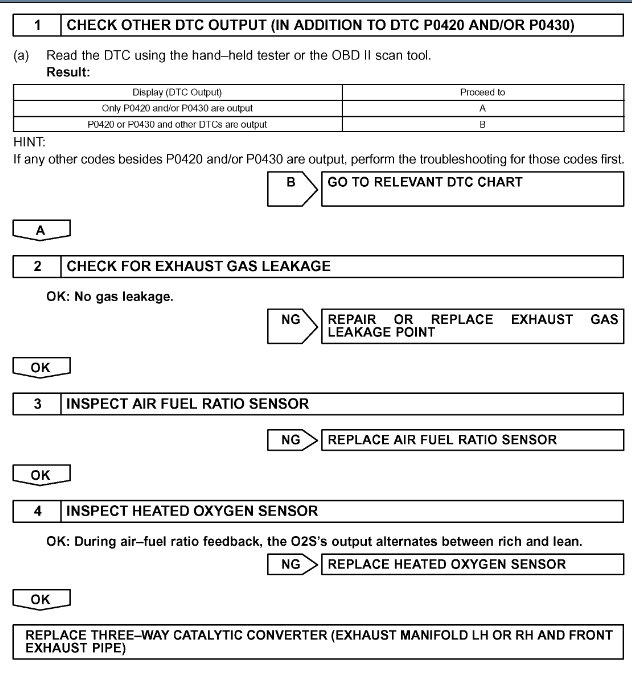

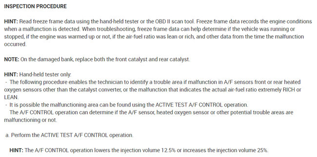

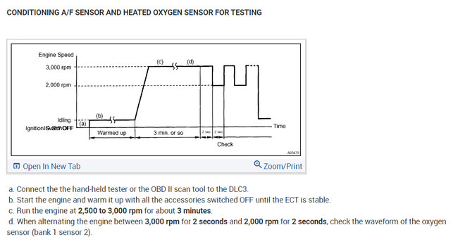

I've attached picture diagnostics steps below for your vehicle. Hope this helps and thanks for using 2CarPros.
Nov 29, 2020 at 4:57 AM

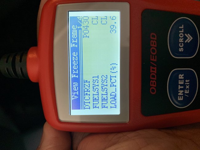

JITHIN MATHEW
  • 71 POSTS

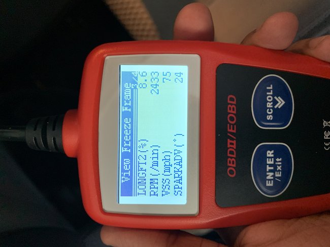

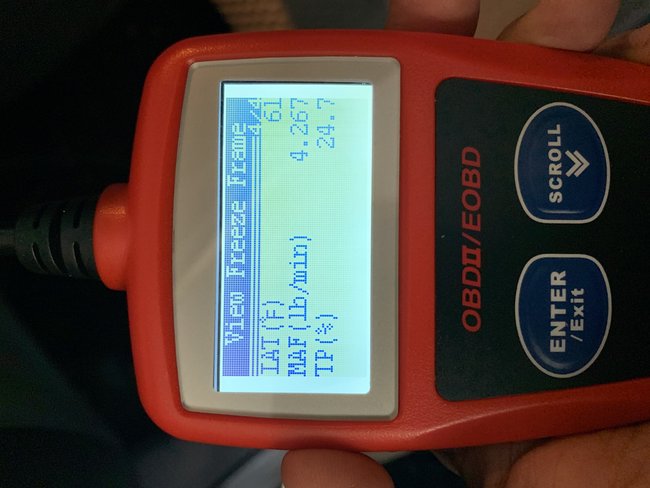

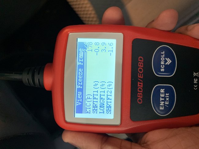

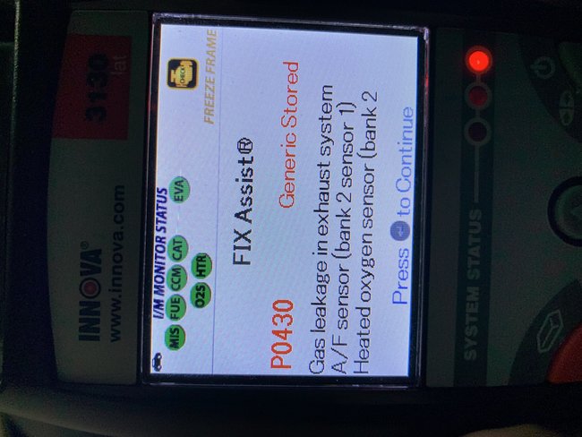

Hello Steve thanks for the reply, I looked at the wiring and it seems okay. I’m assuming the sensor itself is bad because all of them are original to the car with more 210,000 miles on it. I actually scanned the car today and took a picture of the code. The scanner is telling me that bank 2 sensor 1 is bad even though it was performing as it should. B2S2 is the heated one right?
Jan 11, 2021 at 9:40 AM (Merged)

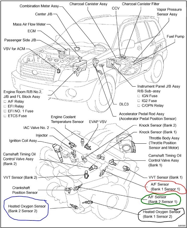

STEVE W.
  • 15,413 POSTS
They asked because Toyota used 4 different part numbers even though there likely is no difference other than wire colors or length. The Bank 2 Sensor 2 is the one in circled in blue.
That is Toyota part # 8946548170 Denso #2344168

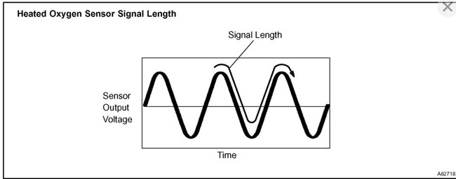

Hello again Steve, so I did replace my 02 sensor and looked at the live data and it’s showing 0 volts only when i'm braking. Just like before it won’t show check engine light until I go on a short trip. Is this normal? I heard of a TSB that Toyota had where they updated the software on the computer and installed a new style catalytic converters. Will I still be able to get that update?
Jan 17, 2021 at 2:04 AM

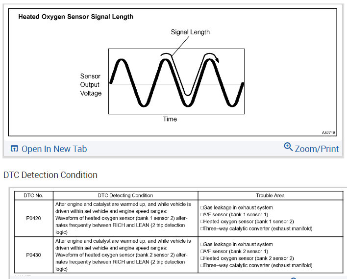

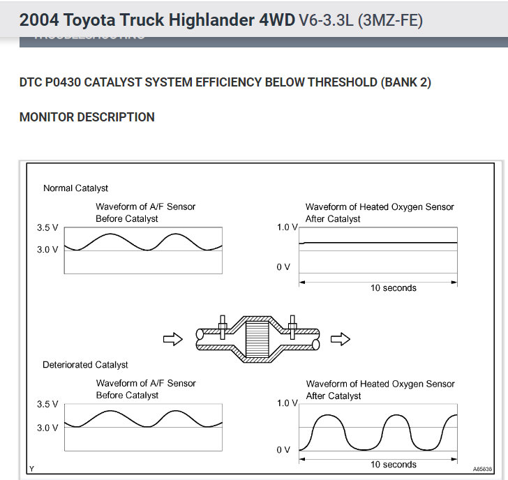

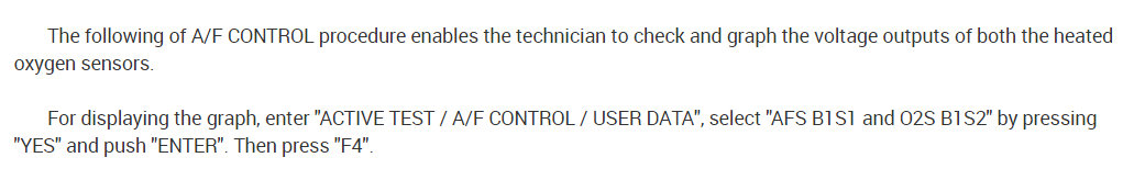

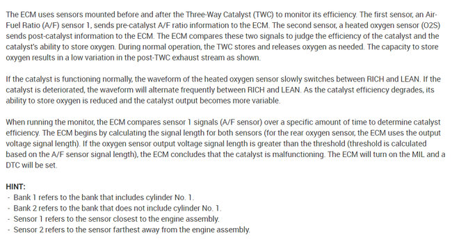

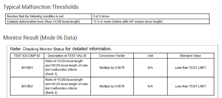

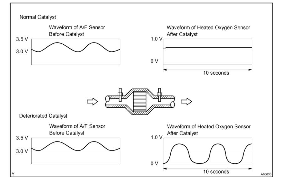

Can you graph the rear O2 sensor? I attached some waveforms for you showing a bad catalytic converter. If the voltage on the rear sensor does not stay steady, the catalytic converter is bad.
Jan 21, 2021 at 6:09 AM
