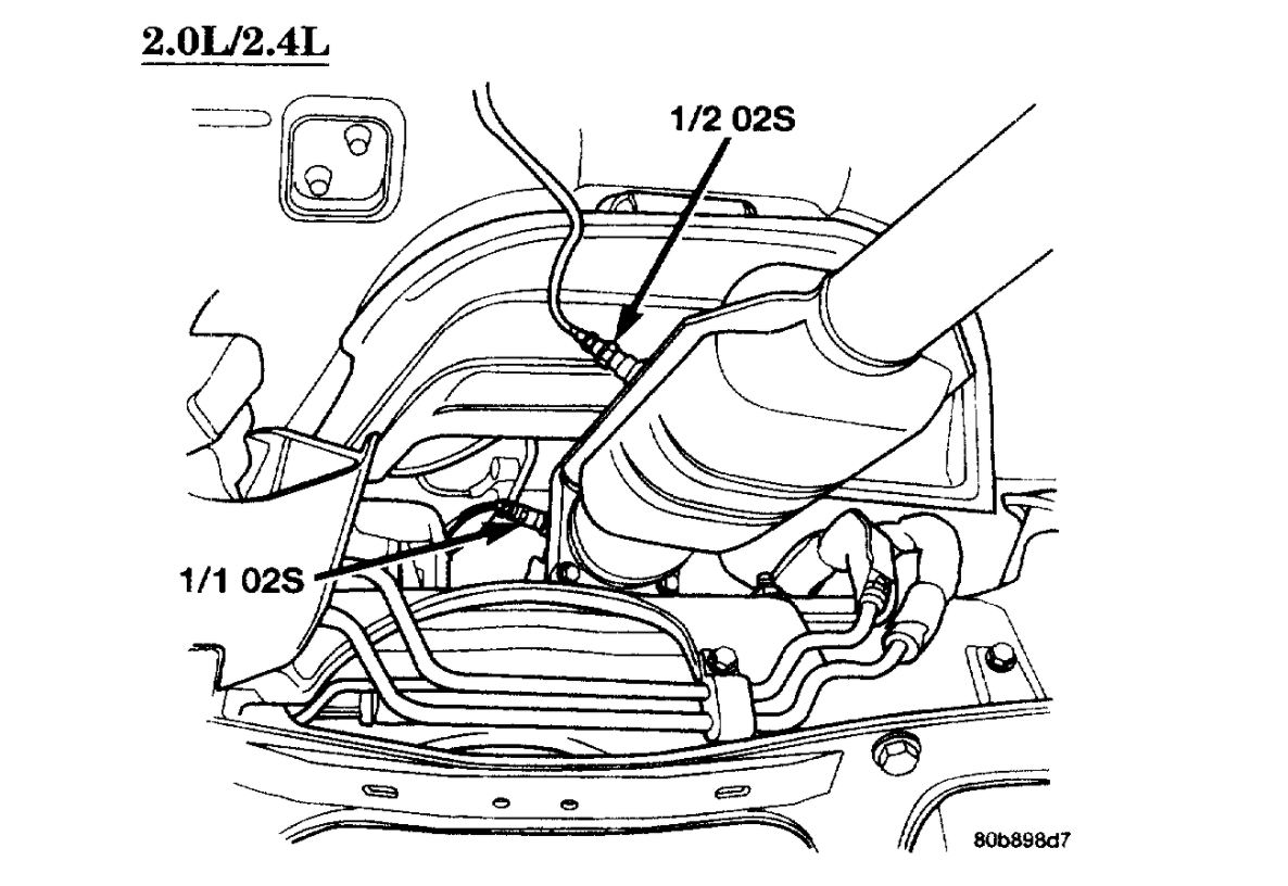

I have already replaced my rear catalytic converter and downstream o2 sensor along with fixed exhaust leaks. MAP sensor and I know I have a valve gasket cover leak but I am still getting a p0421 code.
Apr 30, 2021 at 6:54 AM
Good afternoon,

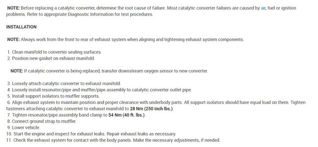

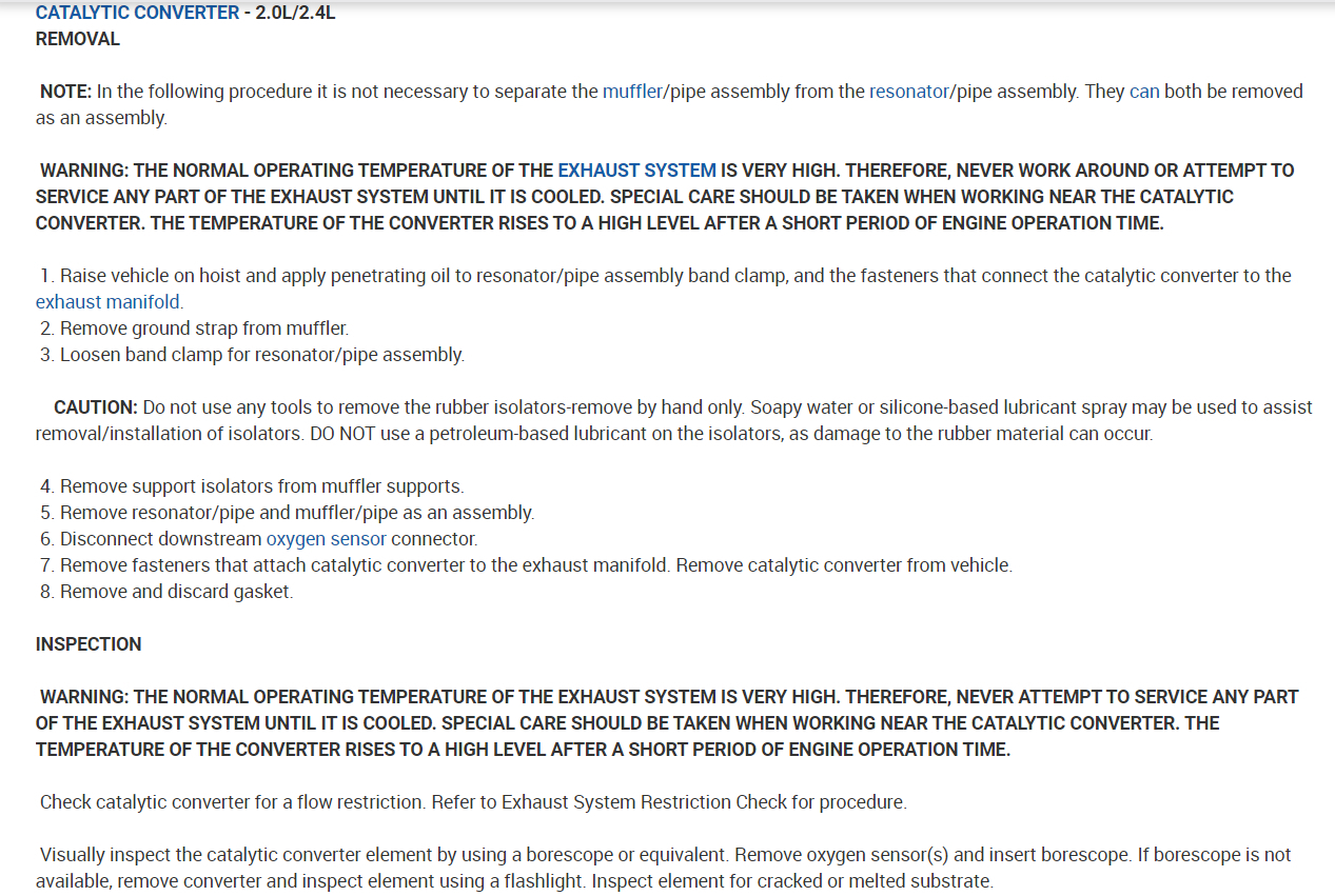

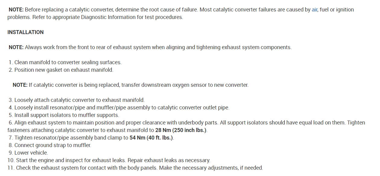

There is no 421 code. There is a 420 which I assume is the code. It is for the front cat converter. When you said you replaced the rear cat, what exactly did you replace?
https://www.2carpros.com/articles/catalytic-converter-replacement

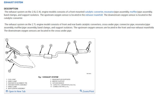

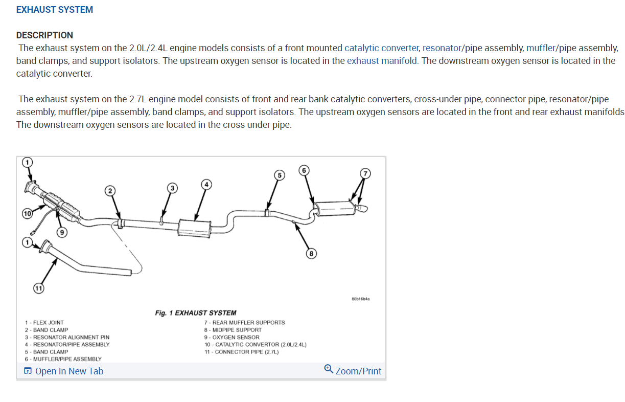

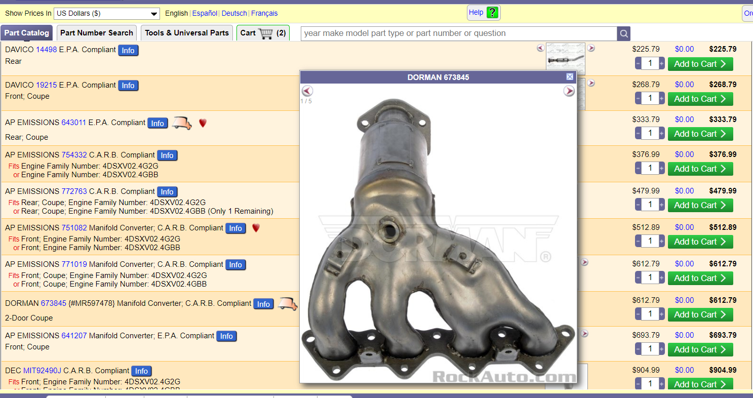

I attached the diagram of the system and also the front or only cat converter for you.

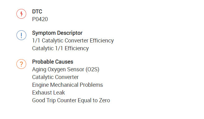

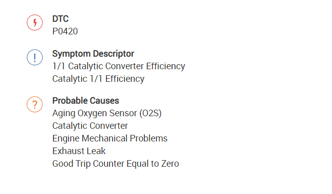

If you have no exhaust leaks, it is the only possible failure. I attached some possibilities for you.

Can you please verify the code? There is no 421 code listed.
Apr 30, 2021 at 1:57 PM
ROBHAYNES84
Code P0421 – Catalytic Converter Oxygen Sensor Below.
Apr 30, 2021 at 2:36 PM
What is the voltage reading on the downstream O2 sensor?
